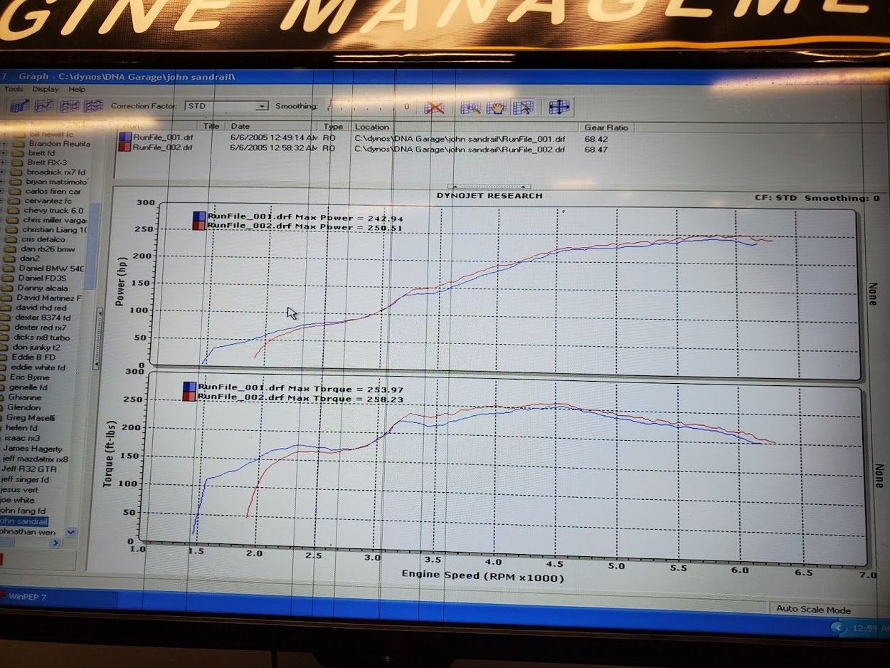

    Today was a very great day after a long year and a half build. The 2TR-FE hit the dyno today and did not disappoint. At the end of the day, we made 250WHP (around 290-300 Crank) and 258 FT LB of Torque out of the little 4 banger.

    I was gonna comment about both curves jumping at 3200, must be the VVT kicking in, but you turned off the VVT. I wonder if the VVT would make any difference with forced induction and only the intake cam being variable...? Anyway, I love to see NA 4-cylinders being pumped up with some thought and planning put into the build. Thanks for a great first post.

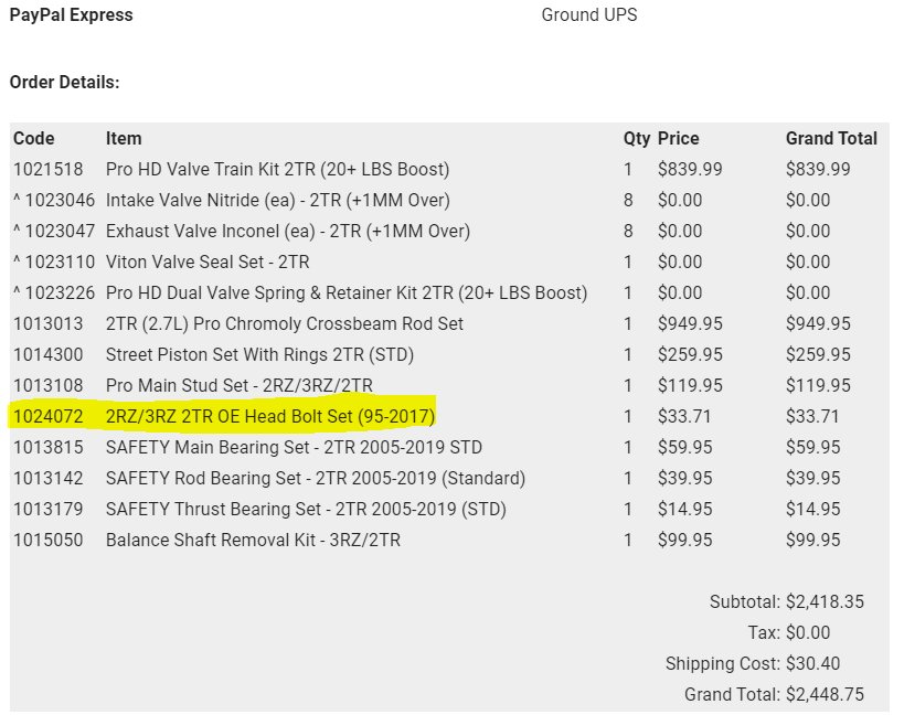

    I just purchased the items needed from LCE. I will be doing the work myself over the next few weeks.
    I just noticed that ARP DOES make head studs for the 2TR, so I will be swapping Those out.
