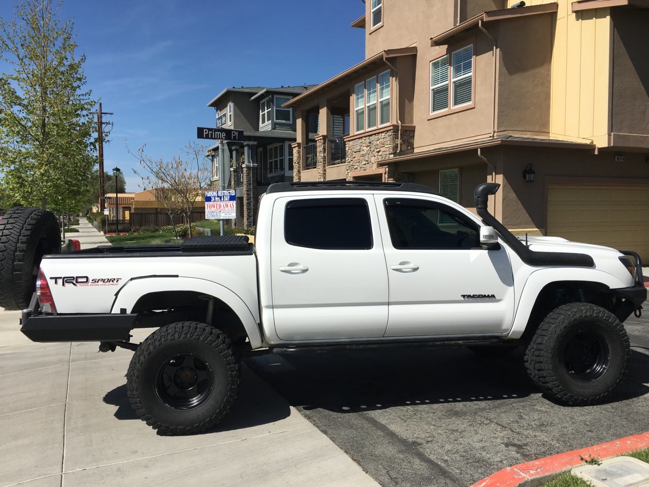

    Just trimmed my front and rears also, cut some tabs into the metal fenders and folded them over to keep the fender lining. Very happy with the outcome, looks almost factory.

    You guys using a dremmel to keep the lines smooth? Nice work.

    Dremmel for the flares angle grinder w/ cutoff disc for the fenders. Bought a jigsaw to use for both but found it annoying to use, cut the flares with them still mounted to the truck then removed them to do the fenders. Removed 2" on the flares and 2.5" on the fenders.

    Makes sense, flare covers up the carnage I'll make with the grinder :D

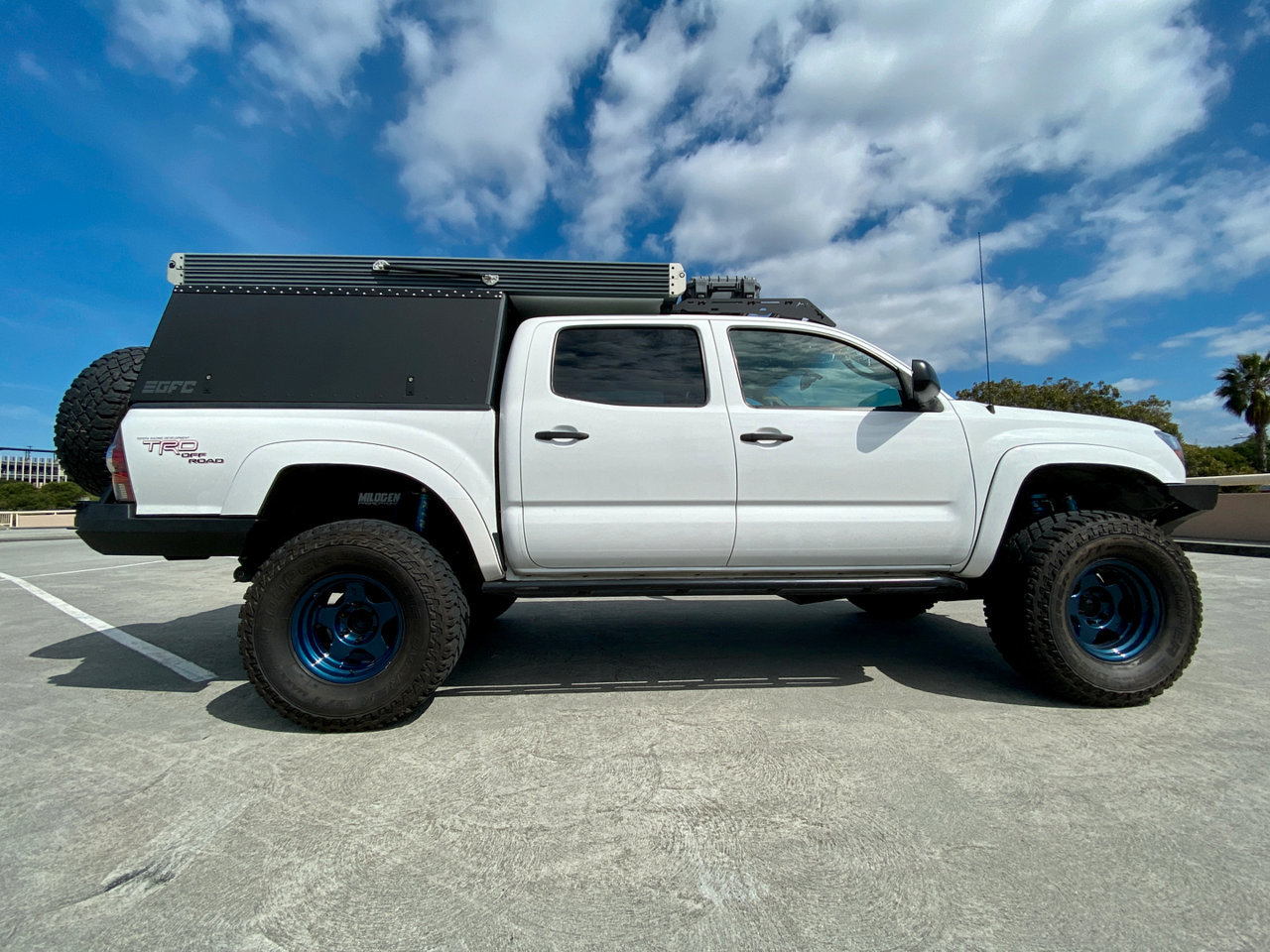

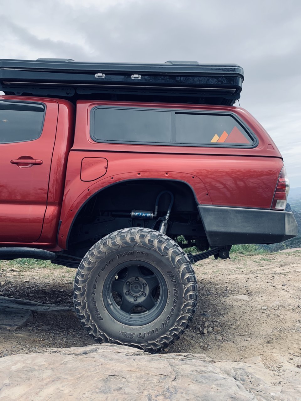

    35s with mid travel
    35s with long travel
    I'm terrible for thinking it at all, but pondering how to fit 37s

    VERY NICE! GFC looks great on 2nd gens

    Right on! Looks great. I did the same with the tabs. Worked well, though I made my own liners as the originals were long gone.
