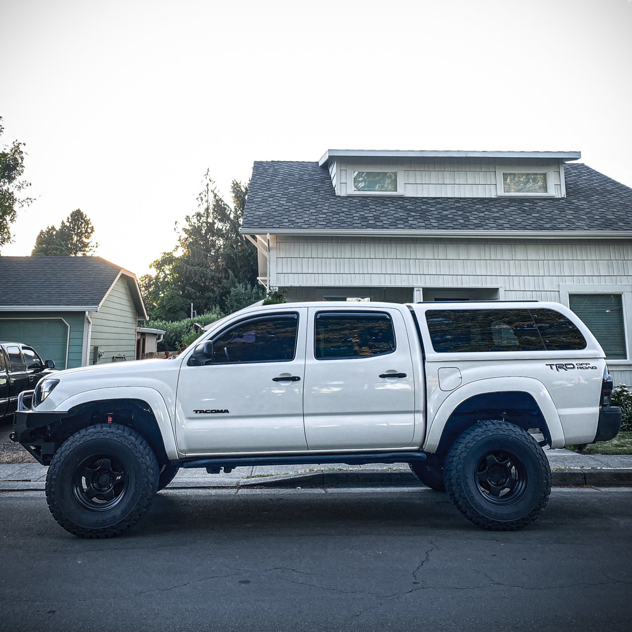

    how much did you end up taking out of your fenders and flares? Yours looks like the perfect amount of trimmed without being overkill. Finally joining team 35’s this week!

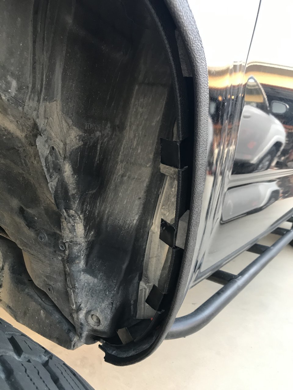

    Any chance you'd be willing to post some pictures of the inside of the wheel well? I'll be honest, I've been in this truck 11 years and I'm kinda ready for 35s. I've been avoiding cutting the fenders/flares for quite some time because I don't think I have a good understanding of how the fender liner would reattach once the mount points are gone. I'm quite skilled with a dremel and a cutoff wheel so that's not the issue. I really just need some guidance before I tear into it and cut something I should have left! :D

    I took about 2” off the flares and 2.25” off metal fenders. I wanted the front flares to line up perfectly with my bumper, so that’s what I went with. I’m very happy with how it turned out.

    Perfect, I think I’ll be doing the same today

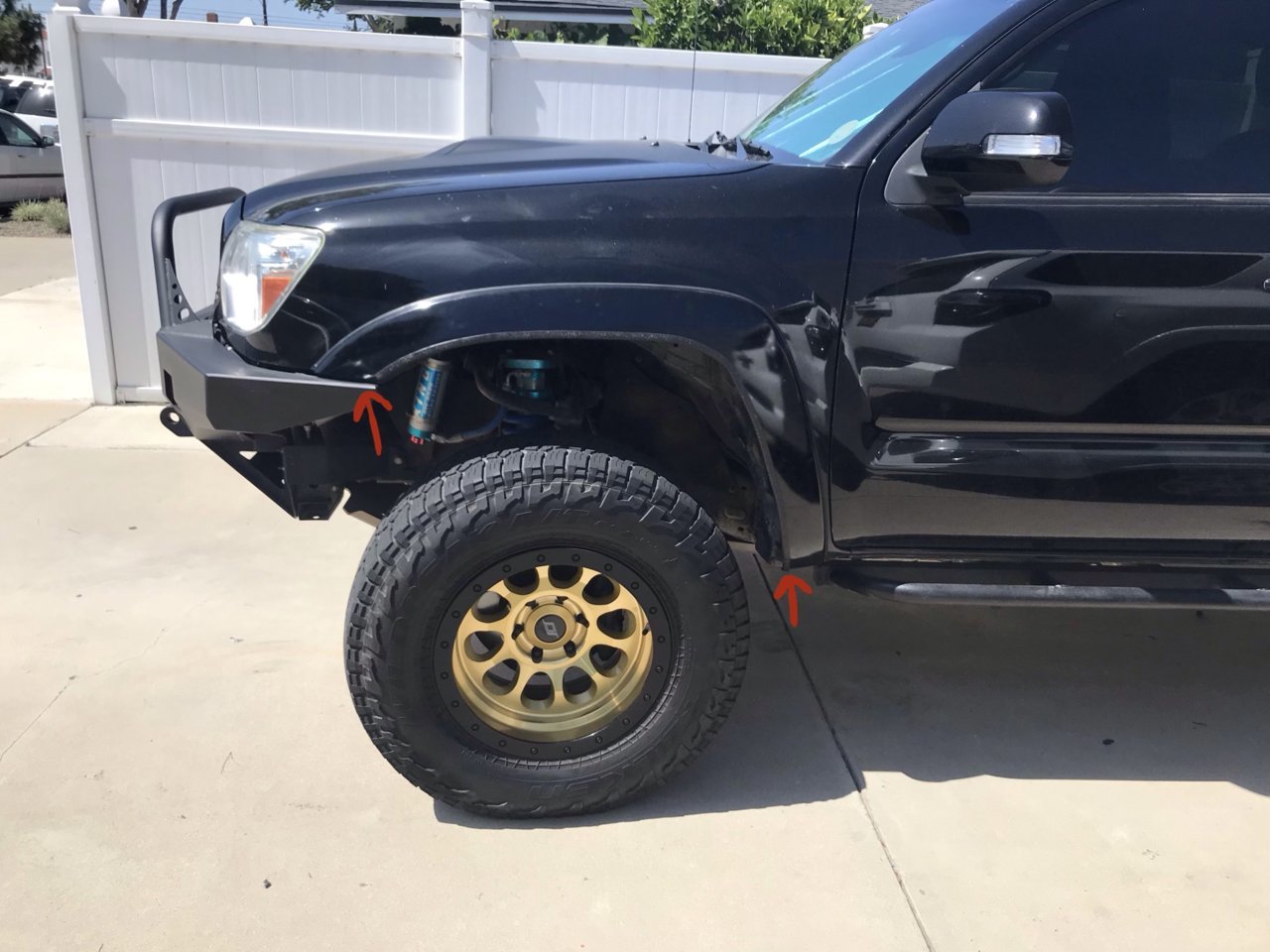

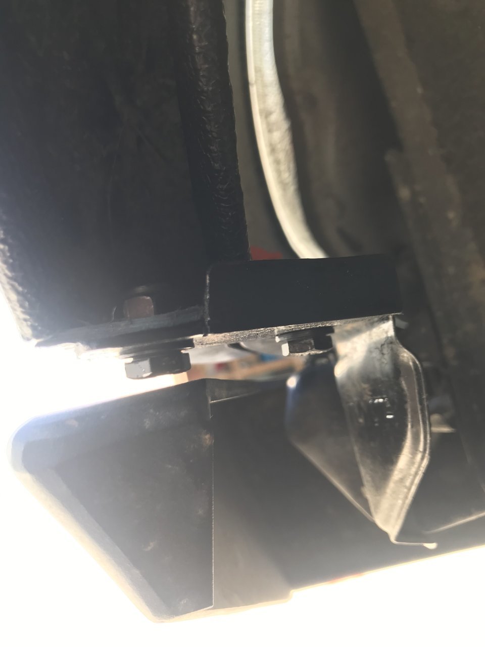

    Question for the technique you guys have used for liners. I cut my fronts a few weeks back and left tabs.
    I also made a little aluminum bracket for the front red arrow to connect the flare to the fender and used a bolt at the rear red arrow. Should keep the flares on and support the clips
    my questions is what process are you guys using the fit the DIY liners. Drill a hole in the tab, mock cardboard? Drill and pray? Try and mark with blue tape? I could keep going, but trying to pick some brains.
    35s are next, but want to get my liners out of the way.

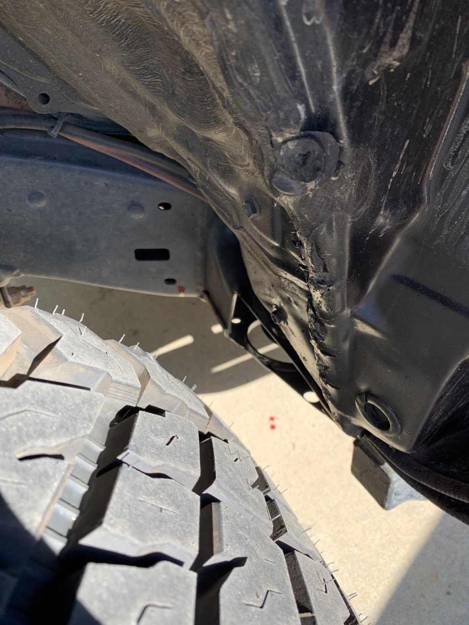

    CFDDFAA0-B1E7-4B02-8DFF-91C31F5592CF.jpg 090D9796-18A9-4F0A-A59F-31A77E6923EB.jpg Joined the 315/70r17 club couple weeks ago. Trimmed fenders and cab mount with old 285s in prep, knowing 315s were in the future.
    I feel like I’ve cut a lot away from the cab mount, hammered the pinch weld and I’m still getting some rubbing at 80-90% lock in reverse. Is there a specific alignment that would help pull the wheel forward just a bit? Any pointers?

    Looking good! Get as much caster as possible when getting your alignment.

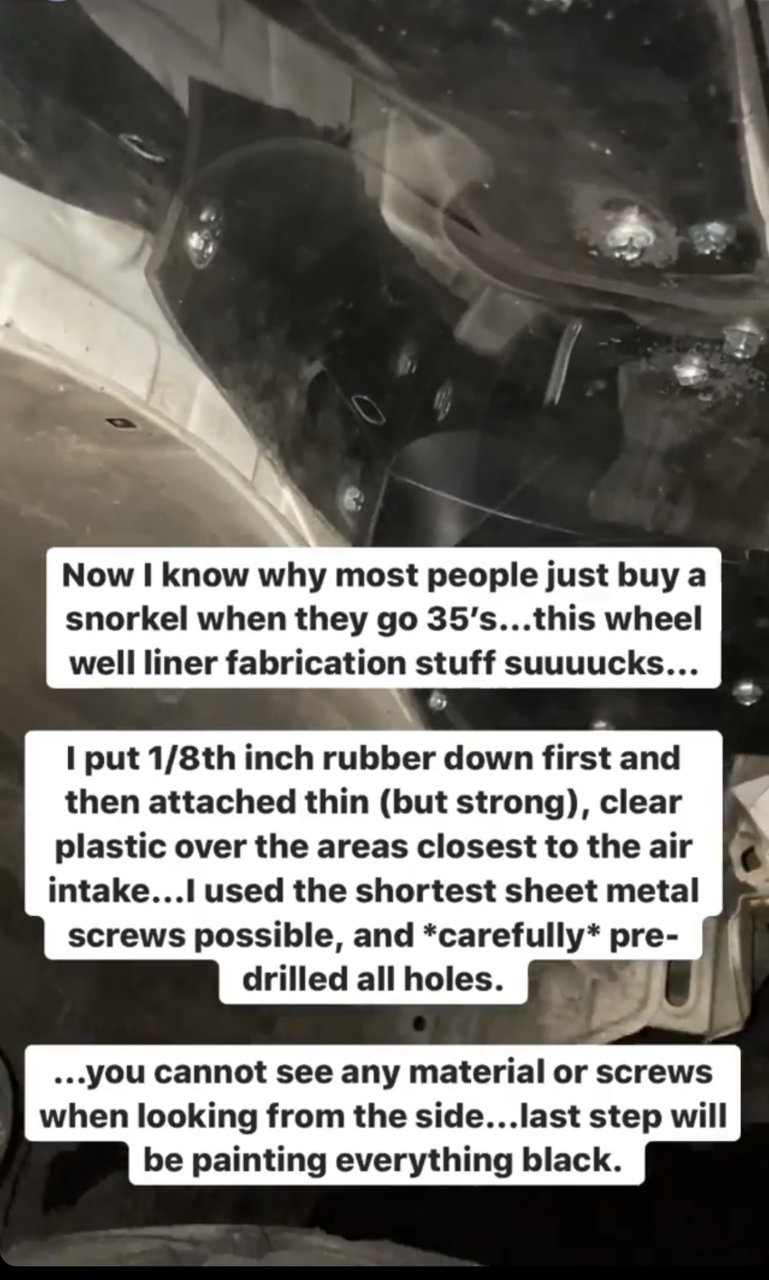

    Looking good, man. I used small self tapping screws to attach liner to fender well/firewall. A little nerve-wracking, but I have no issues. I drilled holes in the tabs, cut thin rubber and plastic sheeting to make liners, and screwed/bolted them on. It's worked great so far. Check the link below:

    Caster as far forward as possible. What uca’s lca’s are you running?

    this photo was before rear was trimmed but finished up last night!B7C5A0B2-9F40-4636-804E-A20256635706.jpg

    Damn that looks clean. Nice job!

    Stock LCAs. All-Poo uniball ucas. Got an appointment at an off-road shop next week. They’re good with aftermarket lifted Toyota’s and caster so fingers crossed.
    I think right now they’re 3.4/3.2 from a shit firestone alignment months ago.

    I have a bit over 5degrees caster and no rub.

    Seems to be a popular trend. The 3 was good for 285s and the ‘best’ Firestone wanted to do. They advised me it was “too much” and they would only go to ‘OE’ specs.

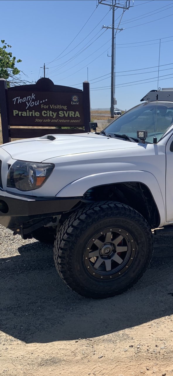

    No fender flares because I kept ripping them off on the rocks (yes they were trimmed)

    How much did you have trimmed From your flares?

    A couple inches. About 2.25" in the front and about 1.5" in the back. I was wheeling my truck pretty hard last year.
