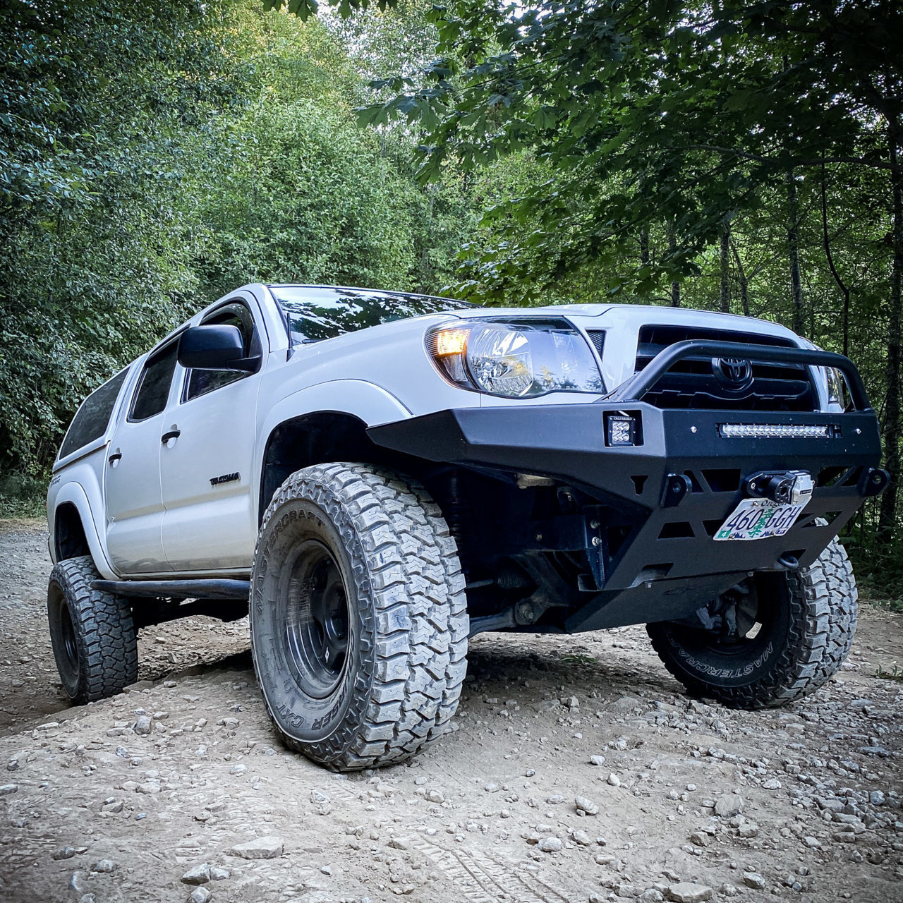

  17. Aug 21, 2020 at 7:46 AM
    #337
    TrailYeti
    TrailYeti [OP] Well-Known Member
    Jul 4, 2018
    #258358
    808
    Portland, Oregon
    05 TRD OR on SCS F5’s & 315/75r16’s
    Fun times in Oregon.
