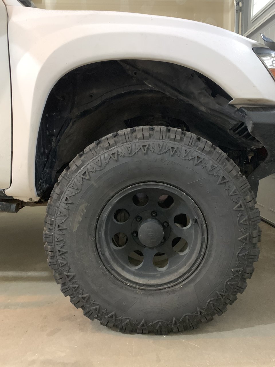

    2.5" lift w/35's
    315/70/r17 Ironman MT

    Right on. How do you like those tires?

    Best cheap tires I've had. I had some other brand like cooper or something before these and they chunked up and made a lot more noise than thse ones. Got a set of 4 Ironman tires for like $700 mounted and balanced out the door. Couldn't be happier for that price.

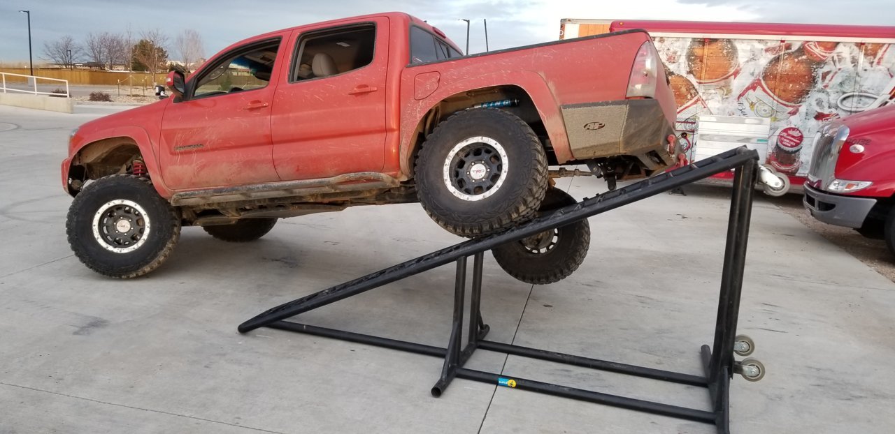

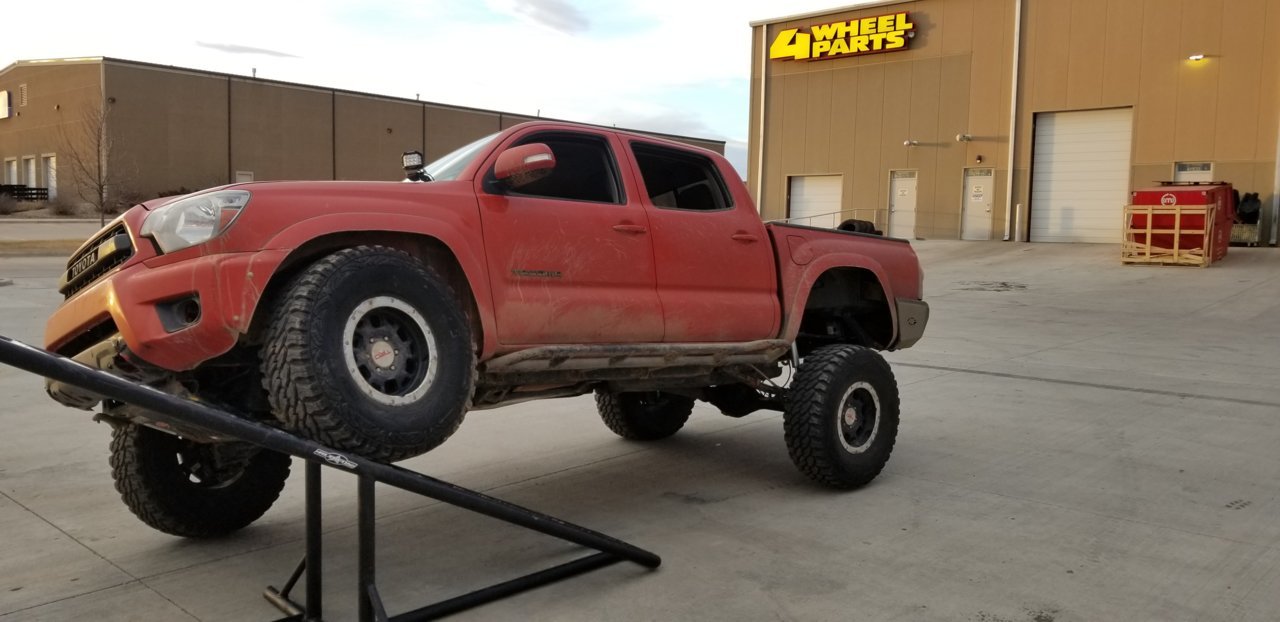

    Just got the fronts trimmed yesterday, gotta fit liners the game on...

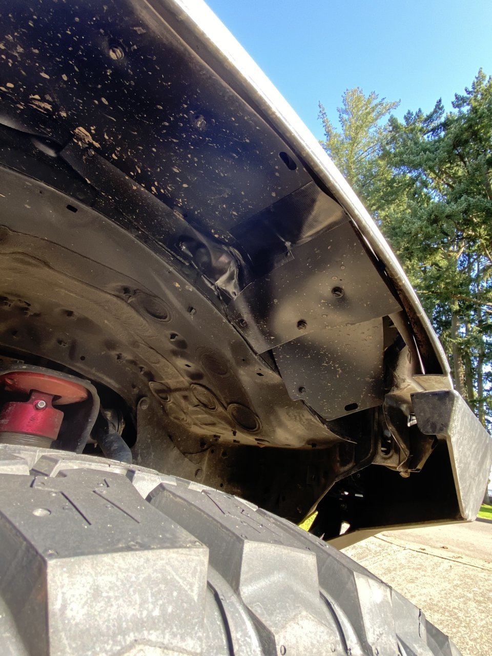

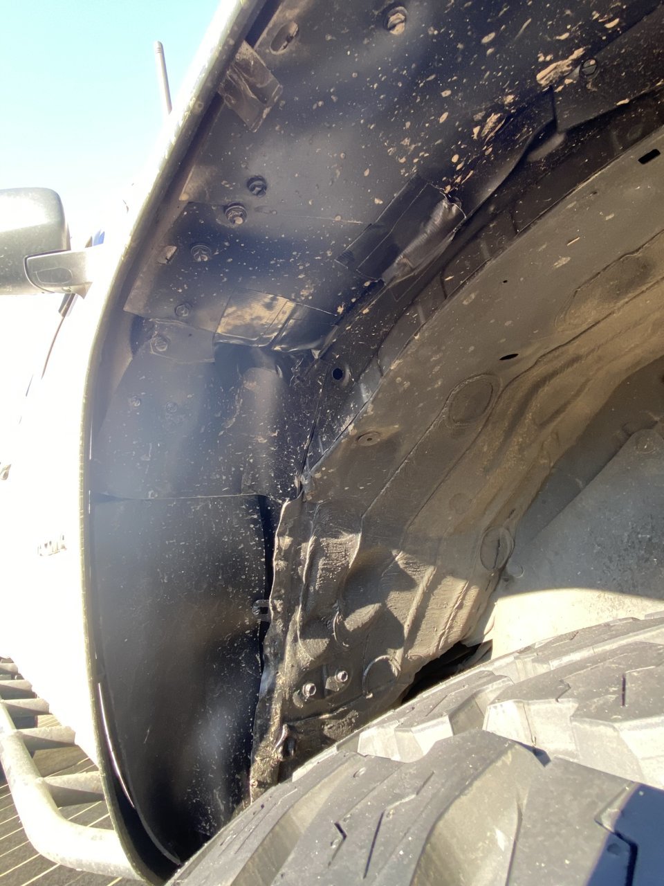

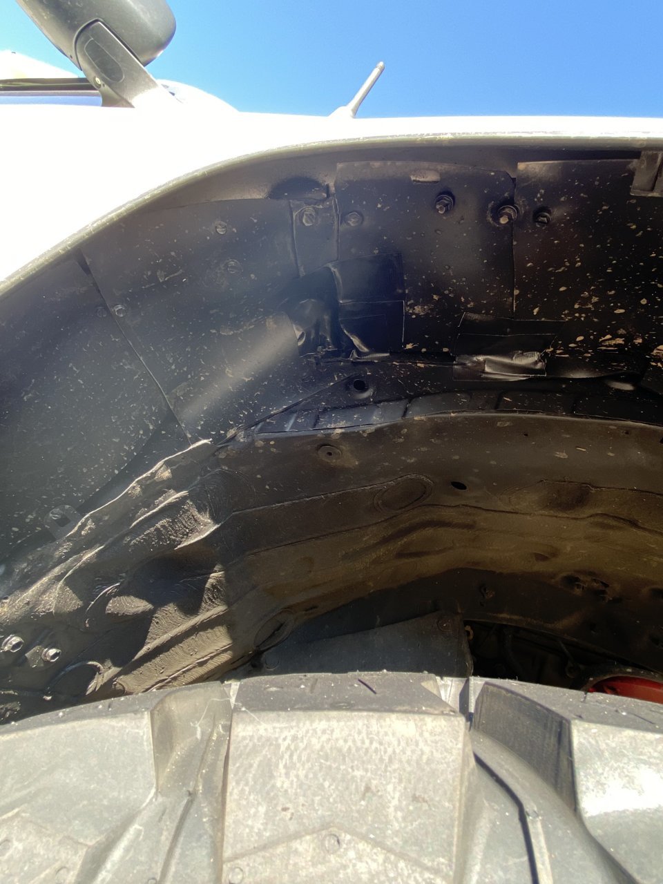

    Nice work. I just finished installing liners on the passenger side to protect intake. I cut tabs in the sheet metal like you. Was a pain in the ass to rig up liners that look clean and that you can’t see from the outside, but I’m happy with how it turned out.
    I used 1/8th inch rubber, some thin plastic material and gorilla permanent tape to seal up some seams...then painted everything black.

    Very nice sir....Gotta get my liners on this weekend. Luckily I'm on 63's out back with 14" ADS...

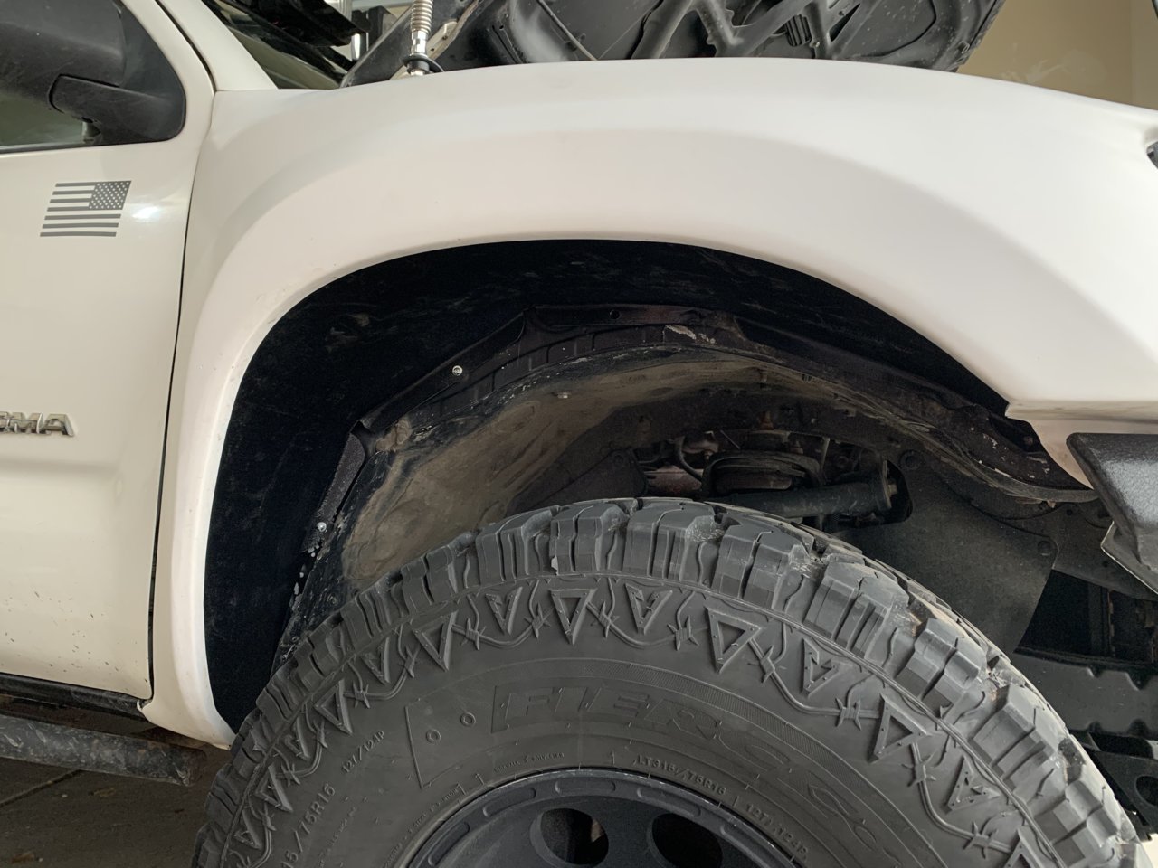

    That’s better than what I did first go around. I zip tied a sock (actual sock that goes on your feet:anonymous:) to the inlet and then zip tied part of the old fender liner back in.
    While it did work I won’t be doing that again lol. Eventually the sock got caked in mud and dirt and affected performance of the motor. Good news is that the only stuff that made it through was the super fine dirt that the filter could then handle.
    I have since upgraded from that atrocity.
