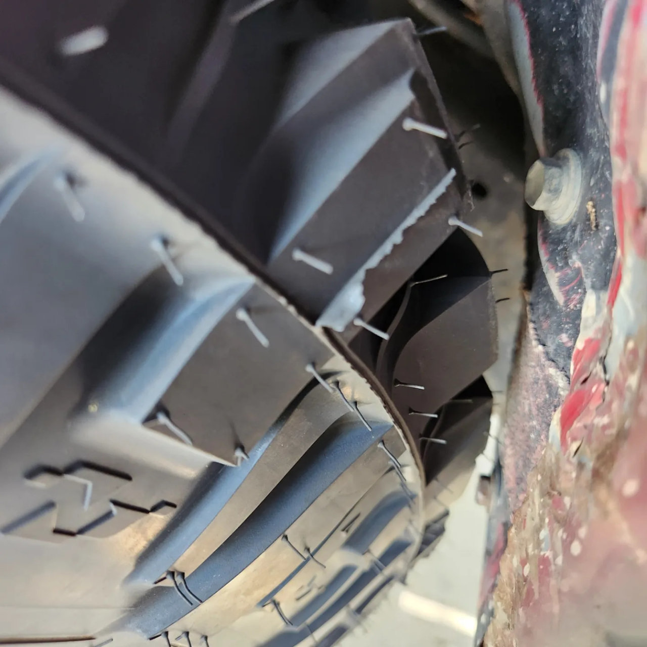

    Definitely going to rub. I'm running 35x11.5 and at full lock and going over an inclinded driveway I got very slight rubbing. So definitely 12.5 will rub. I'm running 17x9 -12 and I believe your set up with the wheel spacer put the outside of the tire half an inch out further. Also have cab mount relocate. Before is before and after some work with a 10lbs sledgehammer. Picture without mud was the clearing I did to fit 295s. Another picture of what mine looks like from the side.

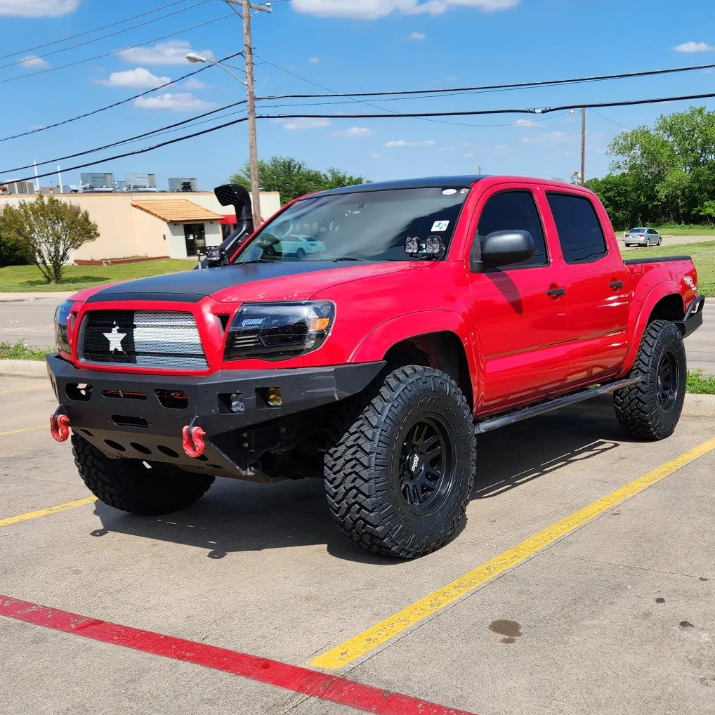

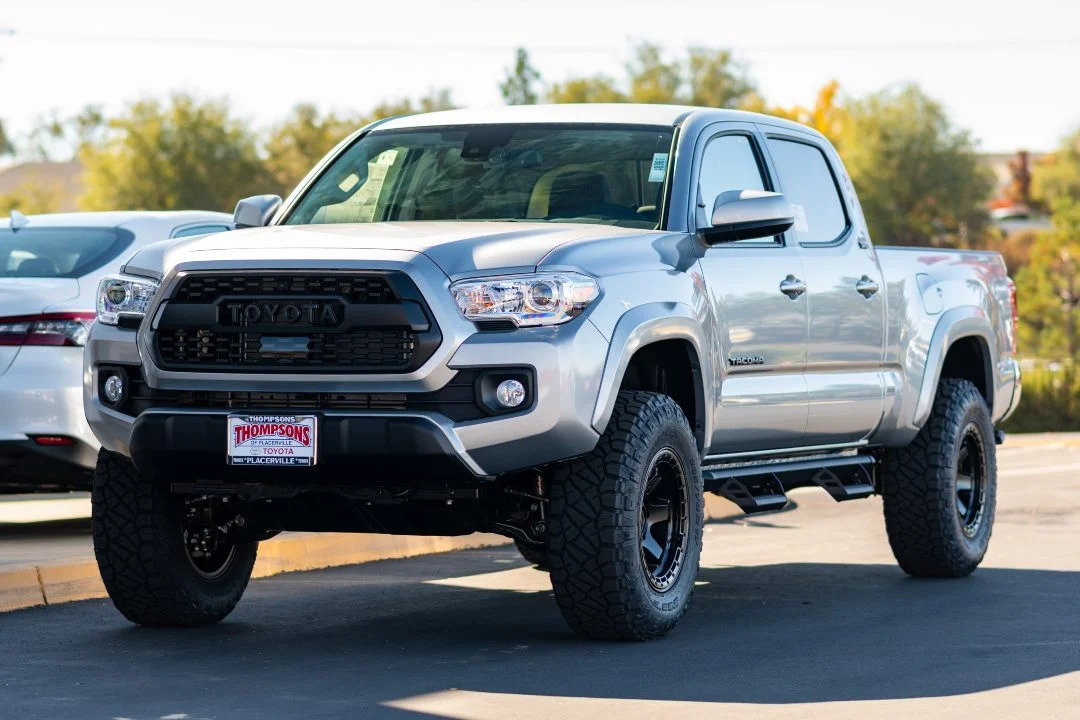

    Man I really want these tires! They are C range too. Can you post some pictures showing how skinny they are? Similar to this angle...

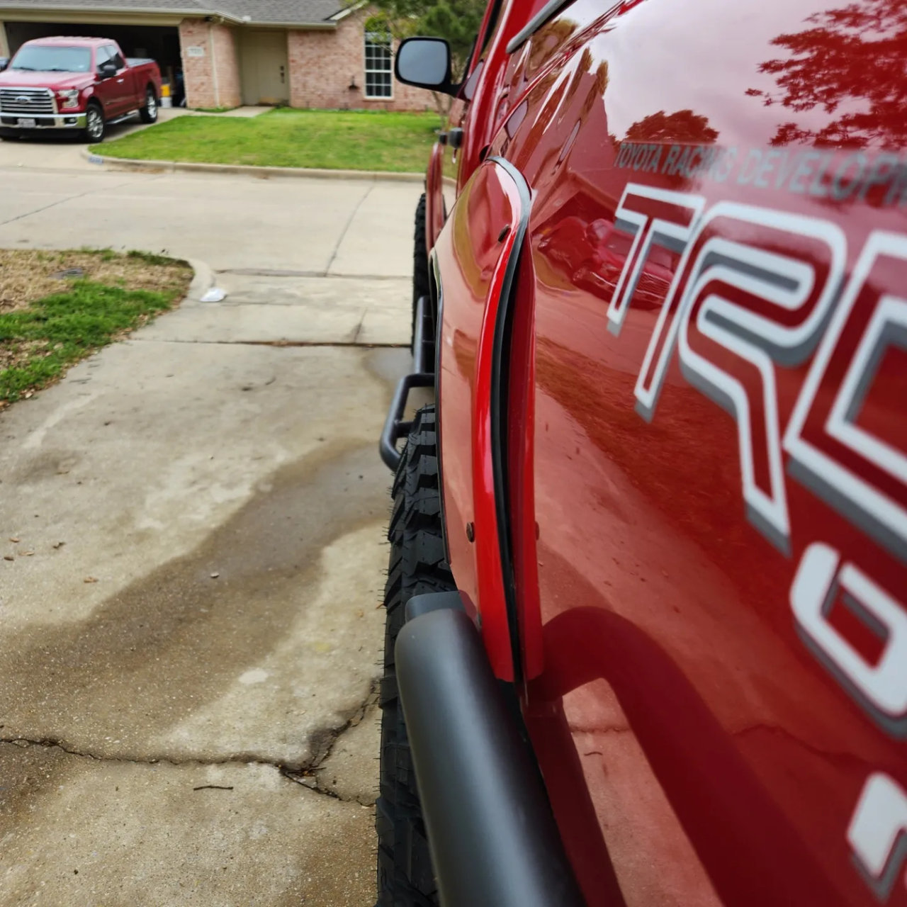

    2008 Red Tacoma TRD Off Road
    Brute Force Fab front bumper Dobinsons Snorkel 35" Nittos Bilstein 5100s ICON leaf springs RSI SmartCap Bed Replacement Diode Dynamics lighting Custom built morimoto headlights RCI full skid

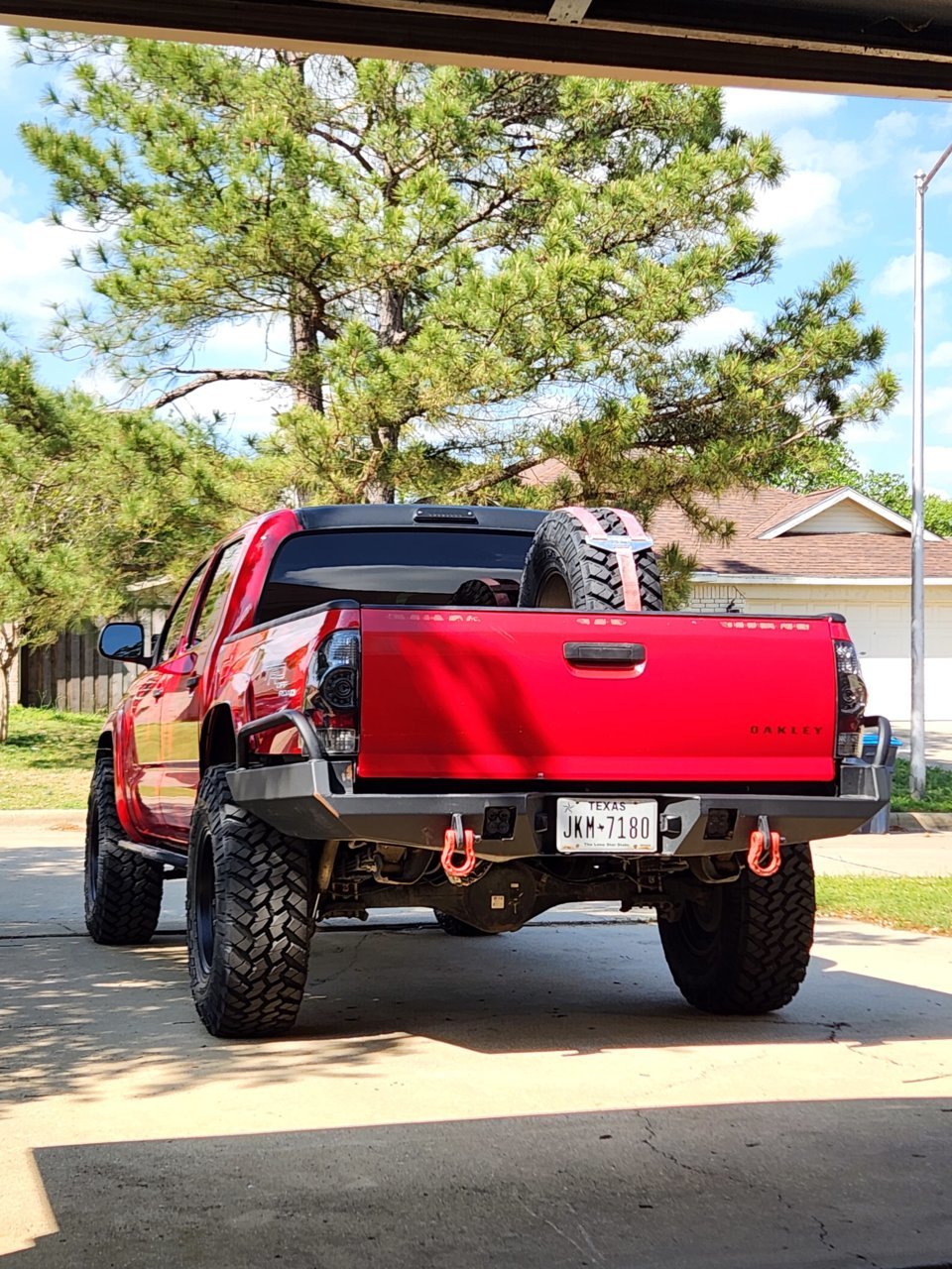

    Best two angles I got. One from the front and one back.

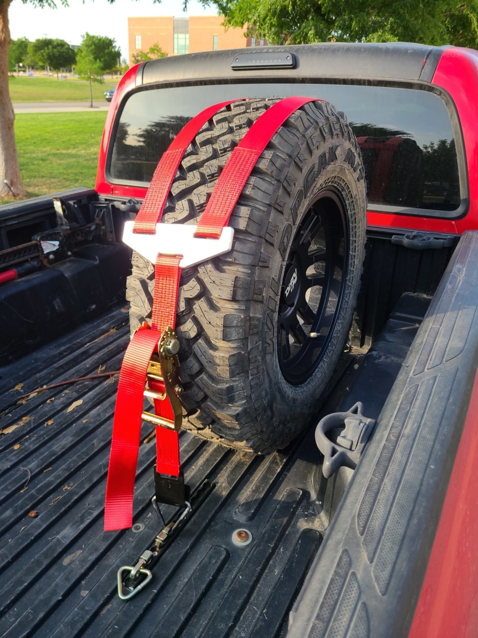

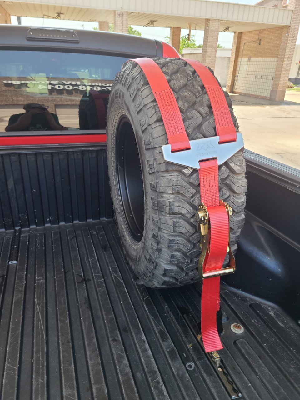

    Do you have pics of that tire carrier. Or a link. Thanks.

    Thats perfect, thanks!

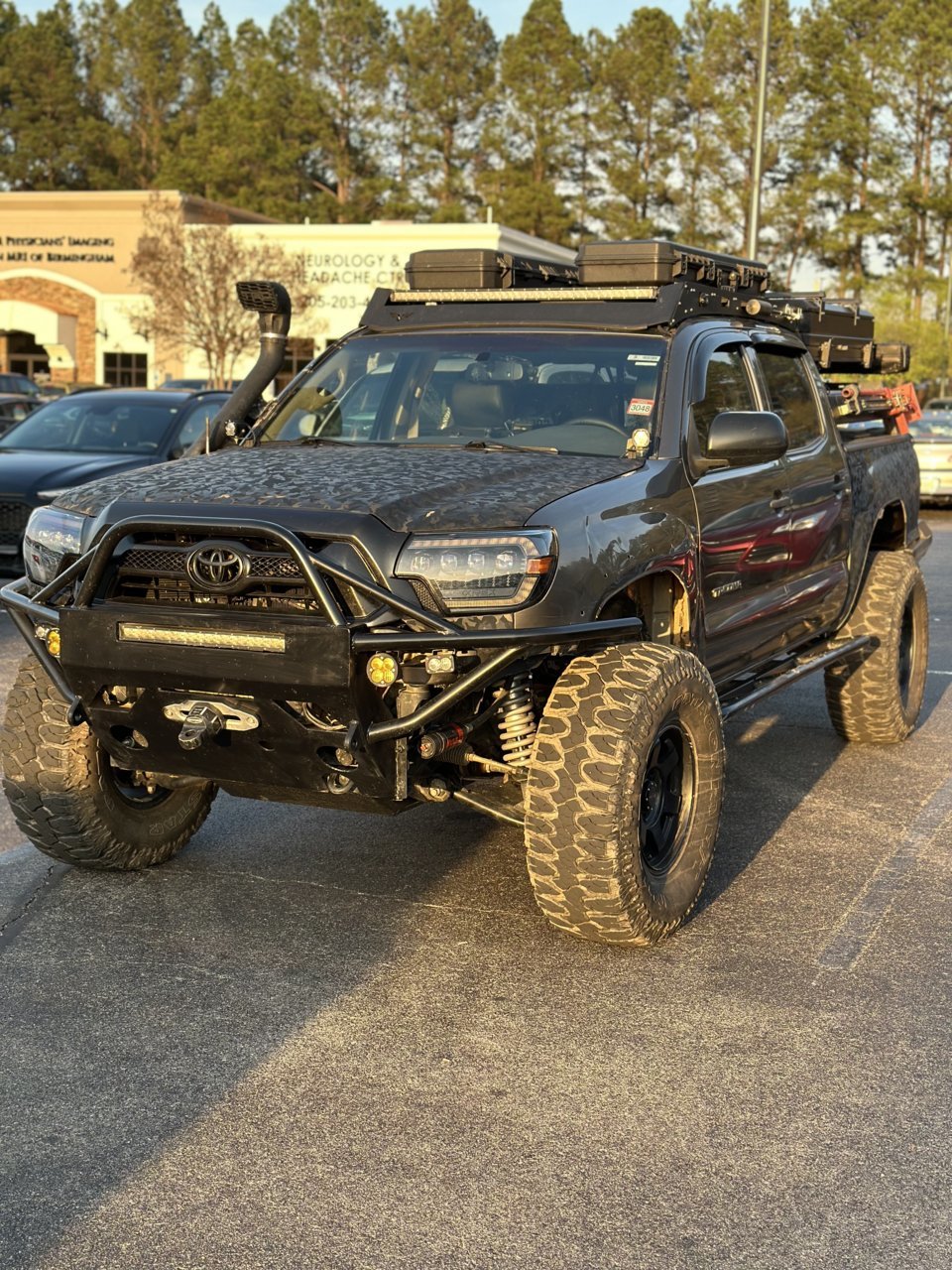

    2012 DBCSB F/R Locked, 35's ,Long travel, 23 Tundra 4x4 limited
    Not Stock

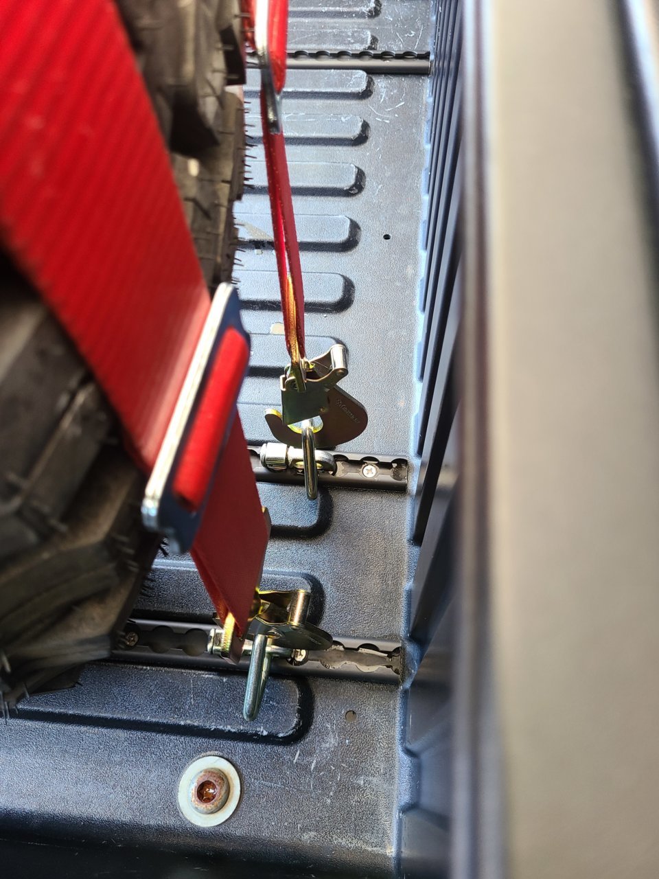

    I just used some L tracks and a macs tire strap. Bolted it through the bed. Used fat washers in the back side to help distribute the load but I would recommend reinforcing the underside with a full plate.

    Much thanks. I overlooked spare location when I went with a bigger tire. Been a thorn ever since. Thanks for the pics.

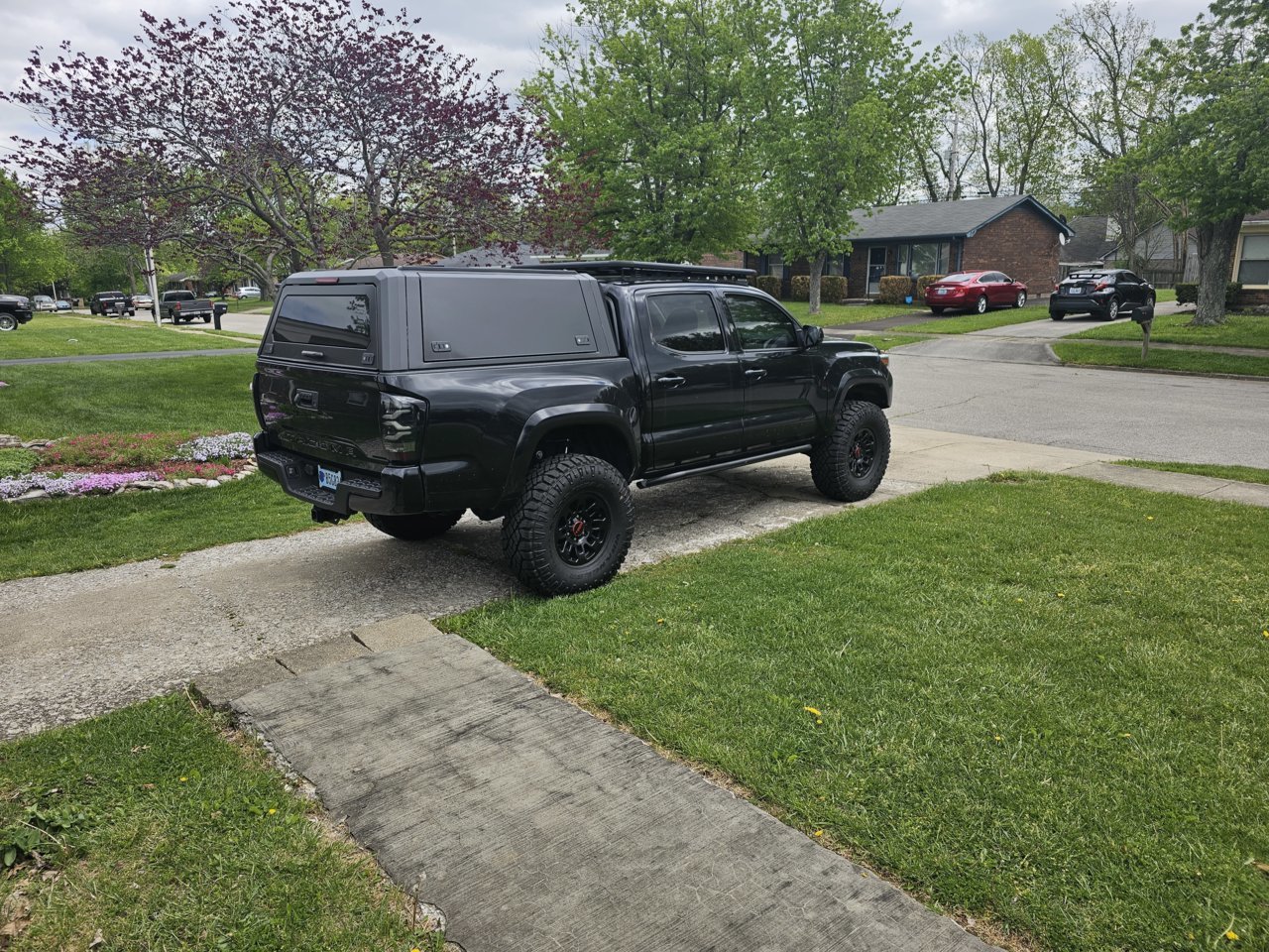

    315 75 16 oem 16x7 trd pro wheels and body mount relocation

    Nice. I’ve been wanting to see 35’s on stock 16x7 wheels. Don’t want to get new wheels but I’d like to bump up to 35’s. Looks like they work great!

    @nglescobar1992 very nice looking rig. Love the wheel and tire package. Midnight edition at its best. Goodyear Duratracs?

    Yes 315 75 16 duratrac made on 2019 found a set of 5 brand new tires for only 1000 dollars
