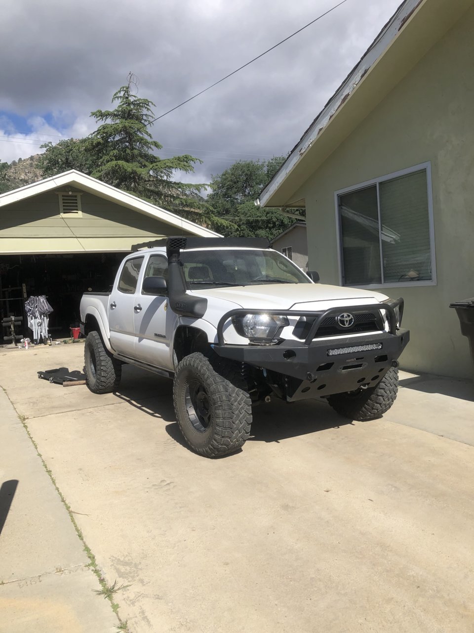

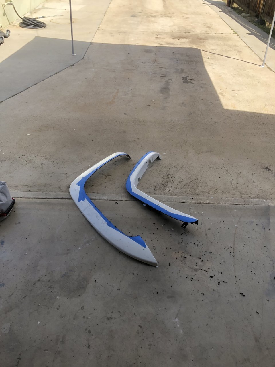

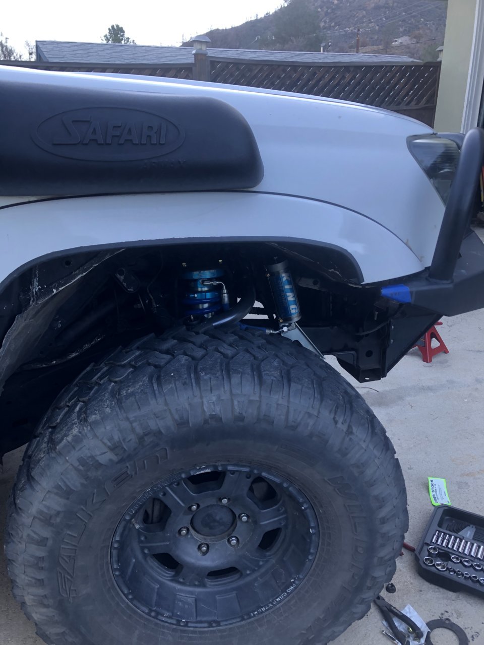

    here are some pics showing the flares, some of the pics are old but the driver side front flare is a work in progress that should be done soonC8F1FDFB-9305-4D99-8EB4-937508DDD880.jpg

    why not cut the front of the front fenders to line up with the bumper ?

    When I first did the cuts I had the Allpro but I knew I wasn’t going to keep it. I still did a full cut to match the back but left some room because I wasn’t sure where the next bumper would sit
    the new bumper lines up better with the flares but might go and cut it later on to be perfect

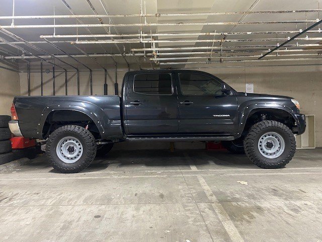

    Fox Racing 2.5 (F); 2.0 (R), Archive Garage Leaf Springs, hanger/shackles, shock relocation, U-Bolt Flip Kit PLM P37 (TE37 Knockoffs) Bronze wheels, Nitto Ridgeline 35s, C4 Overland Bumper, Total Chaos Uppers, Outgear Solution HC Swingout, OTTune 4.88 Nitro Gears

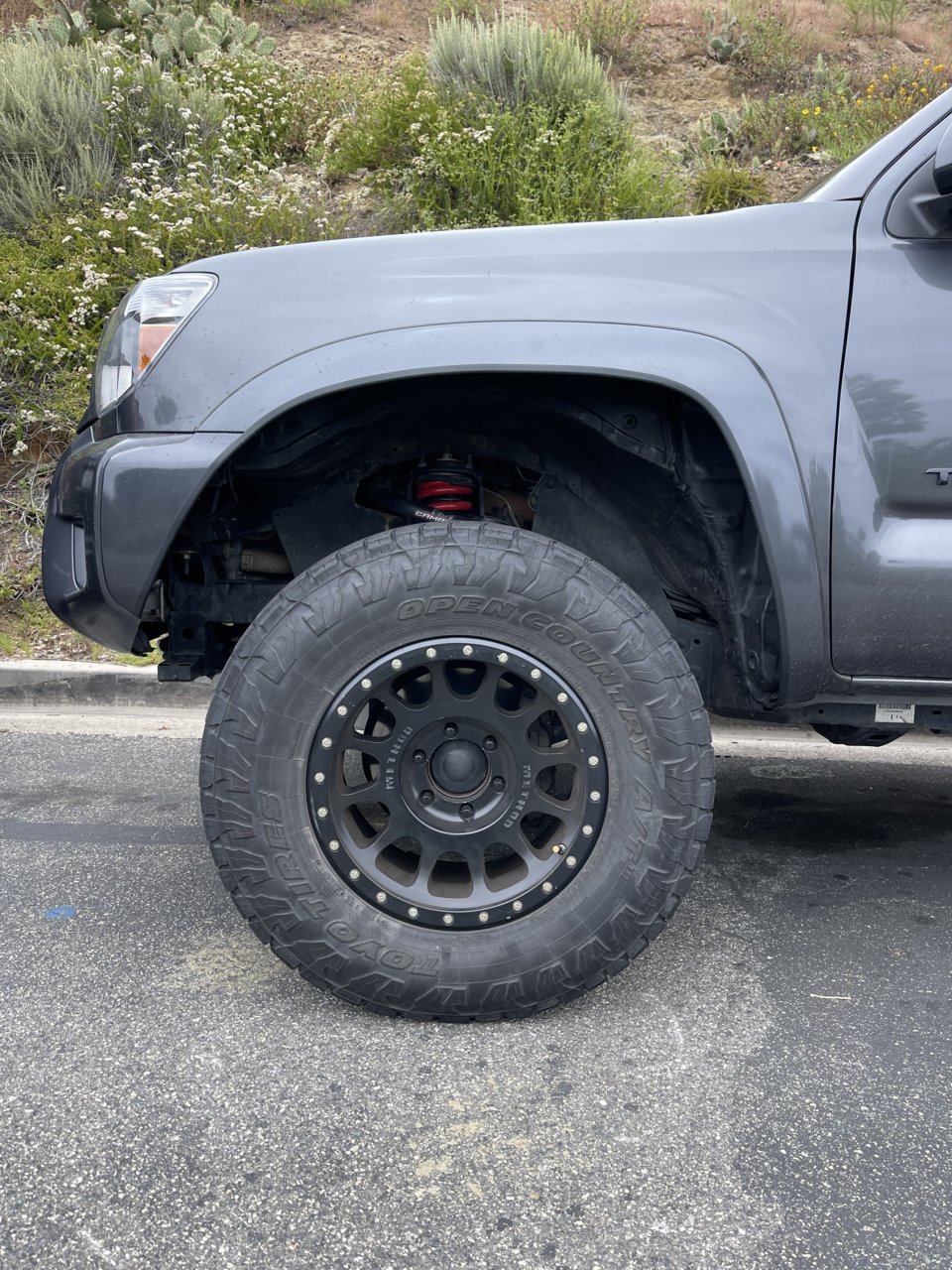

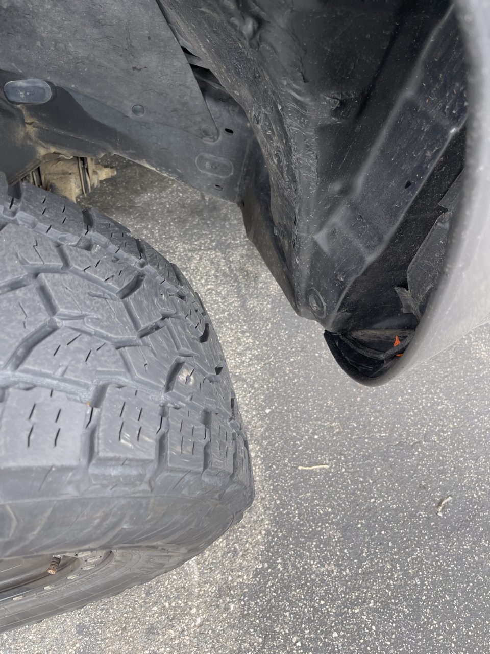

    Hey guys, 2015 here currently running 285/70/17 Toyo AT3s on Methods (0 offset) and want to size up to the 35x11.5, if not 285/75 AT3s.
    Truck is mainly for desert and light trails. No technical 4x4 wheeling.
    Have done CMC, trimmed fenders, and hammered pinch welds.
    On TRD Baja Bilstein and Camburg UCAs at 4.3 caster. No rubbing when I off-road.
    You guys think that’s enough caster to clear 35x11.5 without having to do CMR? Would like to size up as much as possible without cutting again/relocating cab mount.

    had the similar setup on a 2007; 35x11.5 with -10 wheels, didn't rub anywhere in moab.

    17" scs ray 10 with -10mm offset, spc uca, no spacer
    maxxis razr 35x11.50r17
