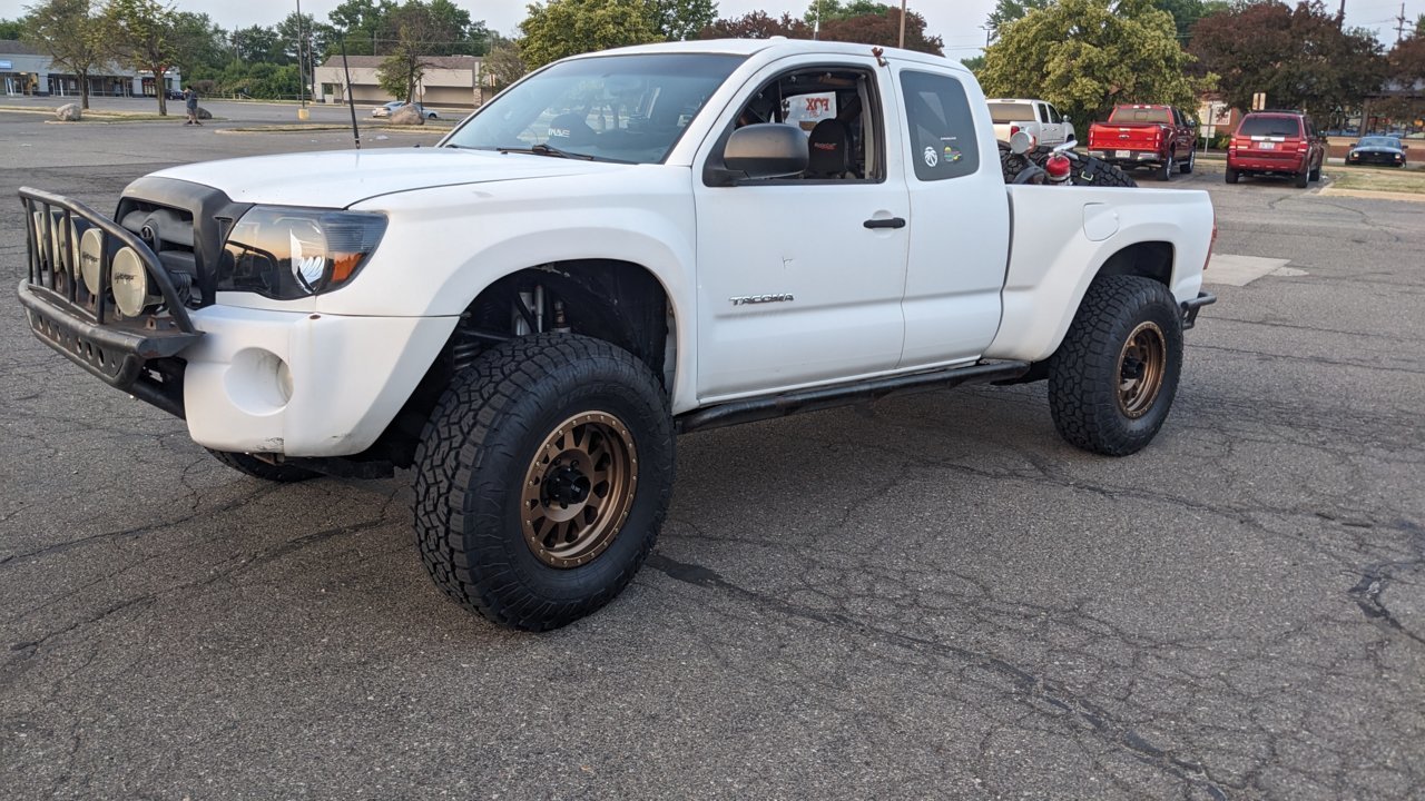

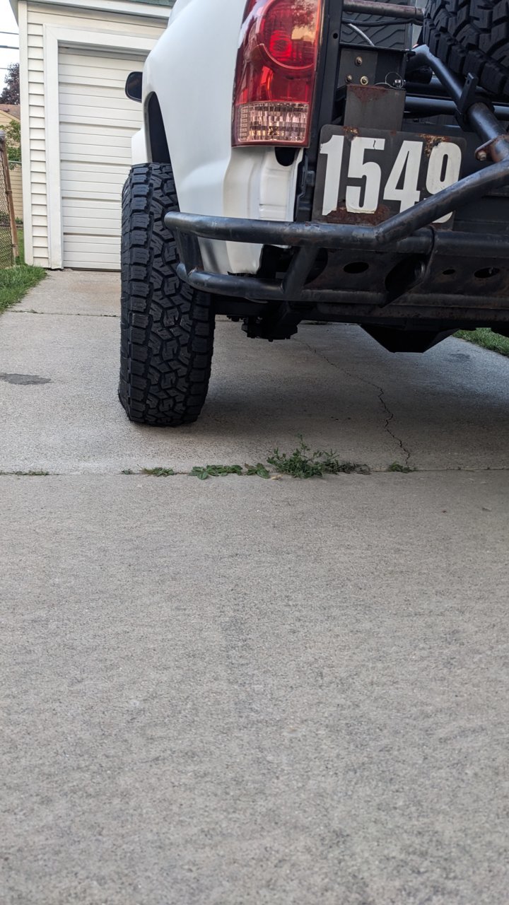

    Hey guys! Figured I would contribute to this thread. I recently purchased @mjp2 long travel class 7s race truck/prerunner. First mods were new wheels method MR304 and toyo 35x11.5R17 load C. When I bought the truck it was outfitted with KM2 33x12.5s. I borrowed a set of falken AT3 35x12.5 load E from a friend to check fitment. Acceleration reduction due to the heavier 35s was very noticeable right off the bat. For unsprung weight savings, I decided to go 11.5 wide which is a good compromise between super skinny 255/80r17 and traditional 35x12.5r17.
    Toyos measure exactly 290mm mounted on a 8.5 wheel.

  18. Jun 21, 2023 at 6:58 AM

  19. Jun 21, 2023 at 7:44 AM

    Wait......is it sitting ON the tires???

    :rofl: Yup! Registered, insured and moving under its own power.
