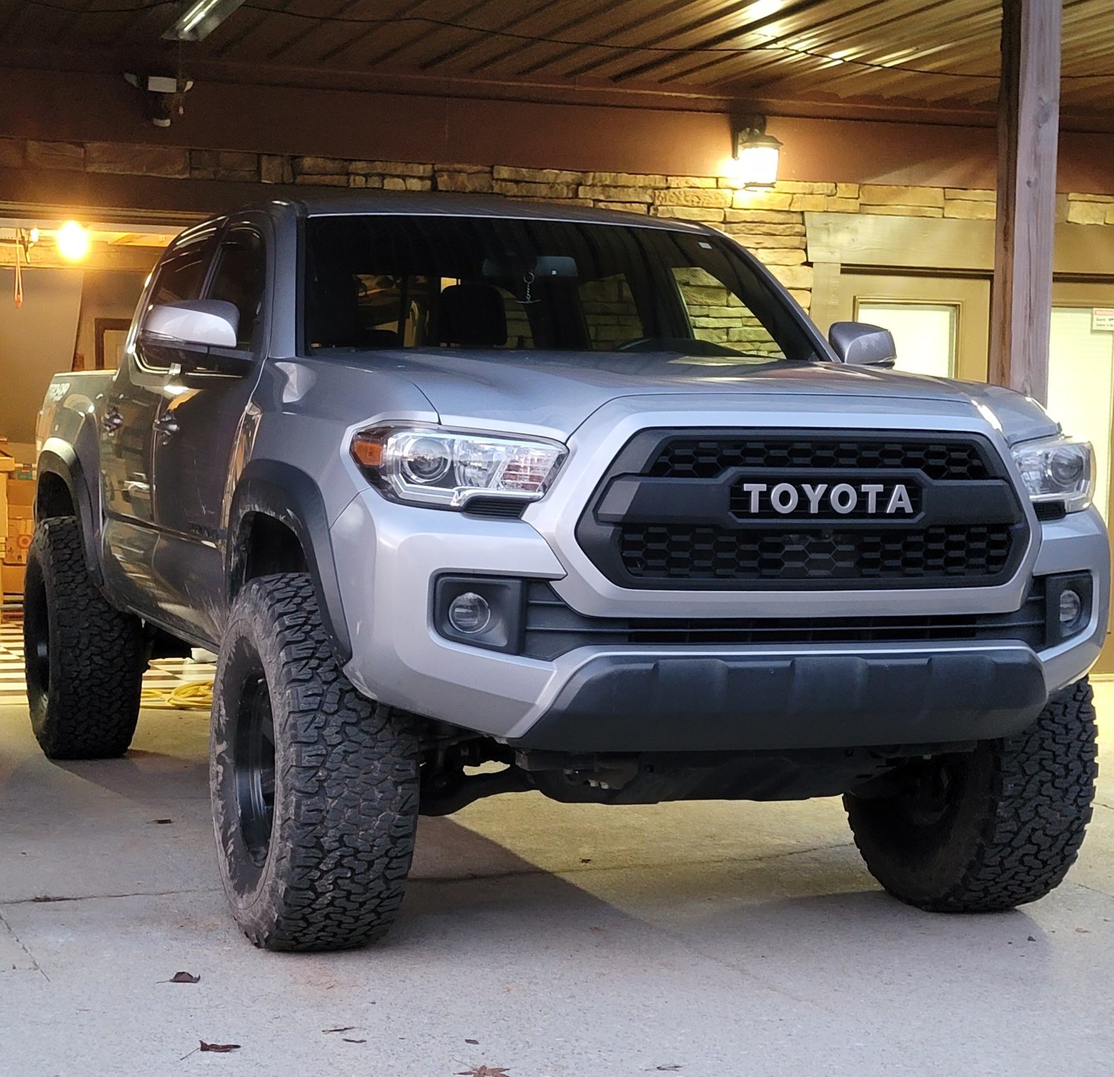

    I decided to move forward with spacers. Went with BORA @ 7/8". I personally didn't want anymore poke than I currently have with the 35s. I likely could've just gone the full inch, but this will at least ensure there's no hub stud peeking thru and gives me the needed UCA clearance. Should have them in a couple of weeks and I'll post an update. Screenshot_20231129_175646_Gallery.jpg Screenshot_20231129_175247_Gallery.jpg

    Looks great man! Honestly that’s way less poke than I expected. Thanks for posting and providing the knowledge. I’m sure they’ll work great.

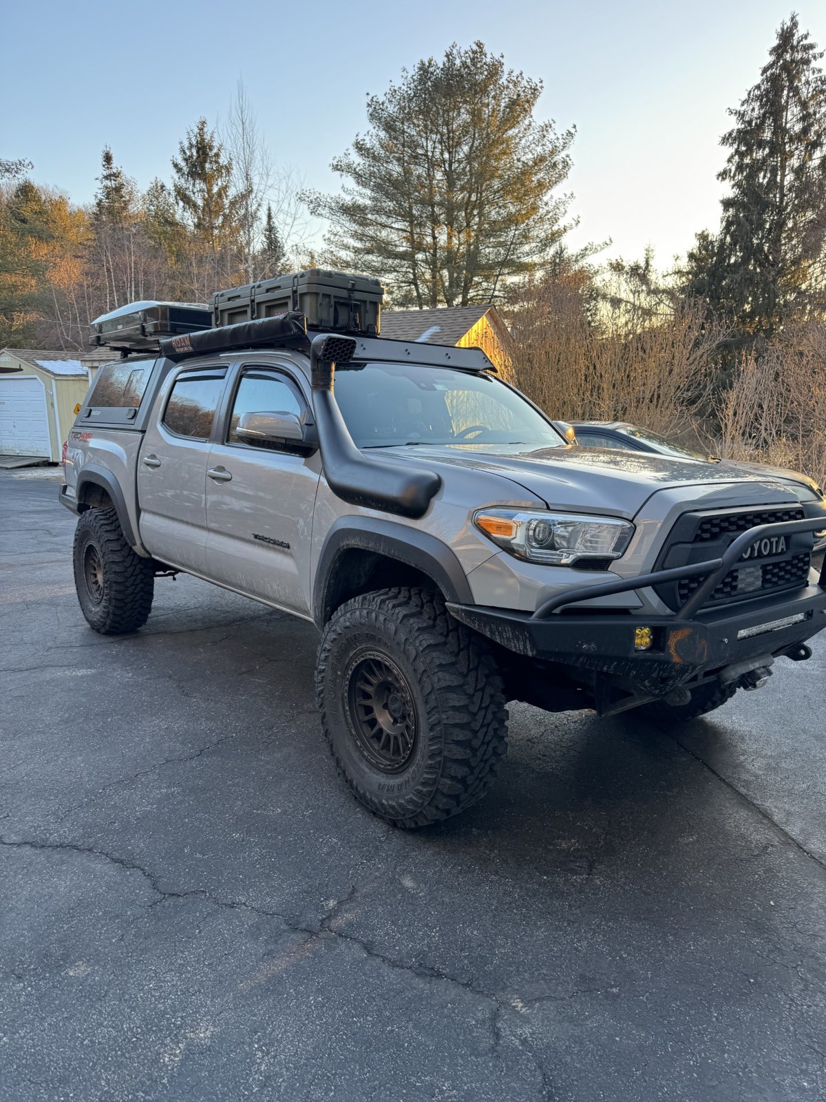

    35s are on finally

    Very rugged and capable looking Taco. Great job moding.:thumbsup:
