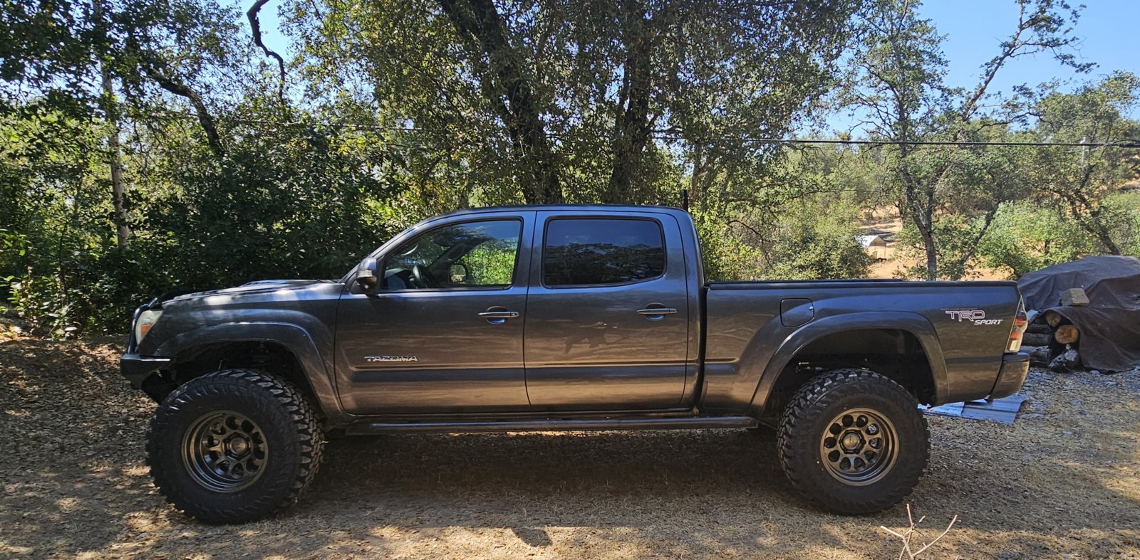

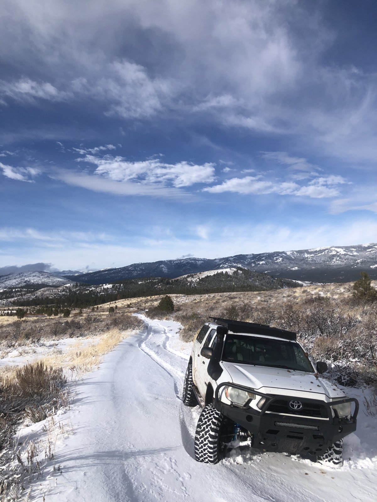

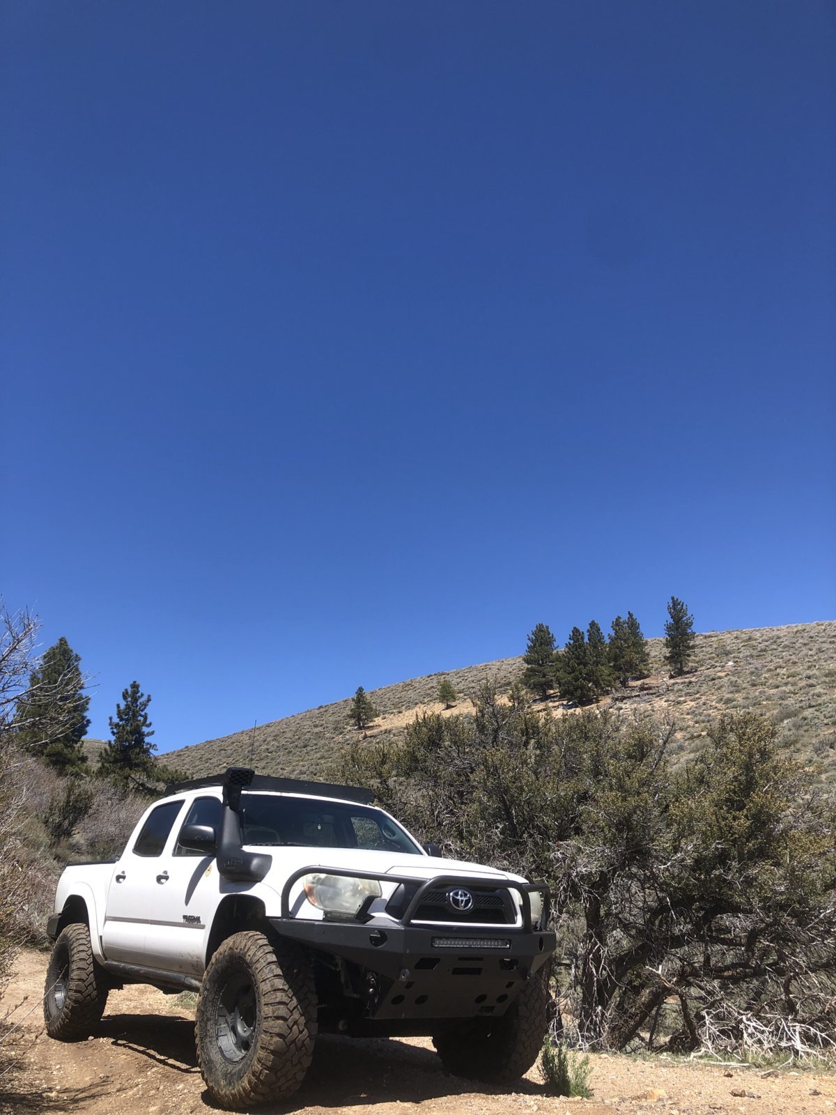

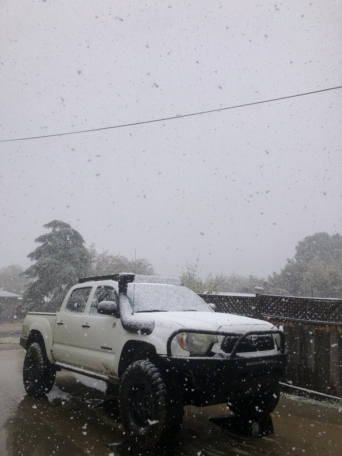

    It was a lot of work to get these to fit. Still need to do a little bit more
    Yoko Geos
    35/12.5/17
    SCS Blaze 10- 17X9 -38mm

    Looks great. I’m sure the offset was not working in your favor. But we need more photos of it!

    Yes as of today the -38 offset has the tire too close to cab Mount which is cut but I'm going to do a relocation in a few weeks. I am going to go cut part of it off today to give some more clearance so I can go off-road between now and then.

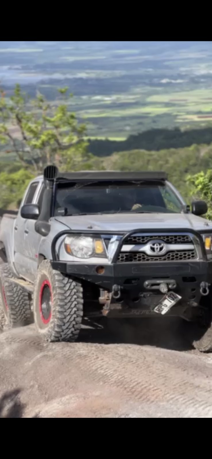

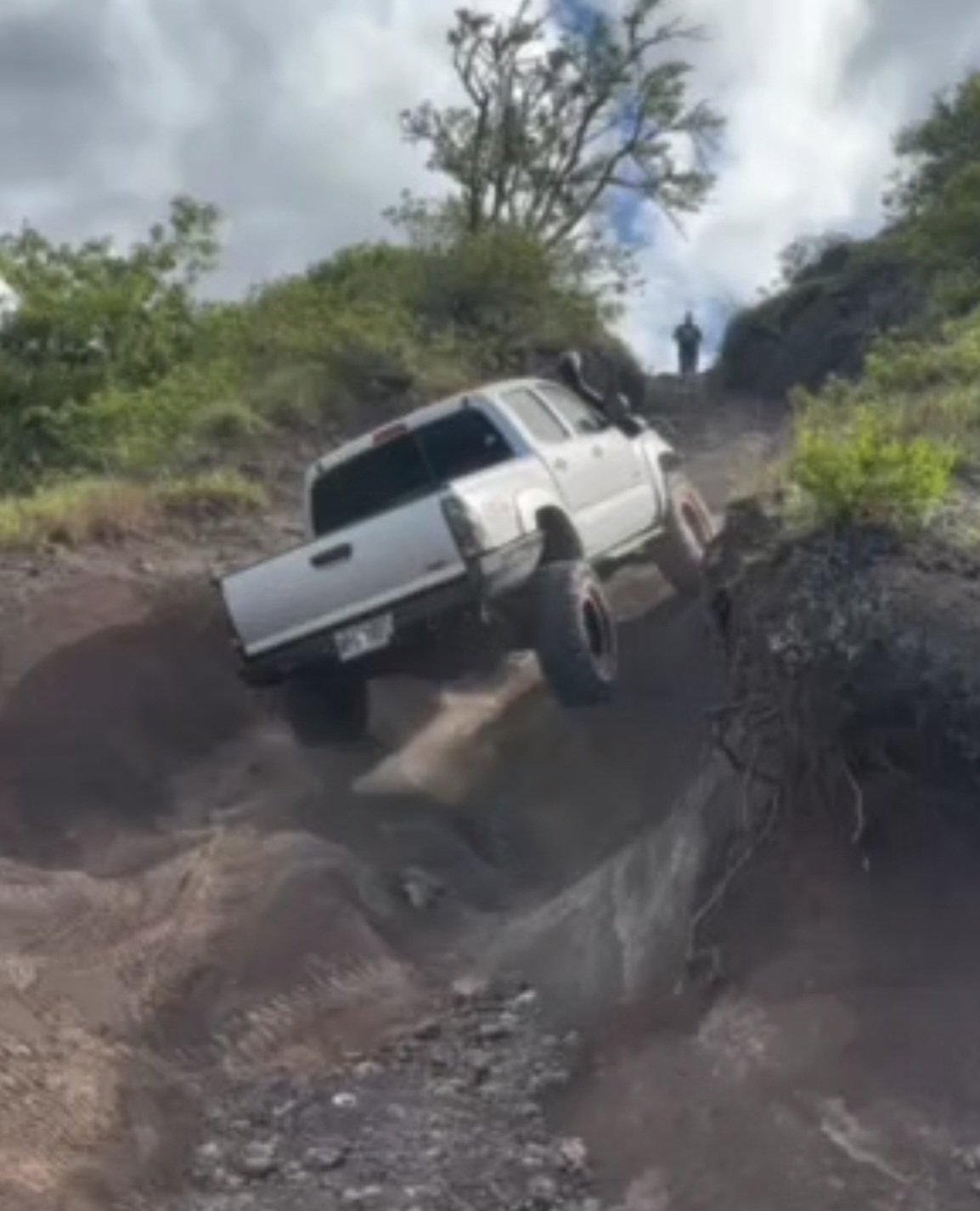

    Screenshot_20240703_110411_Gallery.jpg Screenshot_20240610_102444_Gallery.jpg
    315/75-16 on stock TX Pro rims

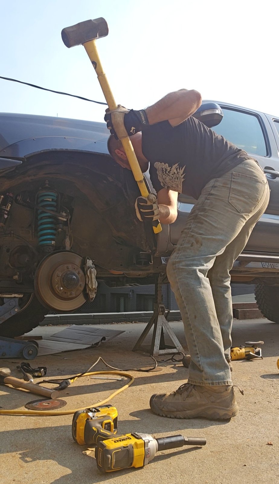

    I beat the hell out of the firewall today! No more rub when fully flexed and wheel completely turned

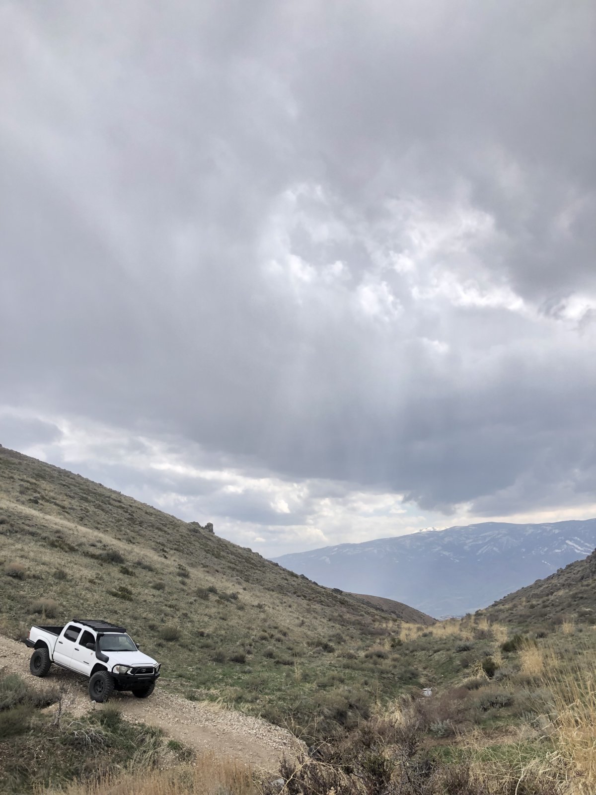

    finally have it road worthy, after years of sitting. tires are almost bald though sadly and lost my black headlight mod from a crash.

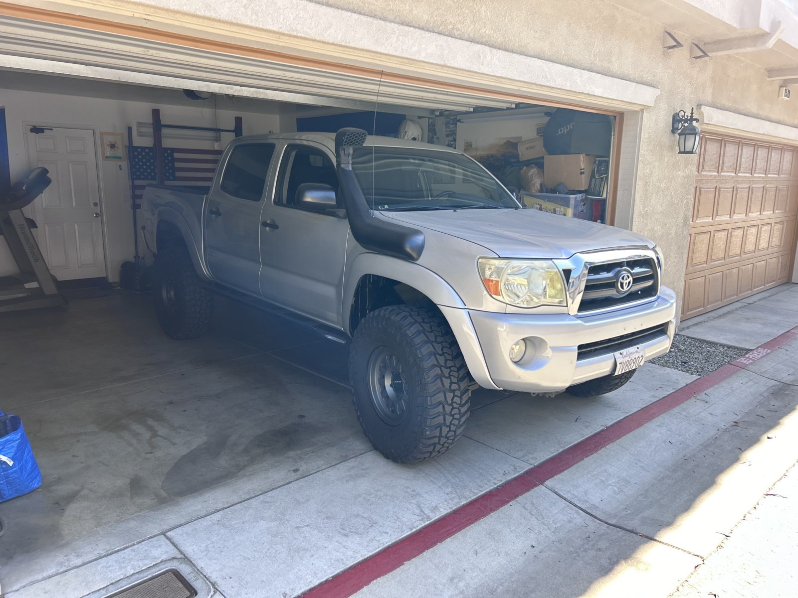

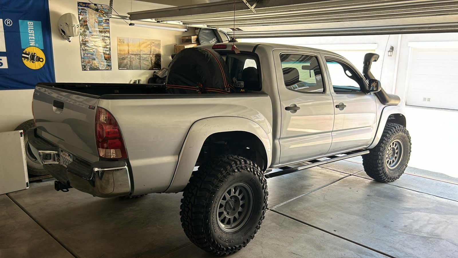

    Alright. 1.5” 5100’s on OME885 at bottom clip, OEM UCA, SpiderTrax 1.25” spacers, Alpine Designs CMR, sledge hammered firewall, Wheelers OR Bump stops, Mickey Thompson Baja Boss MT 315/75R16 with method 704’s (0 offset), 1.75” fender cut, 1.5” flare cut in the front and 1.5” fender cut and 1.25” flare cut in the rear(I’m on Chevy 63”s). Waiting for one shock to do the 14”s in the rear. Sits leveled with spare, ice chest and jack in the bed(220lb). Nothing rubs at full articulation.
