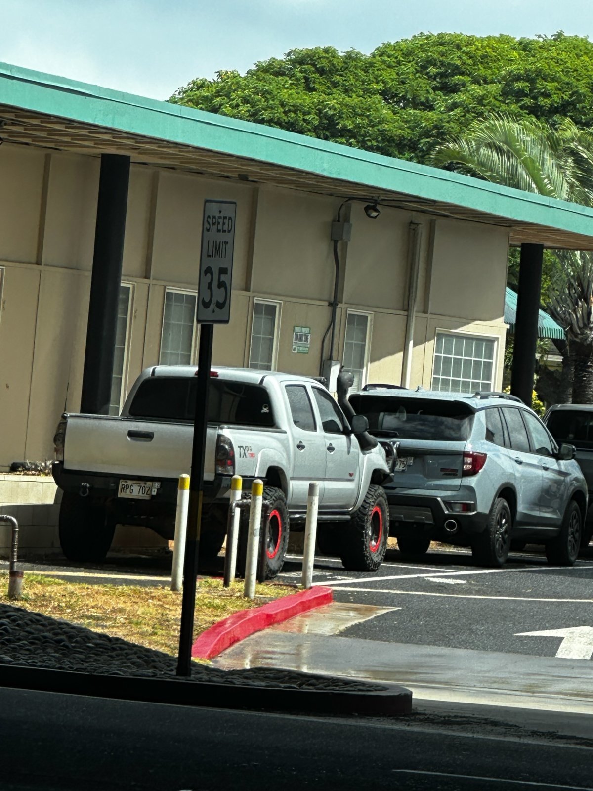

    I do. I have to run 1/2" spacers too to keep the tires from rubbing the rear shock and uca. No problems at all other then that and they don't look as "full" when compared to the same tire on a 9" rim.IMG_20240723_104158.jpg IMG_20240728_190641_121.jpg ]

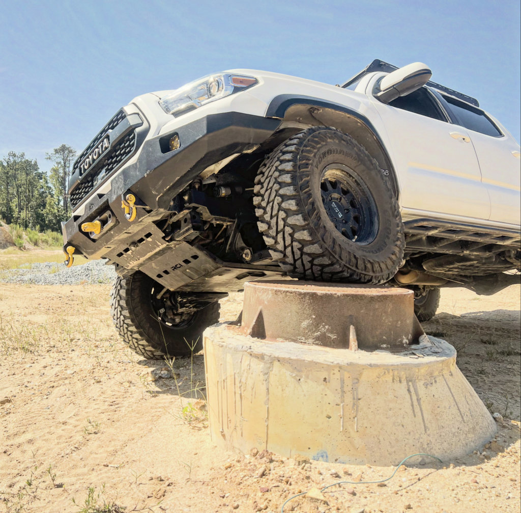

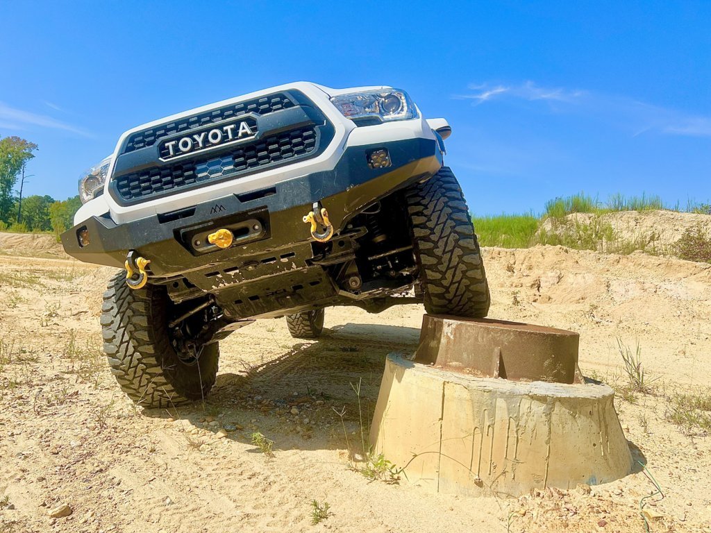

    18 Tacoma TRD off road OME BP51 front Fox 2.0 Resi rear OME Dakar Meduim Yoko G006 325/75r16 Black Rhino stadium wheels Cali raised ditch light brackets Baja Designs S1 pods Baja Designs Squadron SAE fogs Prinsu Cab rack TRD Pro grille AVS rain guards Backwoods adventure mods hi-lite bumper BL Apex 12k winch Dobinsons 4x4 snorkel Sy-clone prefilter ARB rear diff breather relocation RRW rock sliders RCI full skids At the helm bed stiffeners lil b LCA skids Warfab Phantom rear bumper Warfab tie rod sleeves C4 fender liners Dirt king UCA Duro bump stops
    Yes and no. It’s going to take some other work too.
    I have a 2.5” lift, BWAM front bumper, C4 Fender kit, dirt king UCA, wheelers bumpstop, -10 offset wheels, hammered pinchwelds, slight hammering of the fire wall and a cab mount chop with no plates. My alignment caster is 4.0 and 4.3.
    Only place I rub is on G outs in my upper wheel well. That’s because I have a good balance of spring compression, front end weight and my bump stops. I could prevent it with bumps that are taller and higher weight coils but it would limit my up travel.
    edit found my alignment sheet
    Full lock and the back left on a 3ft ramp.

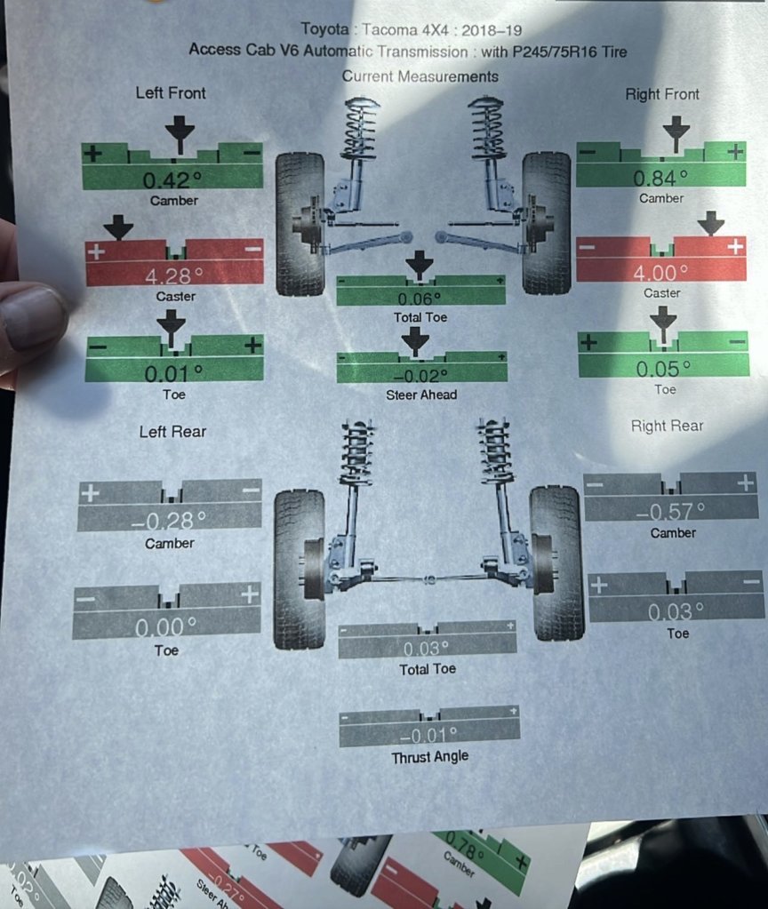

    Finally joined the crew today! First set of BFG's too!
    Sadly, I'm rubbing my UCA's. They are currently JBA's. My Methods have a -12 on the offset. I have another set of UCA's on order that I wanted to try. Maybe I'll have more clearance since they are uniball?
    Also thinking of spacers as a temp fix til my new arms come in. Thoughts?

    What size are they? I thought -12 was supposed to be the sweet spot or at least that's what you hear. Also depends upon how wide the 35 is. I have -38 and no issues rubbing UCA but CMR was mandatory and beating the firewall with sledgehammer. I think somewhere around -20 to -25 with wheel offset or with spacers would clear any uca.

    35x12.5R17s. Already did a CMR. Beat the pinch welds and did high clearance fenders.

    I have -10 and it’s super close to my gusseted spindles. If he’s still running stock UCA that could be the reason. They stick out pretty far.

    Going to get another alignment done Wednesday first. Couldn't get a print out but I did take a bad pic. I think the dealer misheard me when I asked them to leave the caster high. They put that in the green and left the camber high.

    My alignment shop is pretty great. They took a look. Showed me that my passenger spindle was bent and didn't even charge me. So now off to fix that, ha. How much driving should I be doing with a bent spindle?
