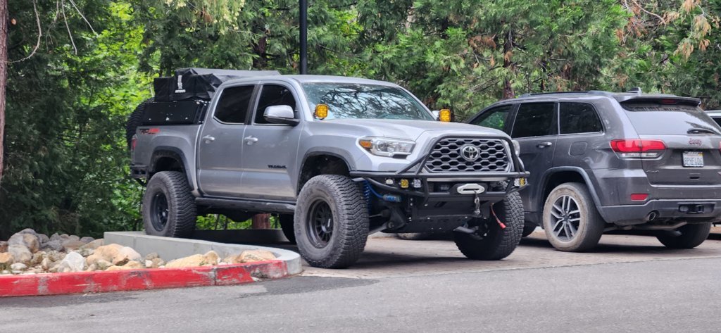

    Probably not much. Especially off-roading. Time for spindle gussets

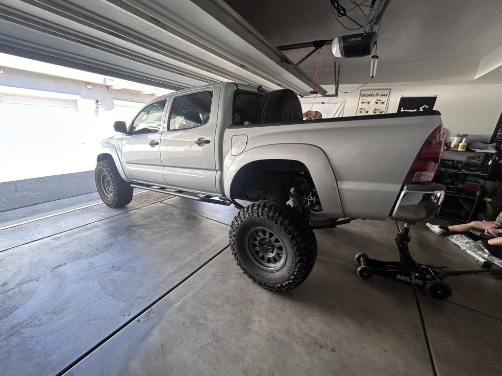

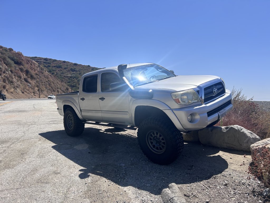

    Random stuff. Oh! and converted to non ADD 4x4.

    Btw I’m on stock UCA’s and manual alignment at my highly recommended spot.

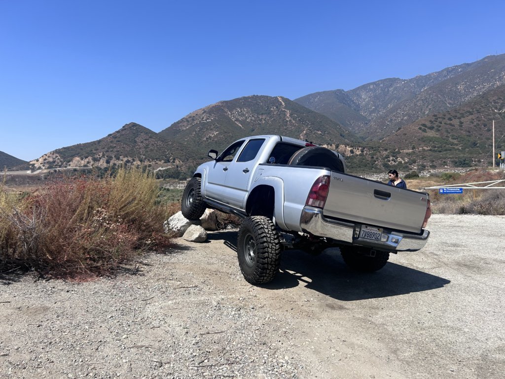

    Nice flex. I want those Chevy 63 leafs with 14 in shock. Next on the list.

    I have about 3” more of droop and 2” off tuck, everything clearing :thumbsup: definitely a DIY project due to the variables from truck to truck.

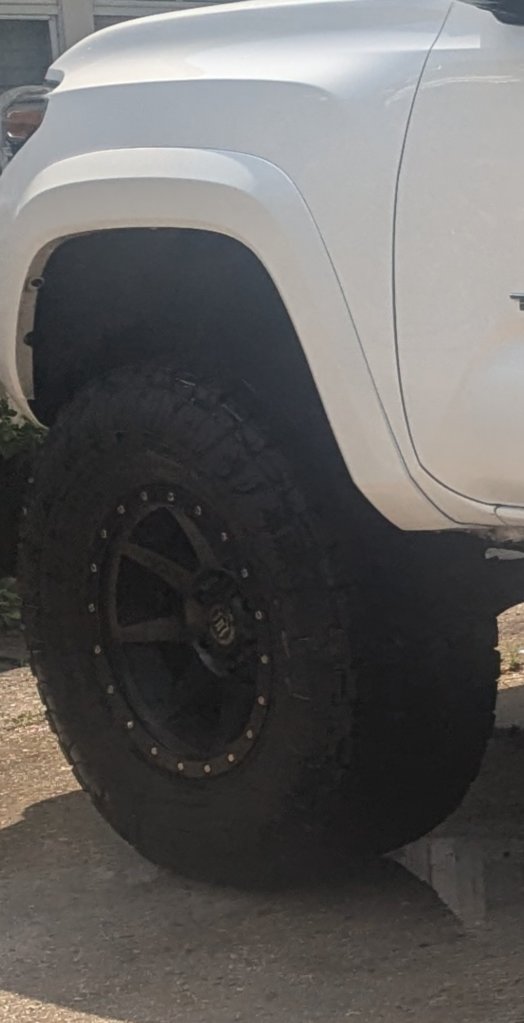

    Test fit 1 of the 315/75R16 coopers on my stock pro wheel. I like how they suck in the tire just a bit more. I did put a tape measure on them after they were mounted, comes out to 34 1/4” with 34psi not on the truck. I definitely rubbed on the pinch weld and cab mount just turning the wheel. Cab mount chop, pinch weld fold and fender cuts are in progress. First pic is the 285, second is the 315. The 285’s have been on there for 50k though, so they’re getting pretty close to slicks…

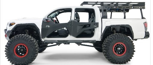

    Roger that. I did the same thing a few months ago with trimming the fenders and installing the C4 kit. I was hoping you knew of an aftermarket fender flare that was high clearance.
    I've seen one example on the FabFours truck but FF doesn't appear to sell them and I've never seen them anywhere else.

    I wonder if those are custom? I already spent enough on the C4 kit, ha. I don't need fancy fenders. I'm about to cut my rears next. There's nothing to those. Just pull the liner and start cutting.
