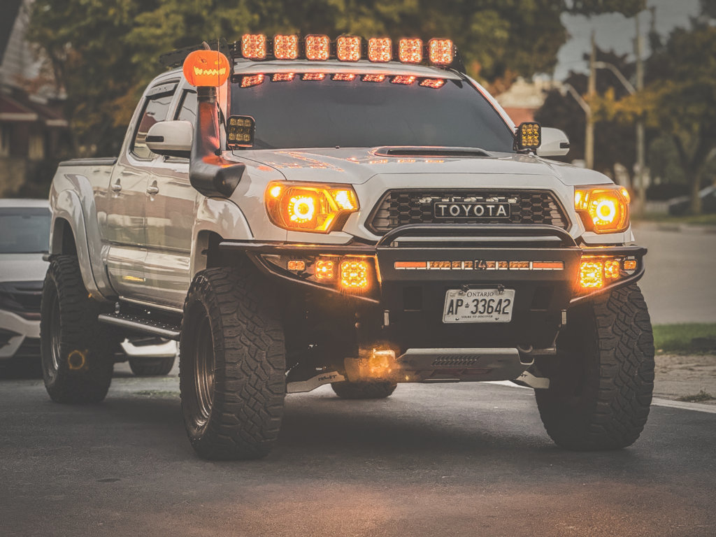

    Needs more lights

    Total OT, but I like your snorkel. Who makes it?

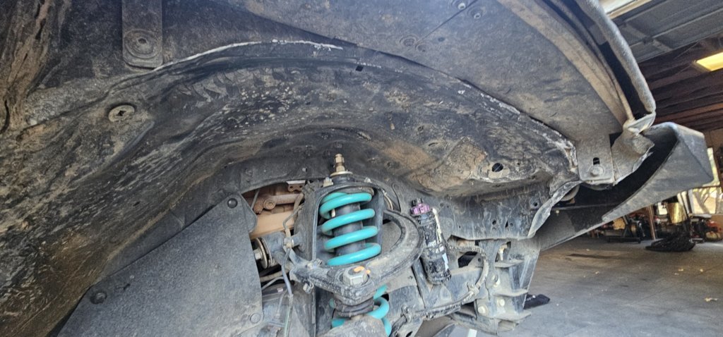

    Last place I've been rubbing is in upper fender well near battery on driver side and windshield wiper fluid tank on passenger. I hit it some with a sledgehammer previously but was still rubbing with full lock and tire fully stuffed. I took tires off and beat the hell out of it. I took windshield wiper tank out and battery out as to not damage them during the abuse. I was previously rubbing hard in the picture below and now no rubbing.

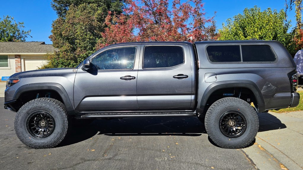

    Pulled the trigger on 35's! Falken AT4W 35x11.5r17 C Loads on Relation Race Wheel RR7-H -13 Offsets. I drove from America's tire straight to my go-to Bay Area Toyota Specialist Milo at Milogen Fabrications in Milipitas, CA to get my fender's trimmed and C4 liners installed. Picking up tomorrow afternoon, will update with after pics! It already rode nicer than my E-rated Mickey Thompson Baja Boss At's in 295/70r17 E's.

    It’s the Airaid, sy-klone on top and an adapter from TW

    Looks sweet. I’d be interested in more pics and info on necessary trimming and cutting. I am considering these as well as the KO3 in a 315/75/16 for my next tires.

    Update to 35's. Fenders cut, bumper tube cut back, and rear bedside quarter panel bracket added for rigidity. Did a trip to Hollister SVRA and only slightly rubbed!
