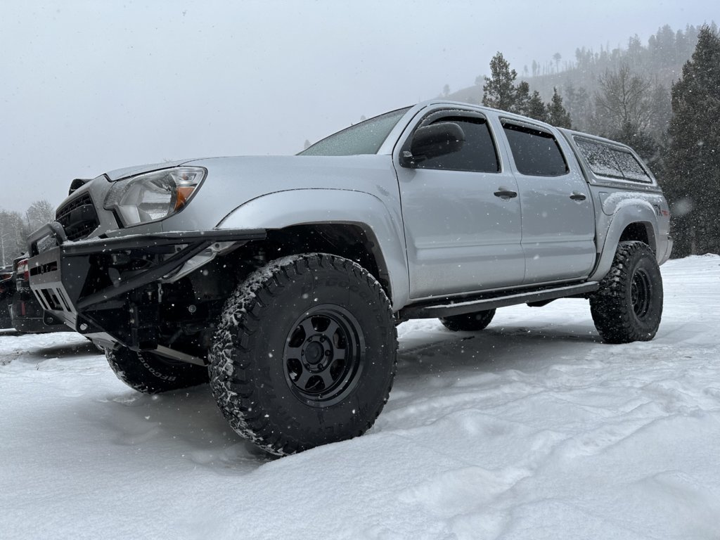

  3. Jan 12, 2025 at 6:44 PM
    #643
    boostedka
    boostedka Well-Known Member
    Sep 29, 2011
    #64367
    6,061
    James
    NM
    2013 DCSB 6MT, 2004 4runner
    KO3 315/75R16

    Oreo Cat
    Oreo Cat Worst Member
    Sep 19, 2016
    #197755
    5,366
    Coeur d’Alene, Idaho
    Are those real TE 37s?

  5. Jan 13, 2025 at 7:40 AM
    #645
    boostedka
    Sep 29, 2011
    #64367
    6,061
    James
    NM
    Not even. They are knock-off 9six9 wheels. They have a -10 offset instead of -20 offset making them easier to keep from rubbing. Definitely not as baller tho.

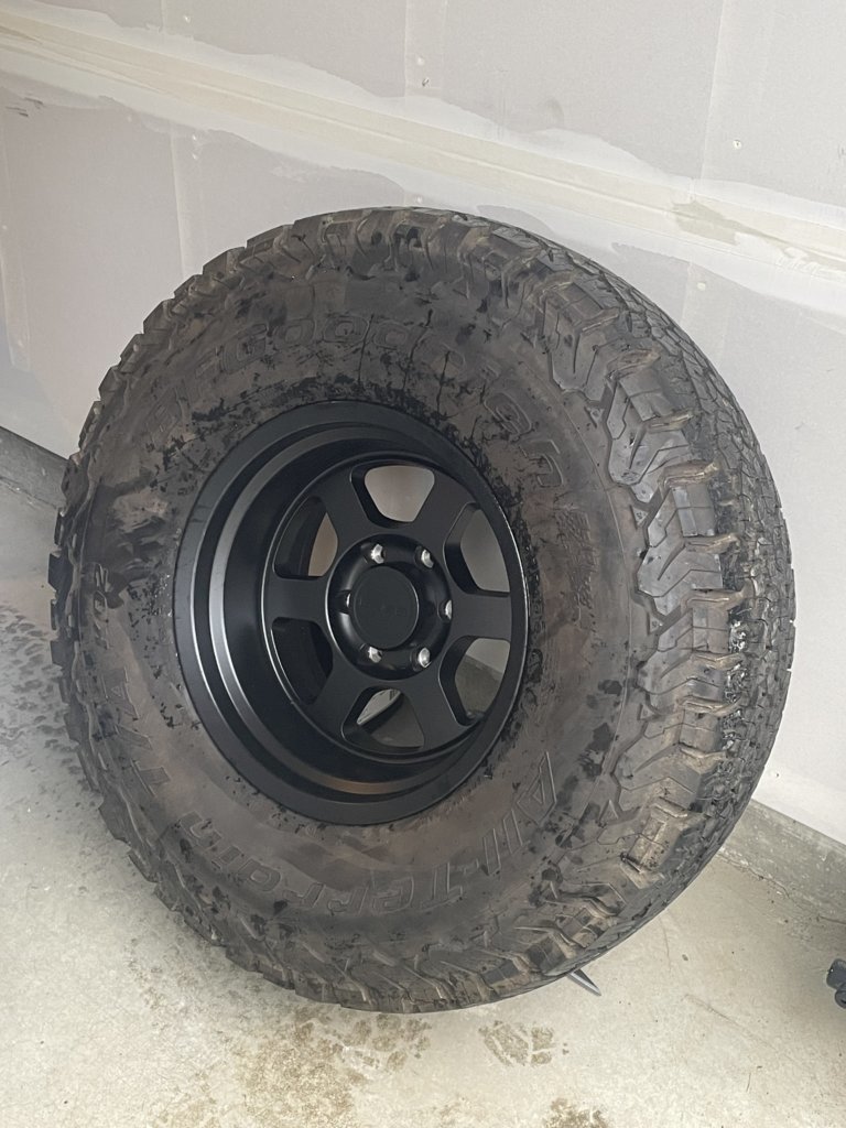

  6. Jan 13, 2025 at 8:03 AM
    #646
    Oreo Cat
    Sep 19, 2016
    #197755
    5,366
    Nice I have the same ones in my garage with 37s waiting to go on, I can never tell them apart though since I’m not a wheel person
    Do you have a link to what lug nuts you used? I currently have pro comp wheels and the lugs definitely aren’t going to transfer over

  7. Jan 13, 2025 at 8:53 AM
    #647
    boostedka
    Sep 29, 2011
    #64367
    6,061
    James
    NM
    I used these lug nuts from Amazon. I called NLM before I ordered them and they said any splined acorn style lug nut should work that isn't ET. What are the specs on your wheels? They look like the 17x9 -36 offset with that deep lip.
  8. Jan 13, 2025 at 10:09 AM
    #648
    Oreo Cat
    Sep 19, 2016
    #197755
    5,366
    boostedka[QUOTED] likes this.
  9. Jan 13, 2025 at 11:22 AM
    #649
    boostedka
    Sep 29, 2011
    #64367
    6,061
    James
    NM
    Gonna look sic! I can't imagine the chopping involved
