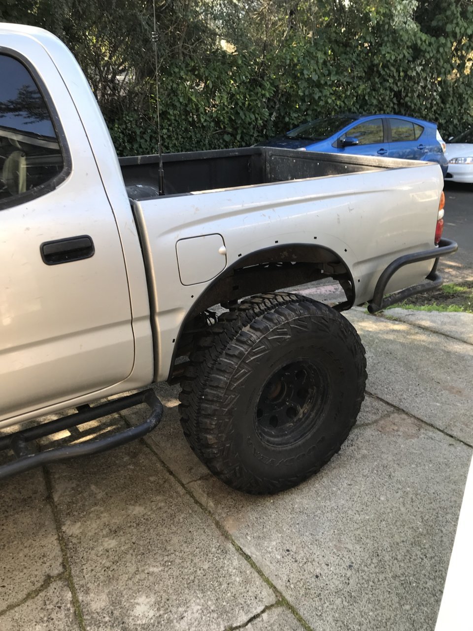

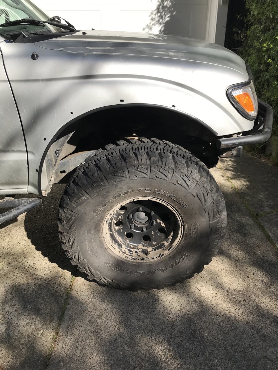

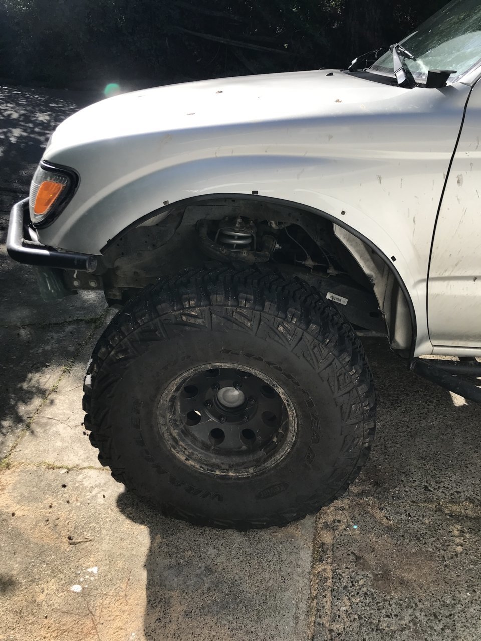

    Goodyear MTR 35x12.50x15’s. Took 1.75 inches off the fenders a few weeks back. 15 x 8 American racing wheels with 1.25 inch spacers. Still ribs at full lock at ride height. Prob gonna try SPC upper controls arms soon, seems like I should be able to pull the tire .75 inches off the firewall with some tweaks and +2 deg caster setting. Considering a 1 inch body spacer after If I have to, then hack the firewall if need be....then hopefully hit some harder trails this year.

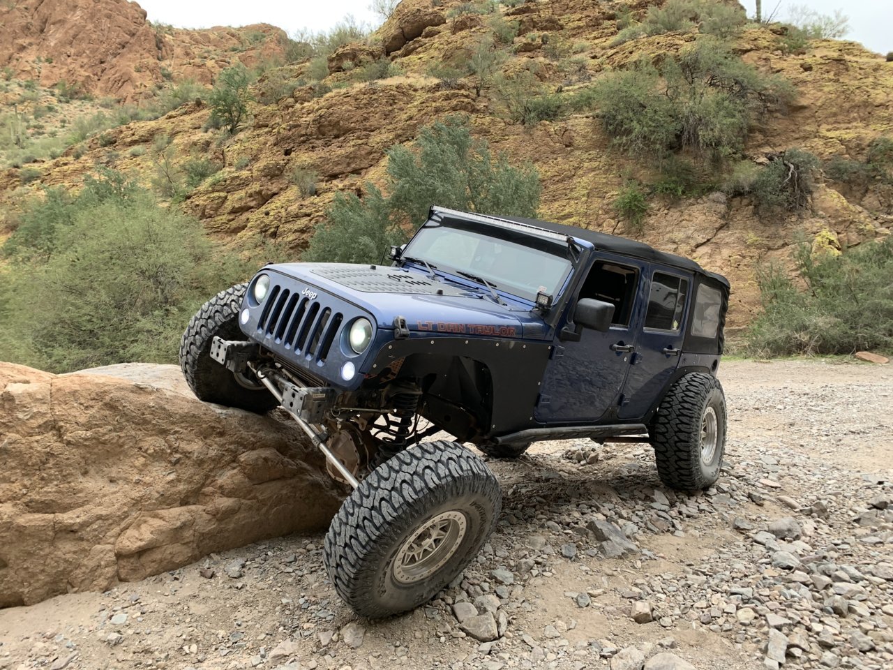

    35z12.50R17 Maxxis Trepador Radials

    35’s on 15’s look SO GOOD. Keep us posted on your progress!

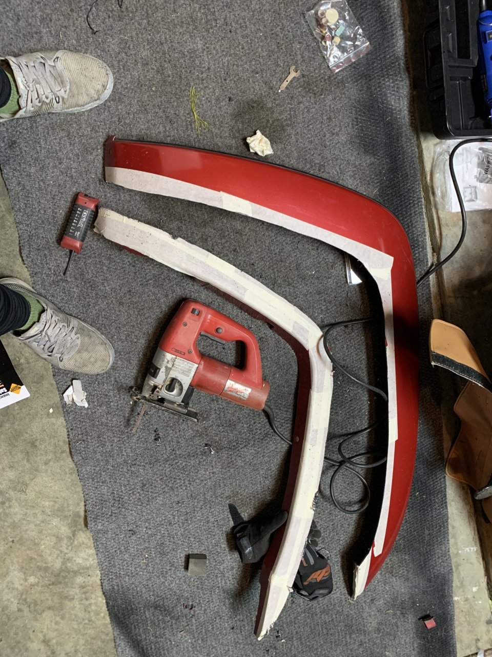

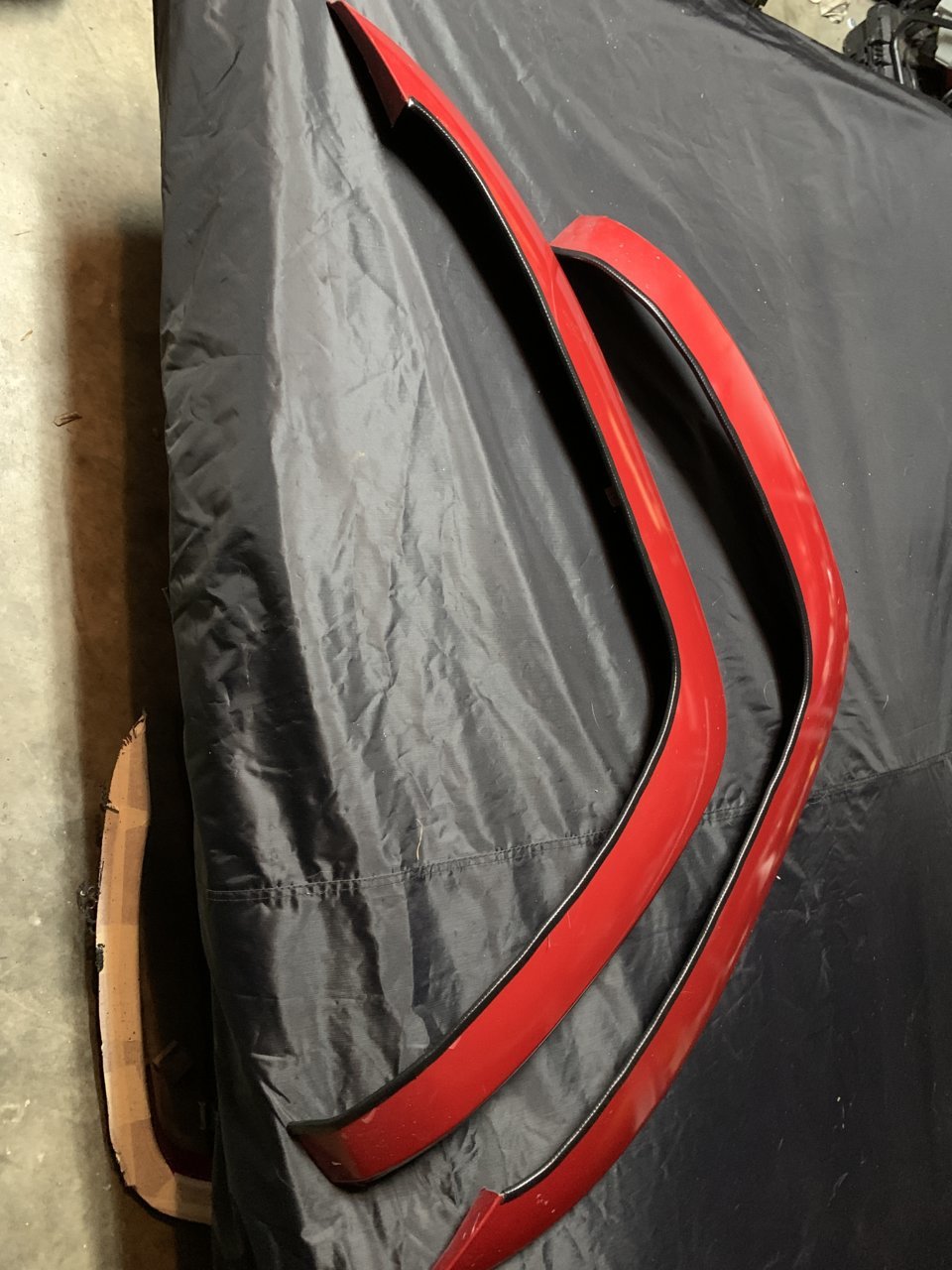

    front fender flares done. Update tomorrow when I cut the Actual fenders

    Looking great. What edge trim are you using?

    I have a roll of similar edging I've yet to try putting on the truck. The stuff that you get from the parts stores that is a plain old u shape without the extra grippers doesn't last more than a wheeling trip before it falls off
