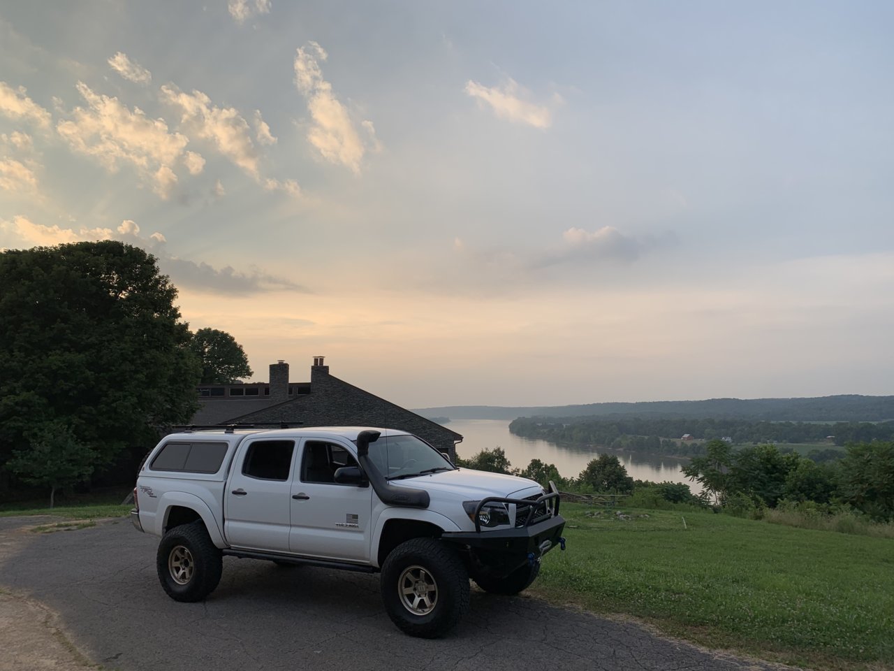

    Here is my contribution to this thread I am posting because 35s have cost me a lot of money

    Yes please. :drool:

    Lol. I hear ya. Gotta pay to play. Thanks for sharing. Your truck looks great!

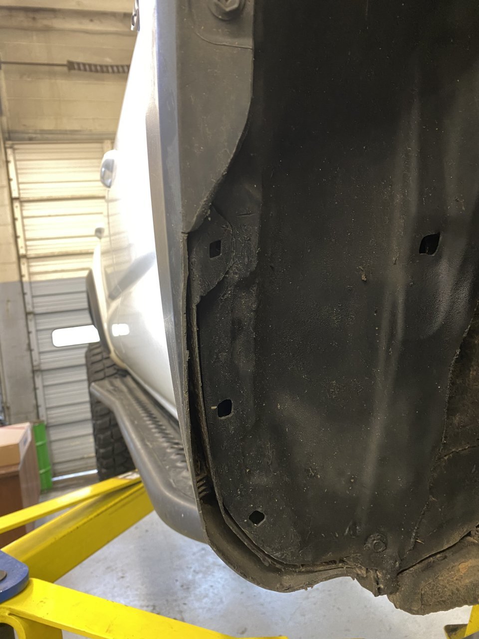

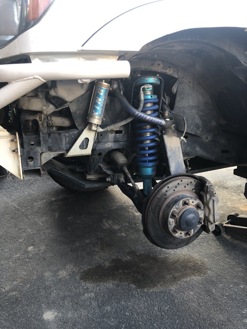

    Yes running SPC uca’s . Cab mount chopped to the bolt , pinch weld flattened outward , liners flattened foam blocks shaved down with a belt sander then zip tied back into place ( helps keep door and hinge clean ) fender and flare trimmed even with fender tub. 5E90E32B-0561-4B30-B765-7E9CA03F5877.jpg37EDAB40-4AEE-4636-8928-638D6D126992.jpg2995489D-452A-4471-B9F8-E9142A85AE85.jpg
