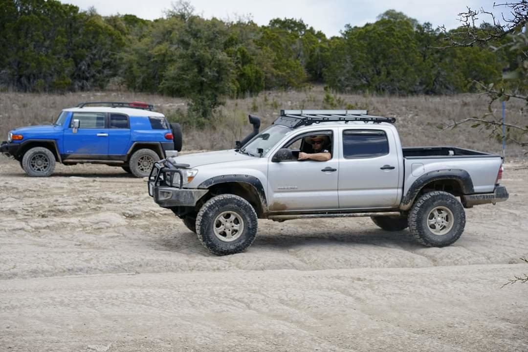

    Yes i do. Plate bumper, winch, full skids.

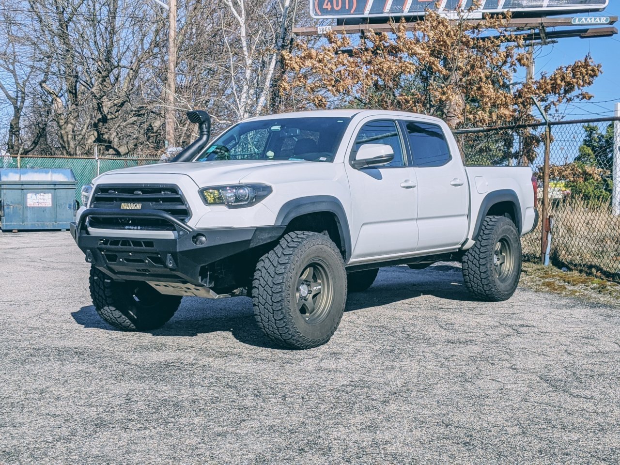

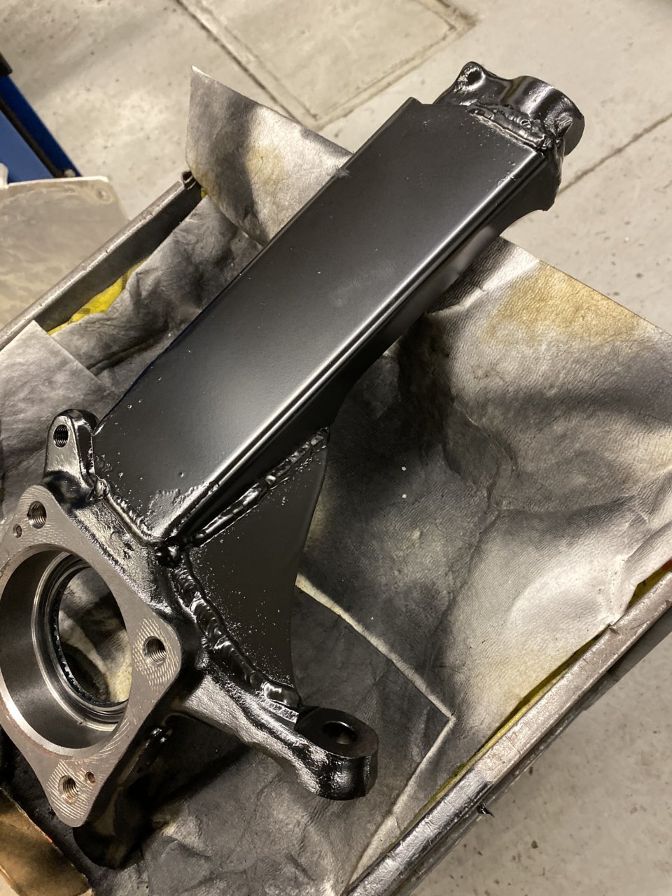

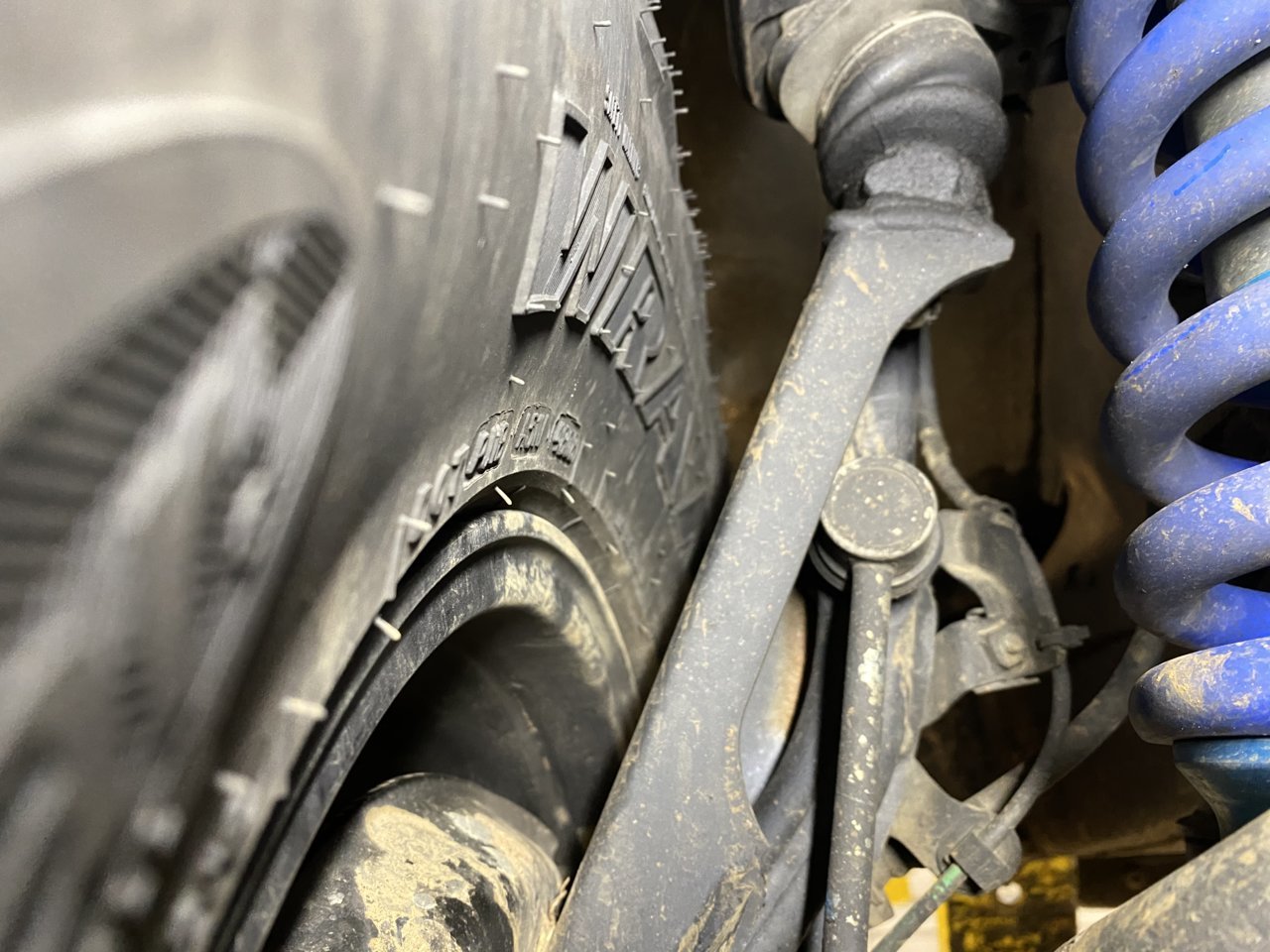

    Almost forgot just about the most important mod for 35’s . The spindle gussets 1CB6FBA4-AC38-4891-8961-3493870C101C.jpgIMG_2691.jpg

    I still want to get this done, are those the total chaos ones with the sway bar? How's clearance where the tire is? Looks pretty tight.

    Better off with a spindle upgrade kit from Camburg if you gonna wheel on 35s

    Besides cost, what makes these better/stronger than stock with gusset? I need to do somethin' for my spindles.

    Will these only work with Camburg UCAs?

    yes they are Total Chaos weld on gussets.
    I think it’s just the angle of the picture . Those are 4.3back space rims and they cleared just fine I am running 1/2” spacers with 3/4” longer wheel studs because the tire touched the UCA on full crank turns .

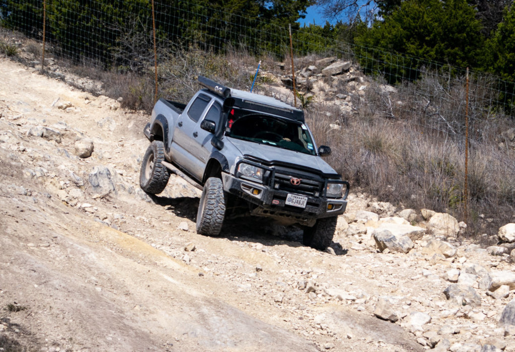

    Just some from last weekend.

    they will work with any UCA including OEM and I beleive any LCA. they are direct OEM 4wd replacement uprights and will work with 2wd also. Call Camburg to confirm tho.
