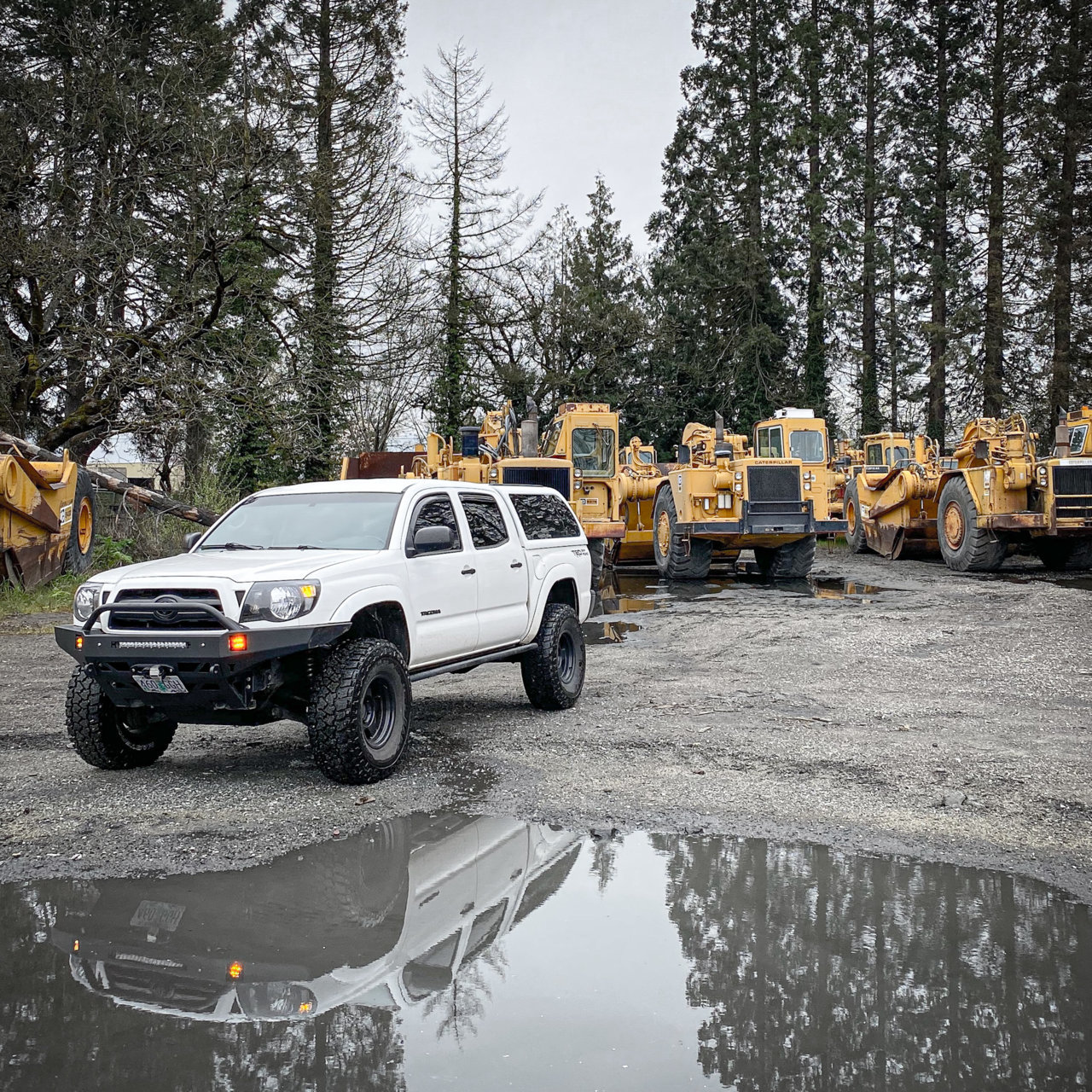

    I’m a little over halfway through the agonizing break in process for my 4.56 gears. Loving how the truck drives!

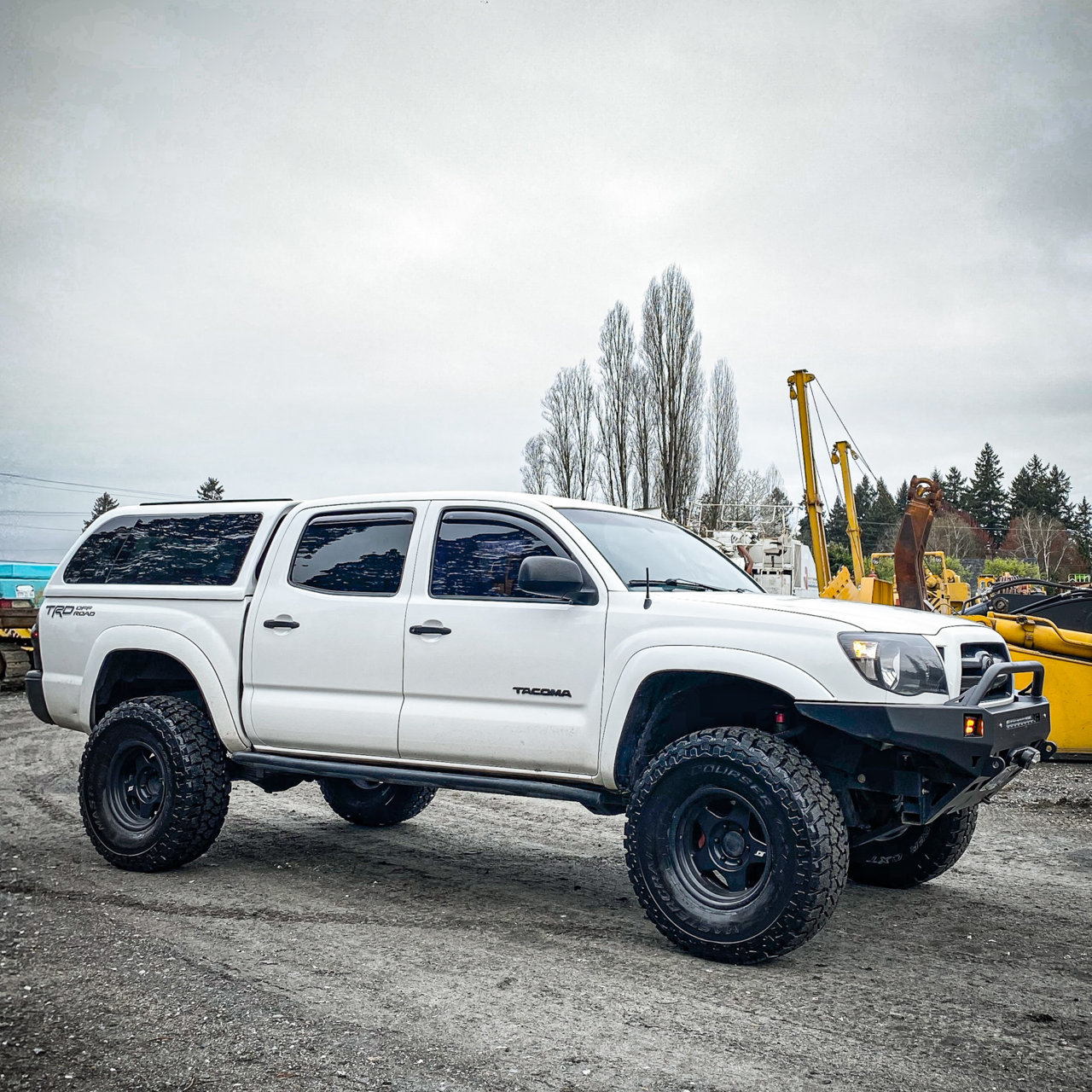

    Gear break in is now complete. Changed out the gear oil this morning. Now it’s time to enjoy these 4.56’s. I’ll report back after I get some non-break in miles on them.

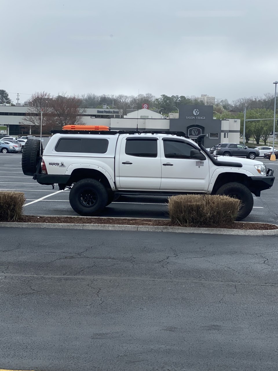

    Bone f’n stock for now

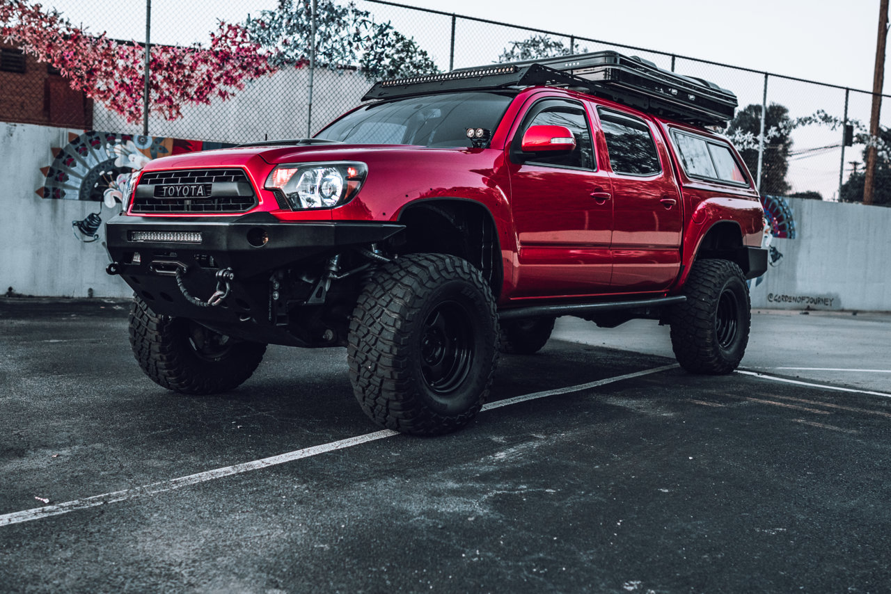

    I love this combo, Im running the same wheels and tires. I really like the blue
