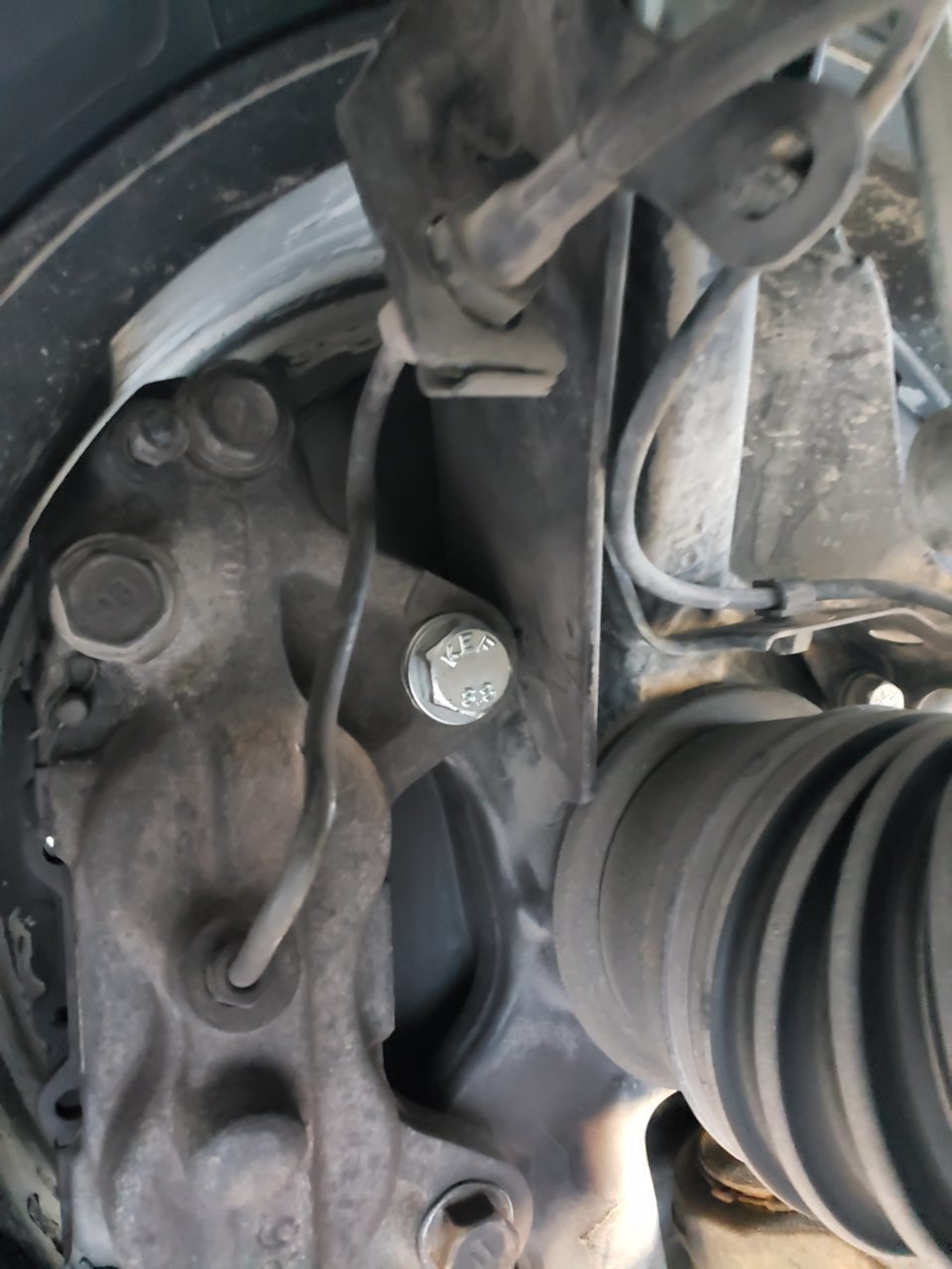

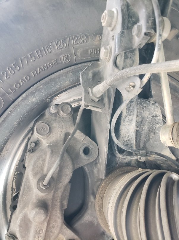

    I am having a great time in DV today... but appear to have lost a caliper bolt! Anyone in the bishop area have a spare they could sell me? None of the parts shops seem to have any. Will be swinging thru tomorrow.
    sawbladeduller, powder1134 and Hobbs like this.
  5. Oct 30, 2021 at 1:35 PM
    #665
    Hobbs
    Hobbs Anti-Lander from way back…
    Mar 20, 2016
    #181838
    22,351
    Yep…
    Rock Bangen', Desert Tamin', Gold Findin' Machine!
    I think that the missing bolt in your picture is a shoulder bolt, as opposed to a caliper bolt. At any rate I can source a bolt when I figure out what it is.
    PM incoming.

    I think this is also a stretch to torque bolt meaning one time use.
  7. Oct 30, 2021 at 2:00 PM
    #667
    Hobbs
    Mar 20, 2016
    #181838
    22,351
    Yep…
    Welp, I will buy a shoulder bolt at the hardware to get him home. Toyota closed at noon today. Unlikely they would stock it anyways.

    Dealers up here do stock. But there are occasions stuff you'd think should be in stock isn't.

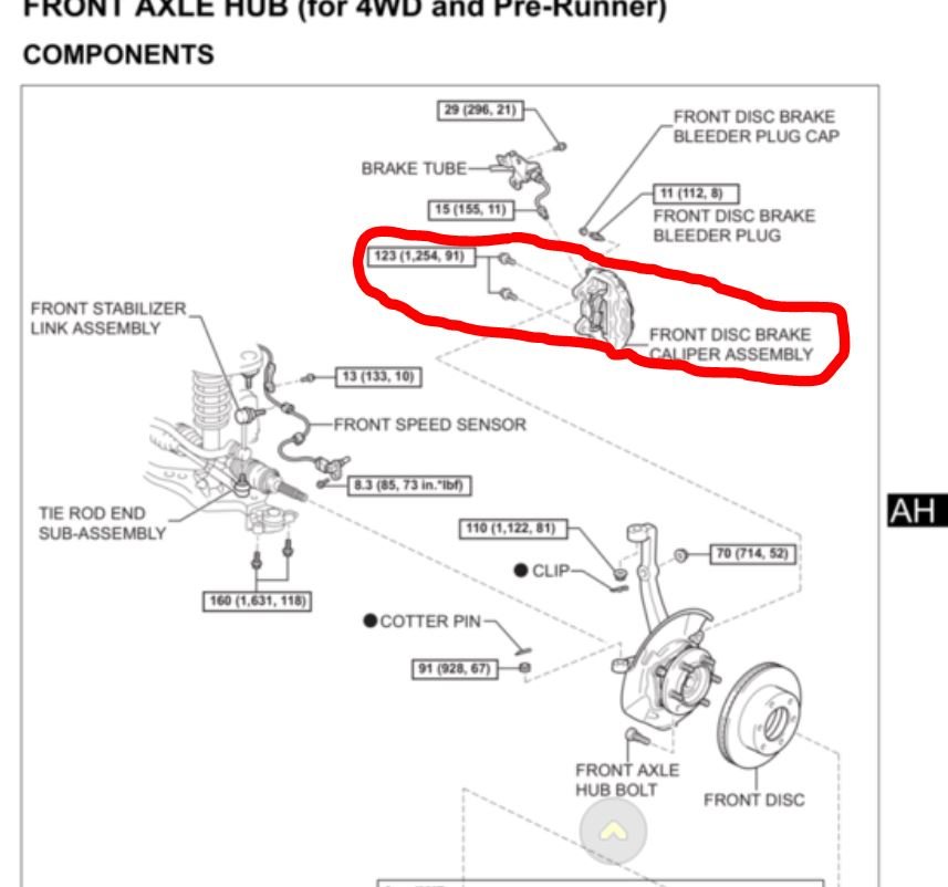

    Torque Values for those bolts...
  11. Oct 30, 2021 at 3:34 PM
    #671
    Hobbs
    Mar 20, 2016
    #181838
    22,351
    Yep…
    Thank you!
    I found that also in the 2nd gen forum! Do you know the factory rating off-hand?
    powder1134 likes this.
  12. Oct 30, 2021 at 3:44 PM
    #672
    MonkeyProof
    MonkeyProof Power Top
    Oct 7, 2008
    #9774
    12,824
    SoCal- SGV
    that's directly from the Factory Service Manual
    91ft.lbs.

    A great day to be in a beautiful place with AWESOME people!
    Thank you @Hobbs for making the rest of my trip a lot safer!!!

    Happy to help! :thumbsup:
    Safe travels!
