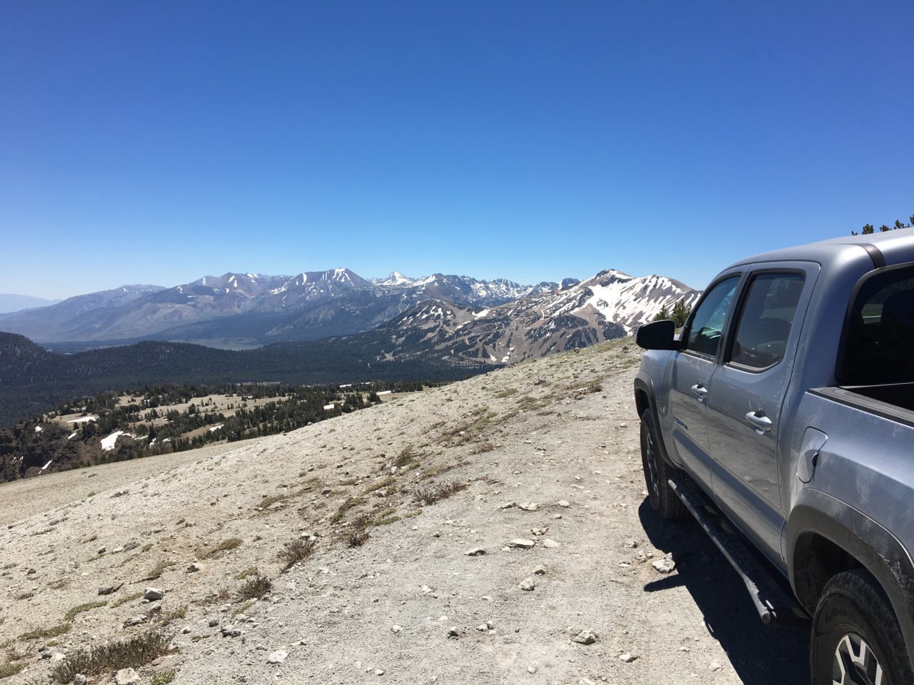

    Did some wheeling on the weekend and never have I ever wanted sliders so bad haha.
    Im thinking of skipping the powder coating and using line-x instead to help with the cost of shipping. What do you guys think?

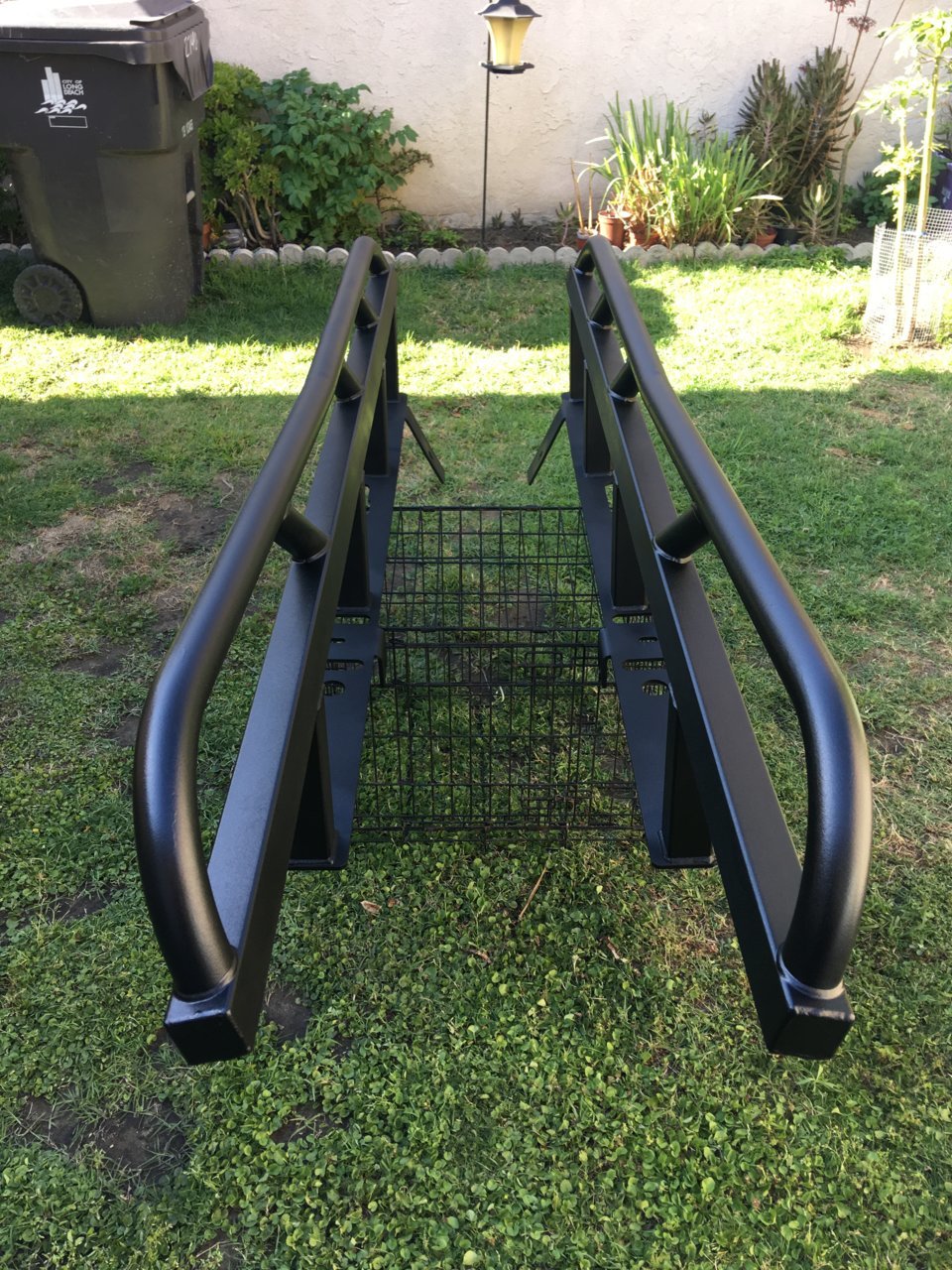

    Rock sliders

    How do you like them as steps?
    I’m Really considering these for that reason.
  7. Sep 17, 2018 at 11:04 PM
    #107
    D-CM
    D-CM Well-Known Member
    May 14, 2018
    #253512
    59
    2017 Tacoma TRD OR DCSB
    Rock sliders
    Well they are sliders so they are going to be higher then a typical step/running board. So for example, if there is an elderly person that needs a step to get in and out of your truck, it’s not going to be helpful for them. That would go for all sliders though.
    The reason I got them with the step plates is because I have little kids who’s feet and legs could slide right through regular slider bars when getting in and out. So they have worked well to prevent an accident like that. It’s also nice to have them as a step when setting up my rooftop tent and for washing the top of the cab. I could see them being helpful if you have a roof rack.
    Overall I’m not a fan of the step plate look but these C4 step plates are far and away better in appearance than any other fabricator I’ve seen.

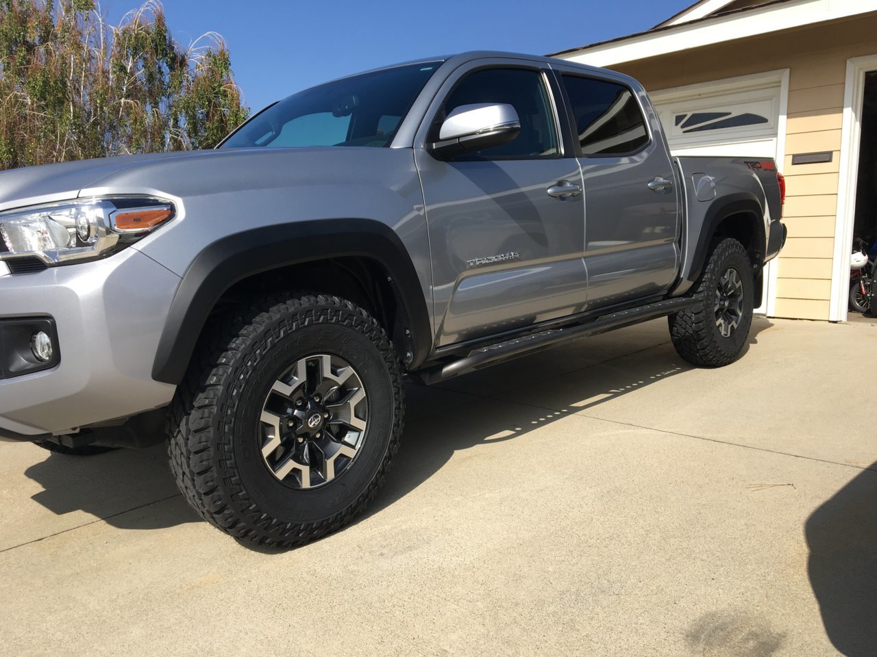

    20 and it's personal preference the closer to 0 you are the better step it becomes.

    Are those the "Standard" 20 Degree sliders? Or 5 Degree?

    RCI only had one when I bought, I'd guess they're 20 deg.

    I was one of the earliest 3rd gens to buy sliders from him, so I'll say yes since they are the original ones :)
    Personally I hate "flat" sliders, and these definitely kick up and are nice and tight to the body.

    Those would be the 20* sliders. The 5* would be essentially flat. Better utilized as a step.-Tim
