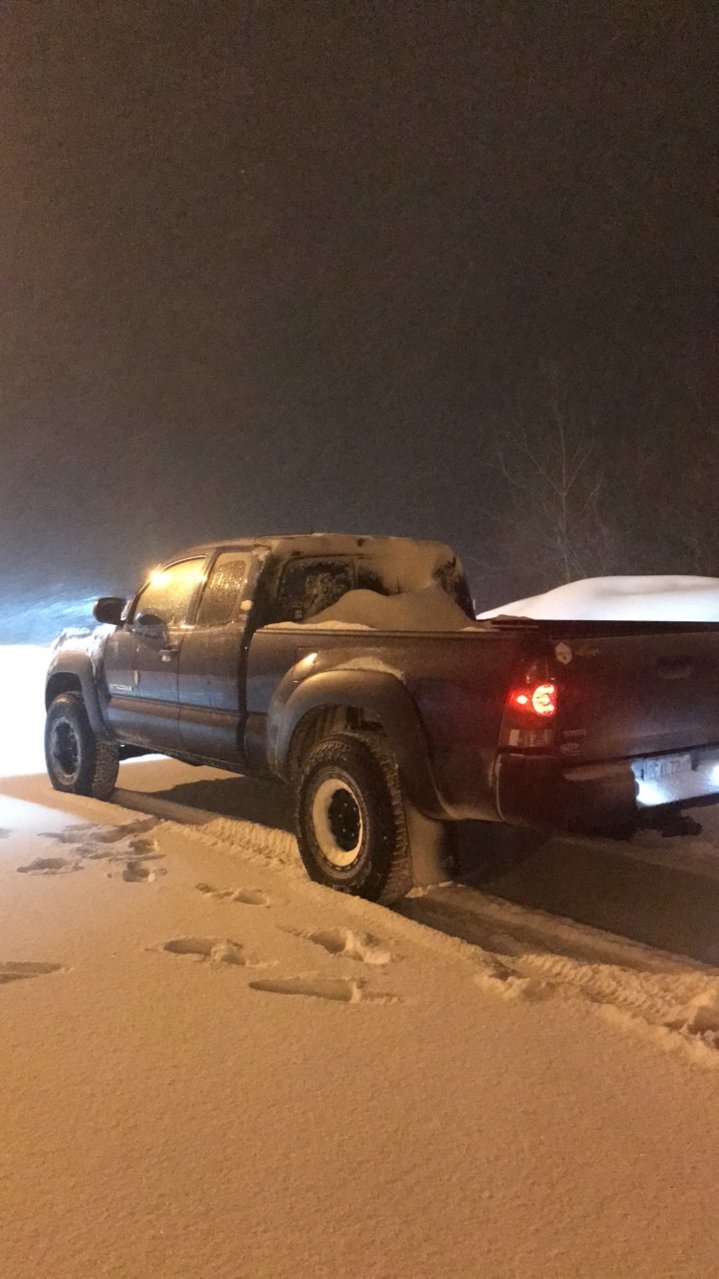

    Favorite picture of the truck.
    A post rain storm night in Montana on the backside of glacier national park.

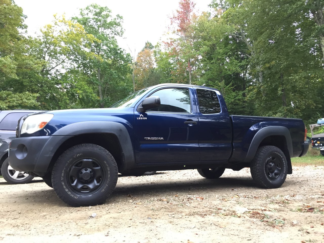

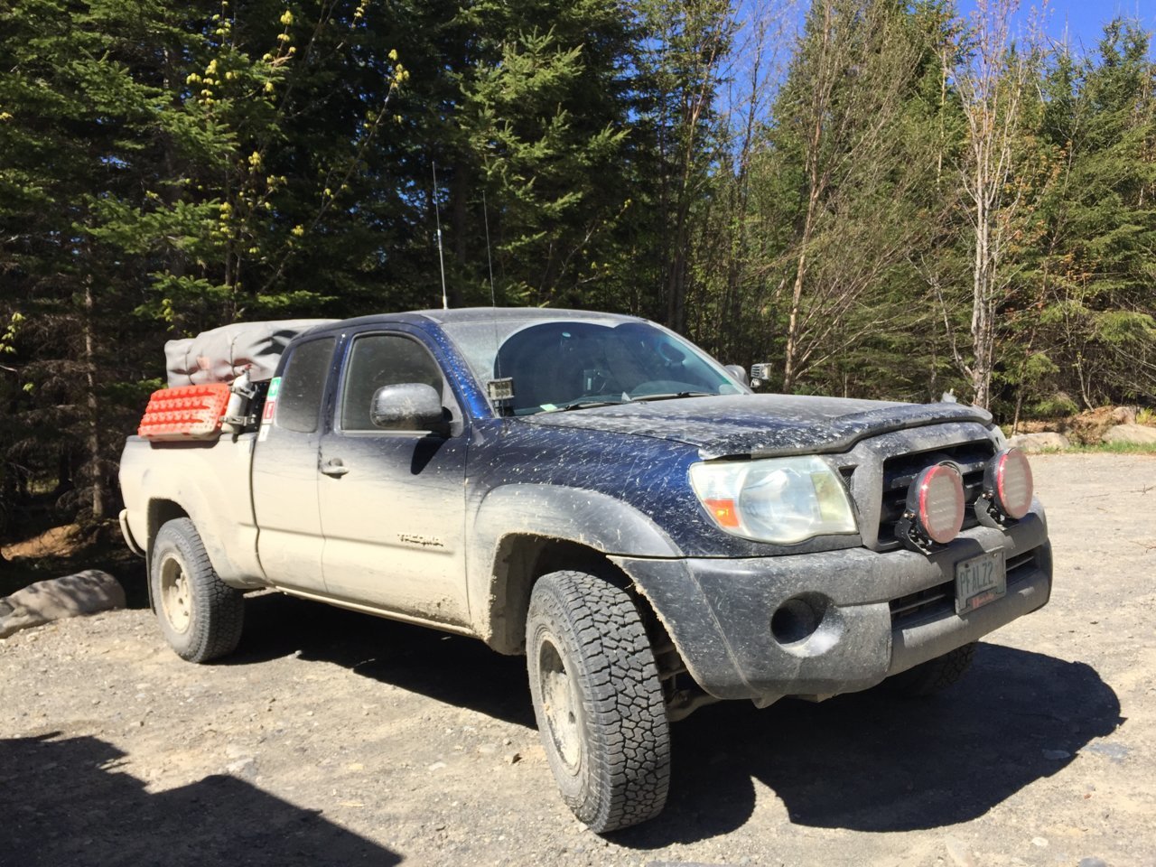

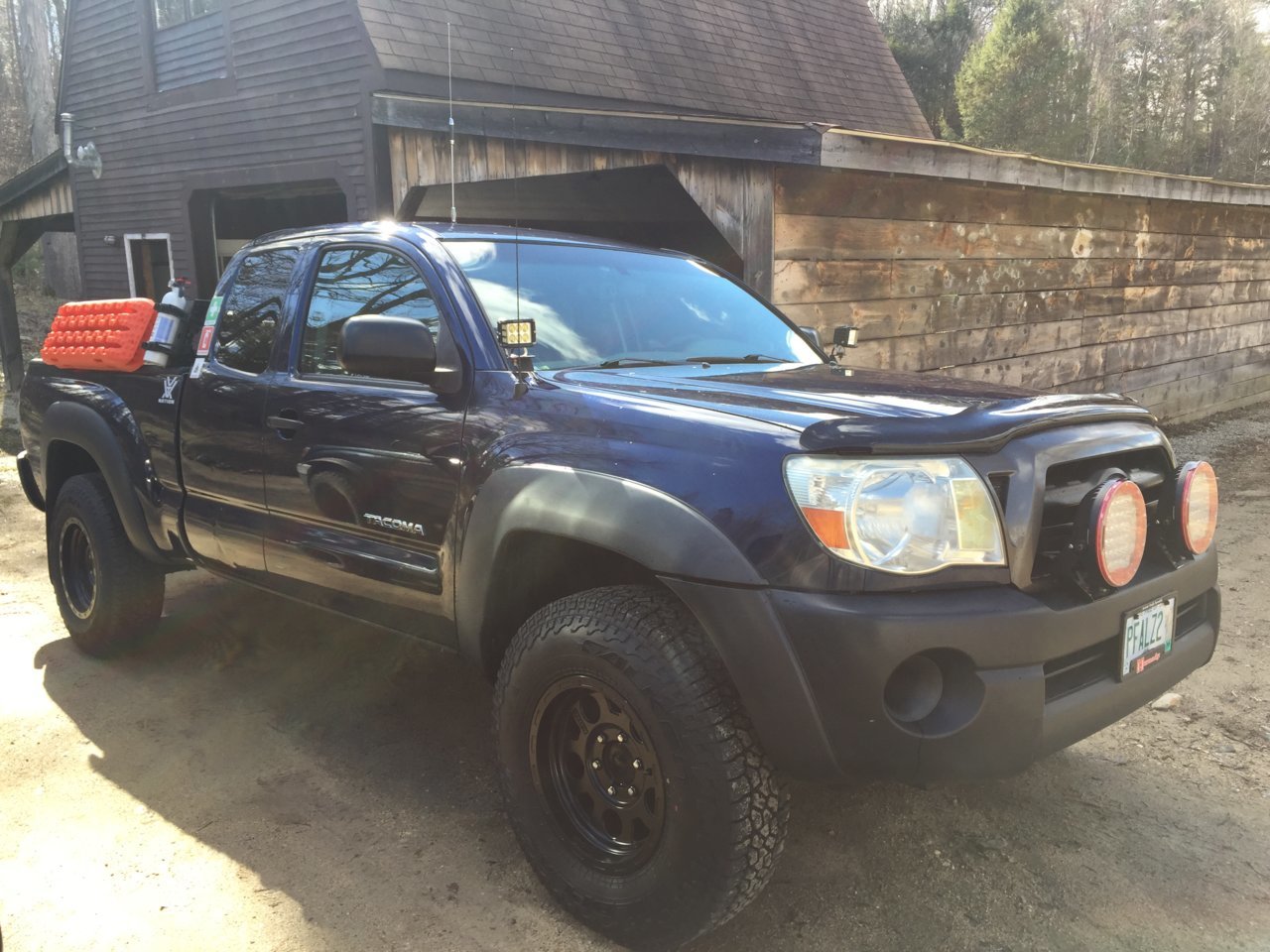

    This is what the truck looked like when I bought it. 162xxx miles on the clock.

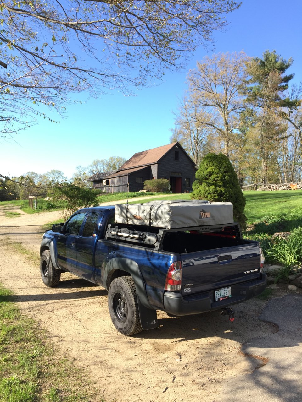

    I was able to buy a used Tepui Kukenam RTT, and home made rack
    Love the tent but the rack, while well built, was too high for me...the tent sat 1ft above the cab and I wanted the best possible mpg for my trip and that meant low weight and no drag.

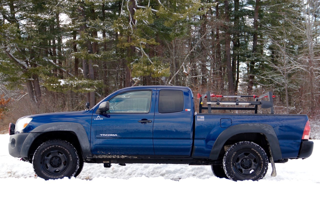

    bought a voodoo short rack off of someone on TW and sold the other rack. This made things tighter in the bed but it dropped the tent way down giving me the look and performance I was looking for. The Vodoo rack was also more modular as well as lighter.
    I also added some bed stiffeners and changed out lic plate, reverse, and interior lights to led's. Went with a red bulb on one side for night driving....hands down one of the best mods I've made.

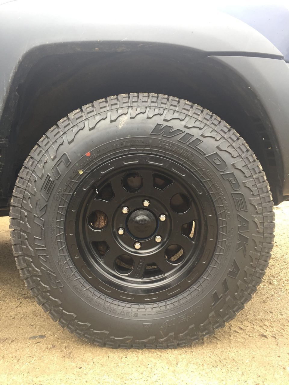

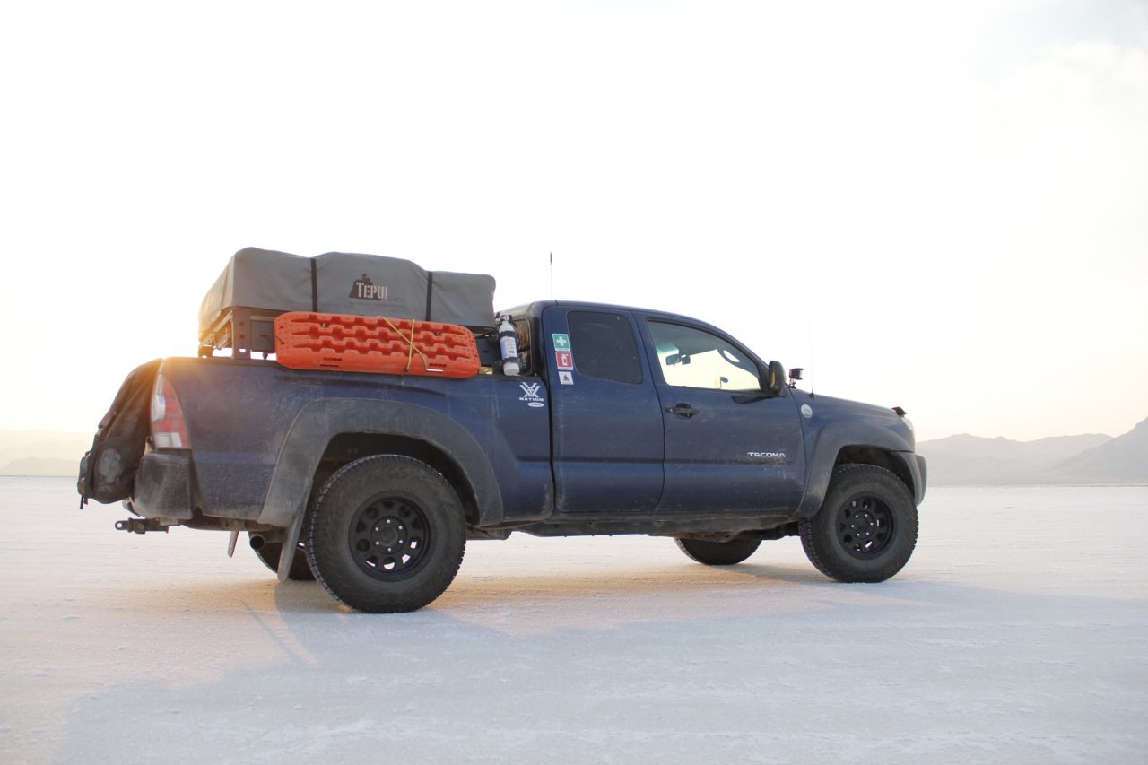

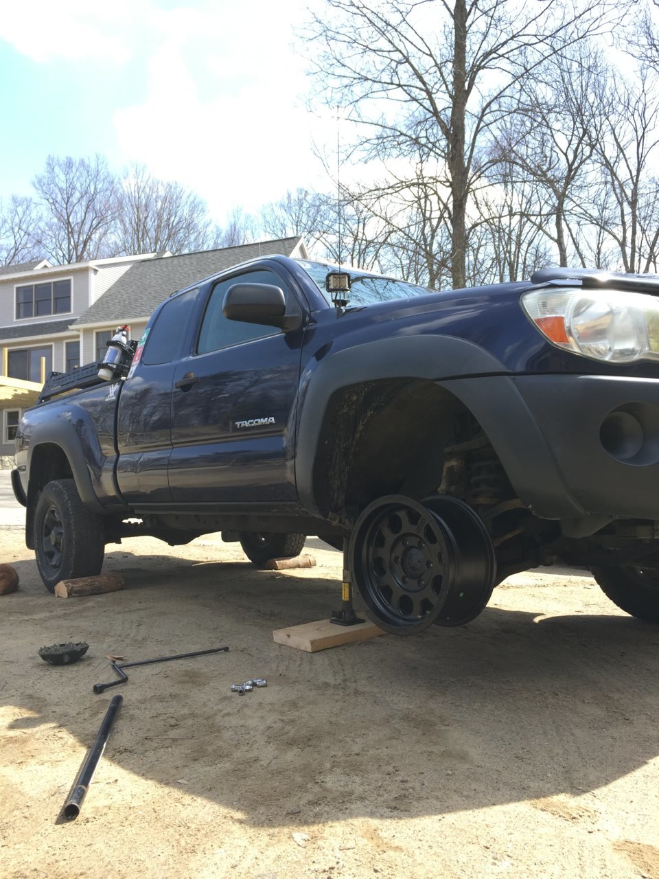

    I knew I wanted new wheels and tires for the trip. I found some KMC enduro wheels which were significantly lighter than my steelies and went with a 235/85/16 falken wild peak. I wanted an E rated tire (because of the rds in Maine I frequent) but wanted to offset the weight as much as possible. Im super happy with how the setup has performed and am happy to say that I did not notice a change in MPG coming from 245s. I get 20-23 in the summer and 18-20 in the winter.
    I did have to do some "trimming" with a heat gun on the front as the tires rubbed on the plastic when in reverse at full turn.

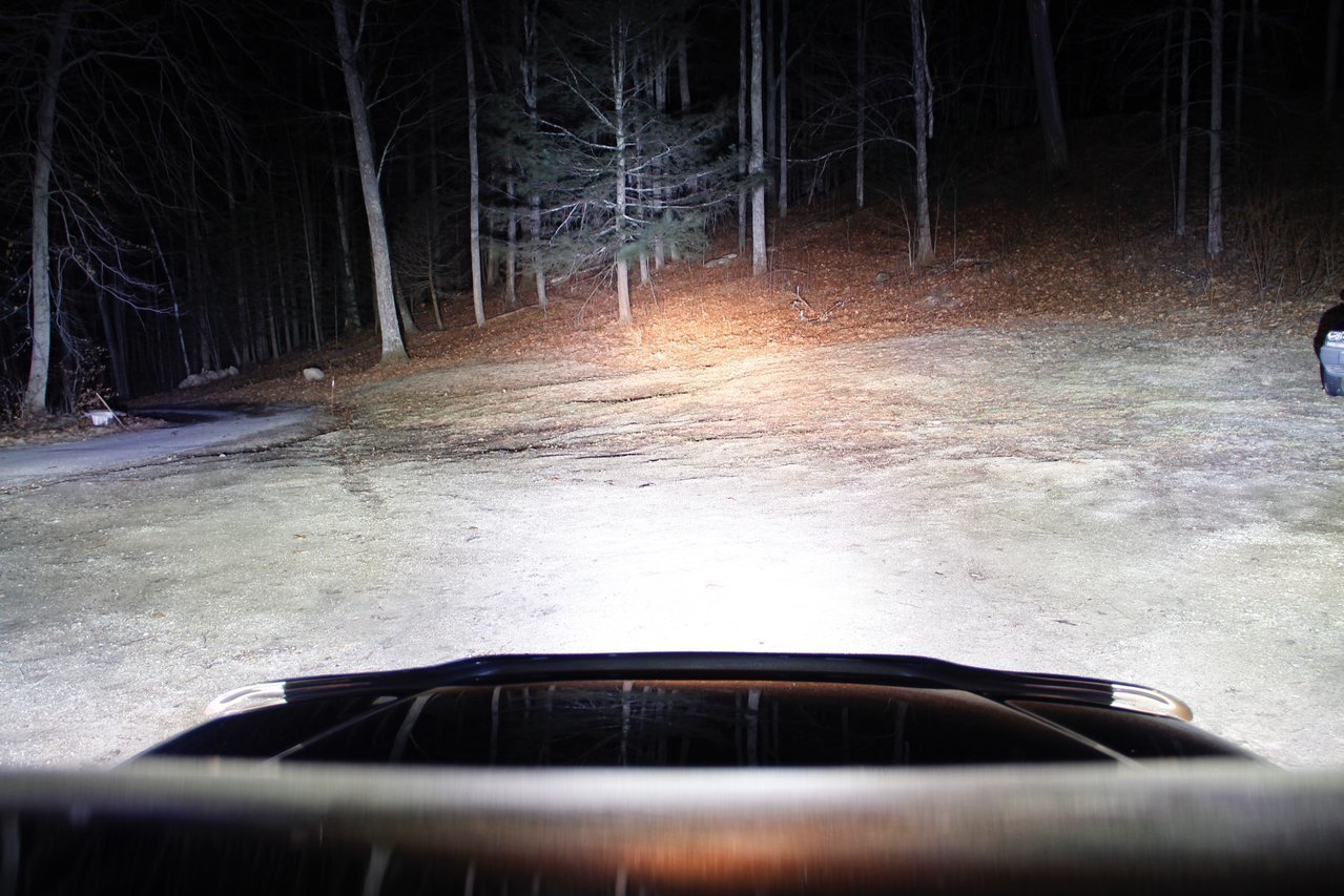

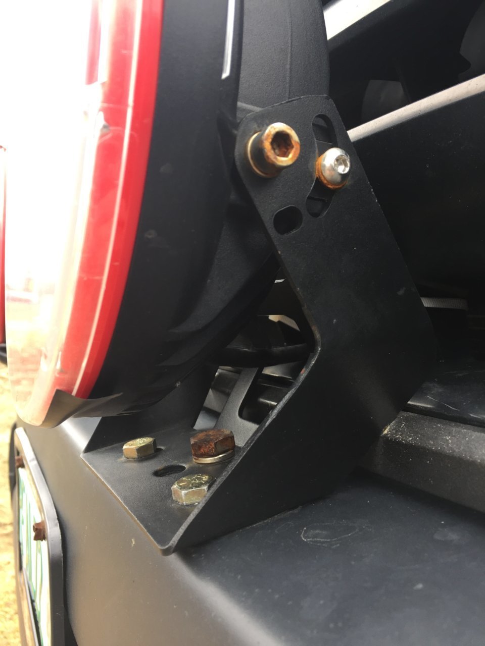

    LIGHTS! before I forget lights.... I wanted some offroad illumination but am not a huge fan of light bars....everyone and their mother has one and I reeally like the look of the round lights on the ARB bumpers....I didn't want to get a bumpers at that point (weight and money) and opted to attach them to what I had for a bumper. pretty happy with the result! also installed side shooter light on cali raised ditch brackets and a bed light. everything is wired to a Sui-tech switch panel inside.
    regular low beams:
    ditch lights plus round driving lights:

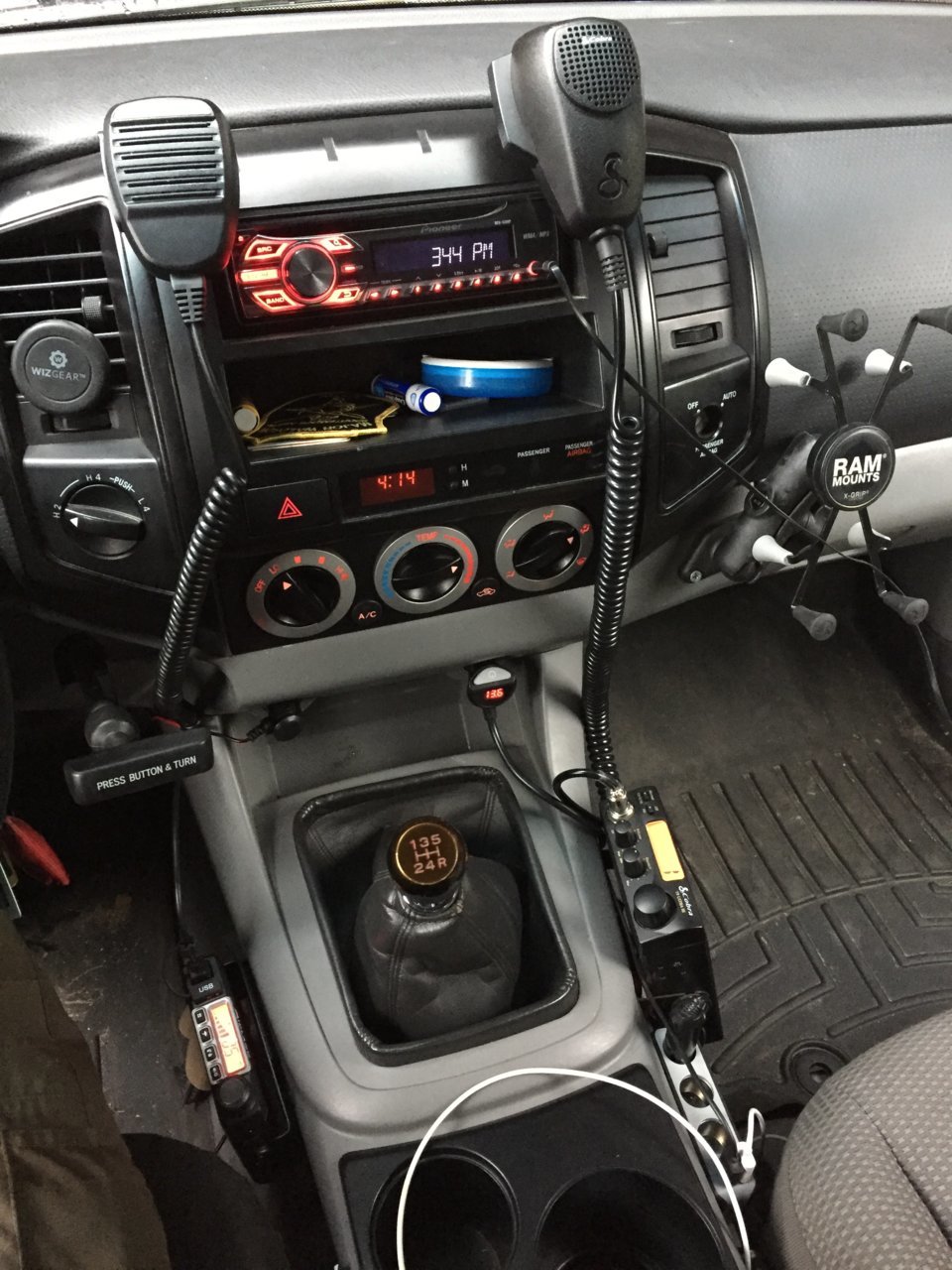

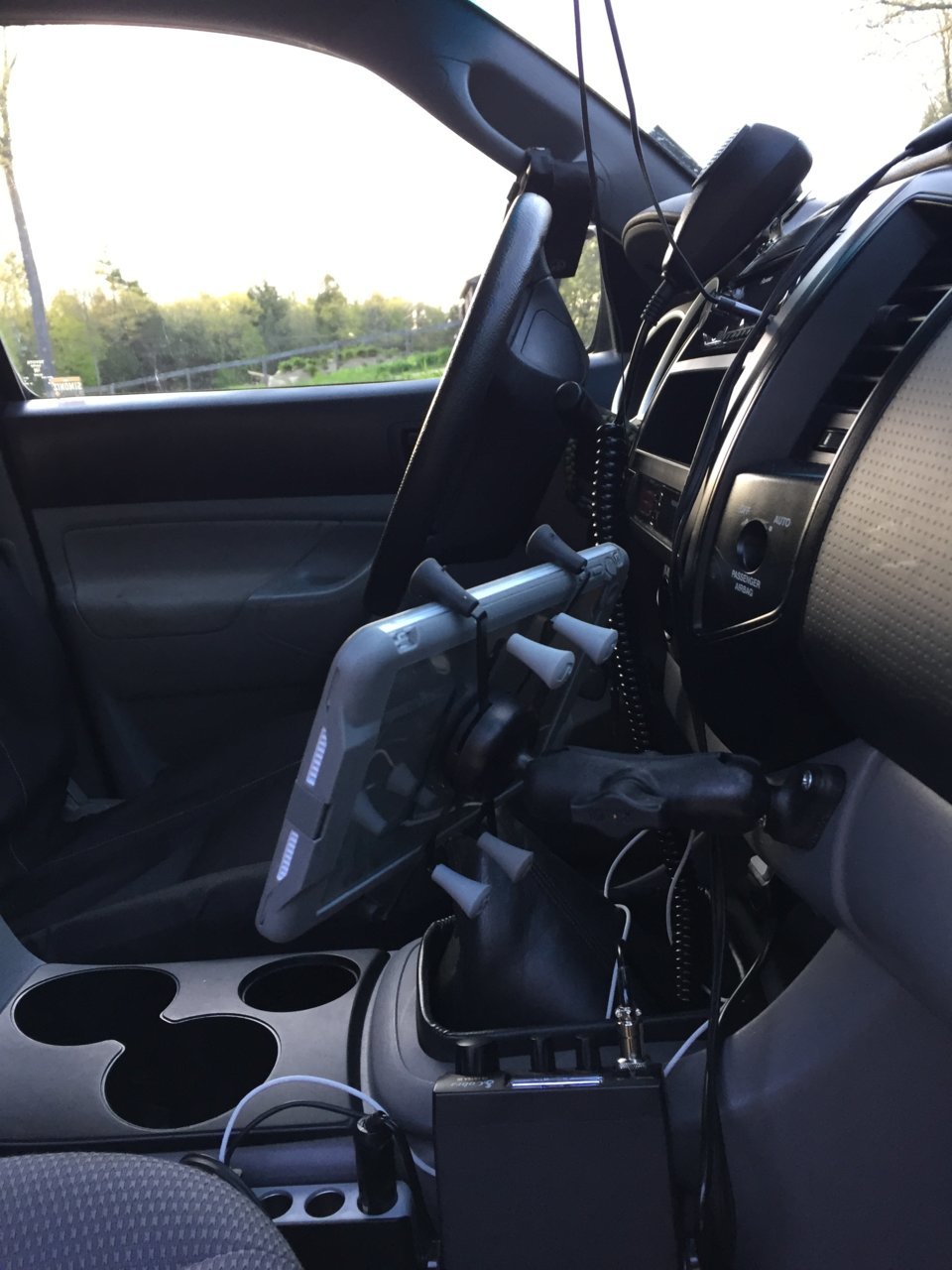

    added a dash cam, Ram mount for an iPad mini for navigation, new single din radio (mostly for the aux cord). also added an inverter next to the passender seat and a little 12v, usb bank with a battery monitor.
    Also added a CB radio and a Midland GMRS 115.

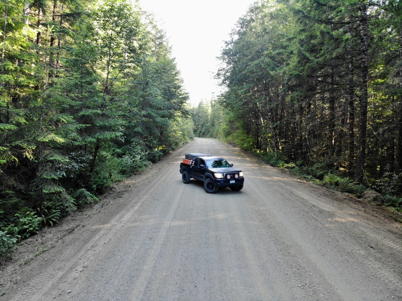

    Took a trial run up to northern Maine and got the truck super dirty... everything performed well... although I realized I wanted more room for the tires and better springs in the back.

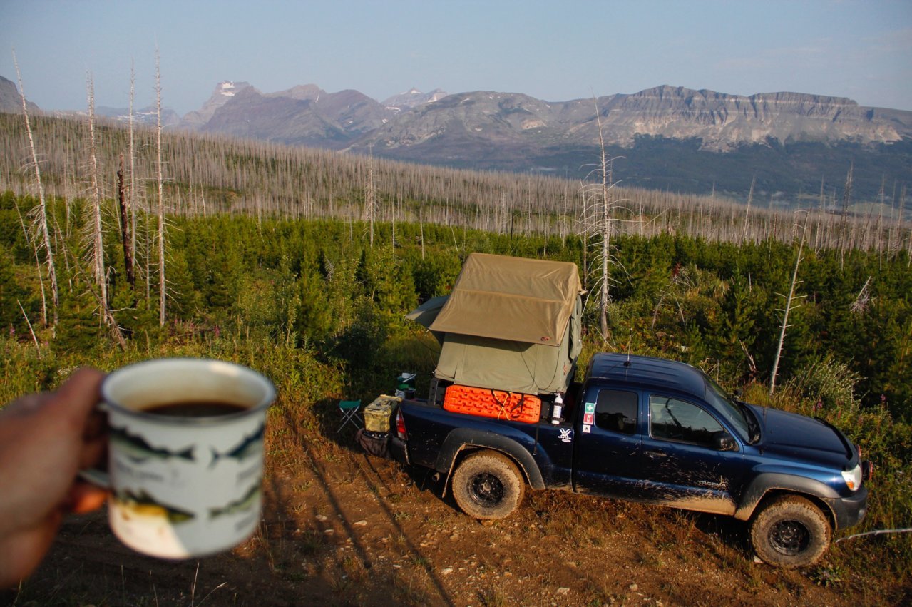

    Then came a the trip...plans for the summer got bigger and bigger until I ended up with two buddies (one on the way out and one on the way back), a 2 month time slot, and a route to take me from NH through the midwest to CO, all around Utah, Idaho, Arizona, into Cali...up the west coast into B.C. and then into Alberta...then down through Montana, and Wyoming, back into CO and then back to NH. Camping every. single. night. The trip was epic and I'll include pictures below! If you have any questions, I can be much more specific regarding what we did! we put right around 10k on the truck.

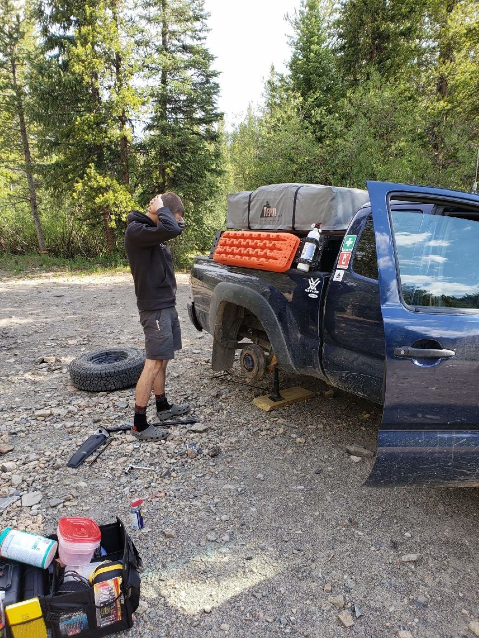

    First and only issue I ran into was a seized parking brake in the back country in CO. nerve-racking because the truck wouldn't move and we were in the middle of nowhere but ultimately nothing that some banging not the brake drum didn't fix...

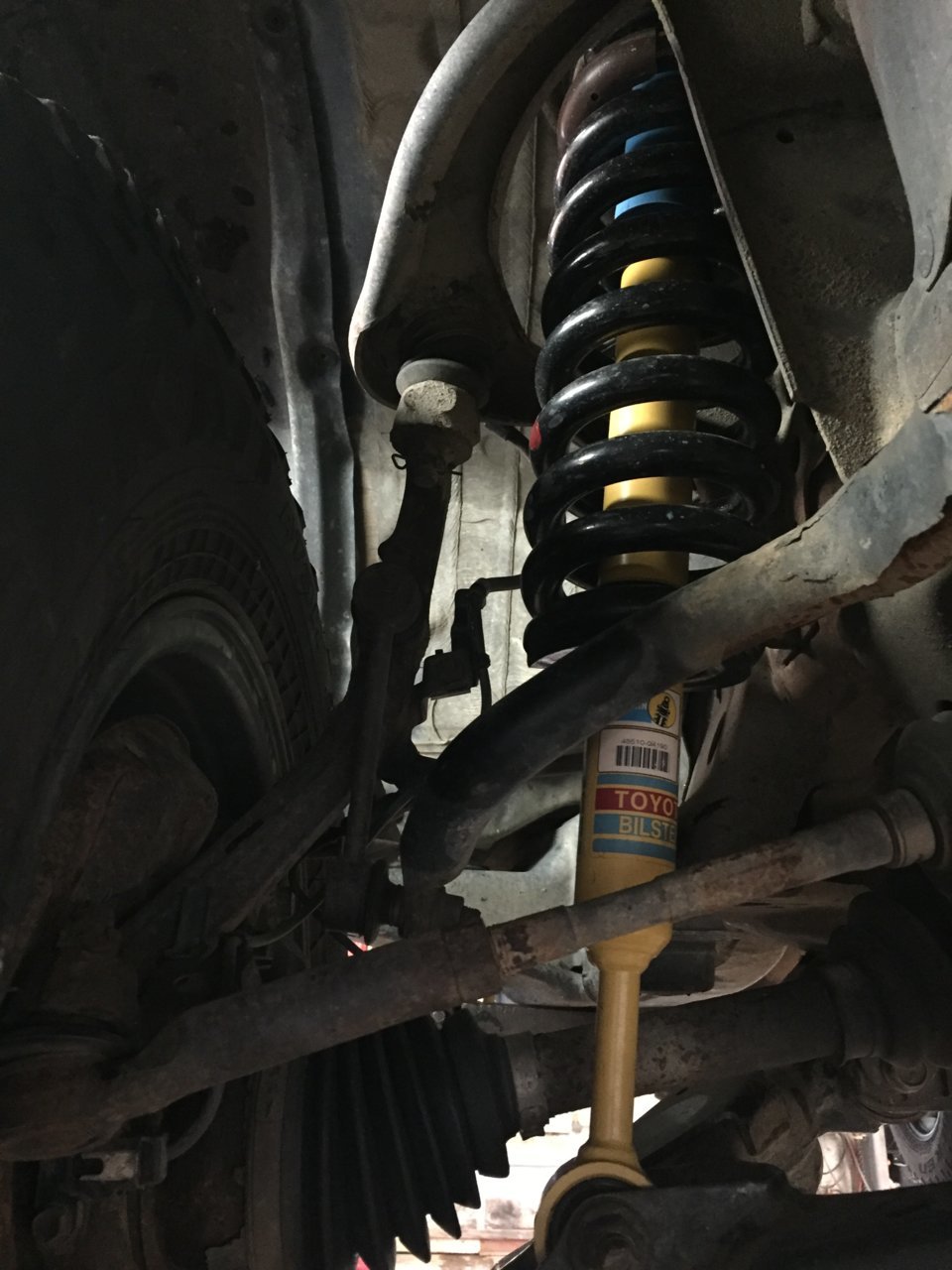

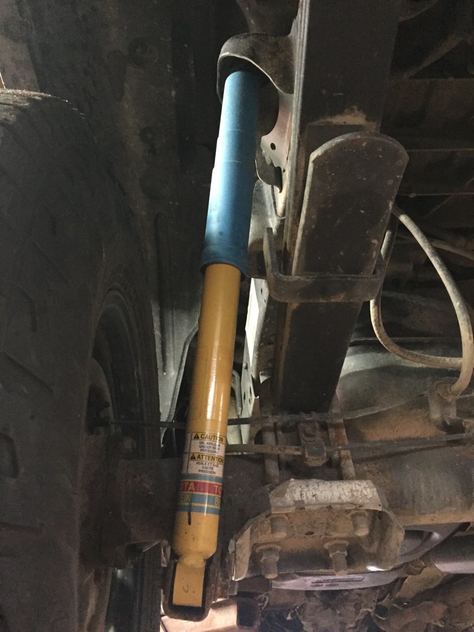

    After returning from the trip I was well aware of how tired the factory suspension was. I didn't want a 3 inch lift because of the potential issues that can come with that (vibration, mpg decrease etc) so I opted for a 2018 TRD Off road "take off" set. The heavier coils lift the front by about an inch and the ride is about a million times better than stock. "taco lean" is already adjusted for and all I need to do now is slap on an AAL to support the weight in the bed and give me a level look....leaning towards the ICON 1.5, coming this spring.

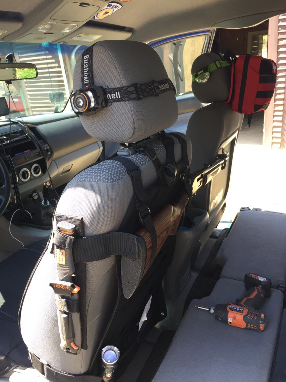

    also have plans for a rifle rack in the truck... Expedition overland has one in one of their Tacomas mounted on the ceiling inside but I haven't figured out how I want that to work, and don't want something lacking me in the back of the head in an accident...this is the solution for now...

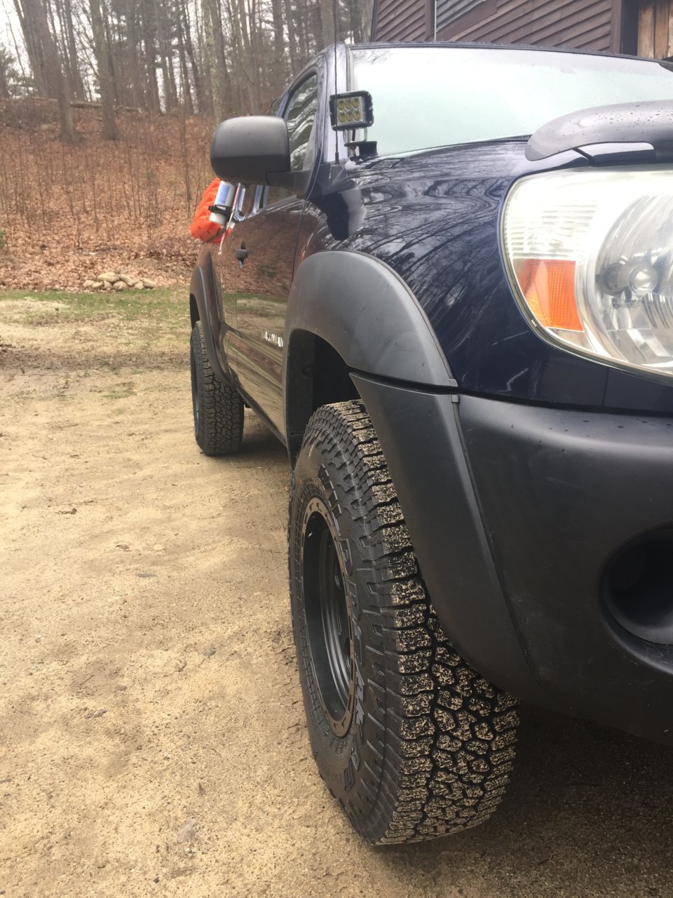

    I did a ton of research and you'll see pics and reviews of the tires of mine on threads like "the skinny on skinny tires". They cut through snow and mud super well, are really comfortable aired down, and I really like the look. (hard to notice unless side by side with another tacoma)
