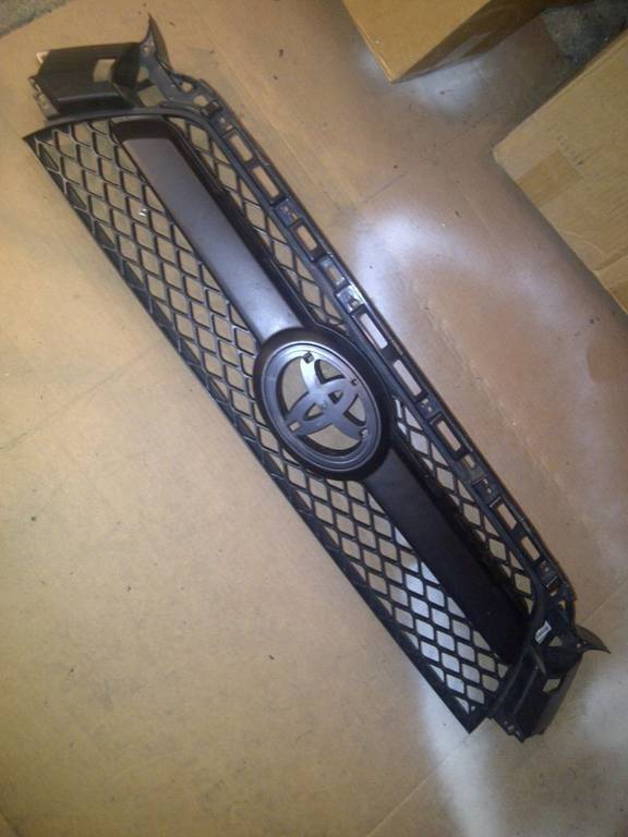

    got a 5th Gen grill to try...
    more to come...

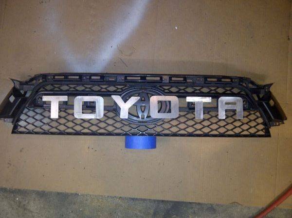

    sized up some smaller "raptor" style letters...
    Gutted the center:
    My goal is to create an insert kit for this - much like my thought process with the FJ grill I still have not completed... :eek:
    Not sure where it's going but its going. :rolleyes:

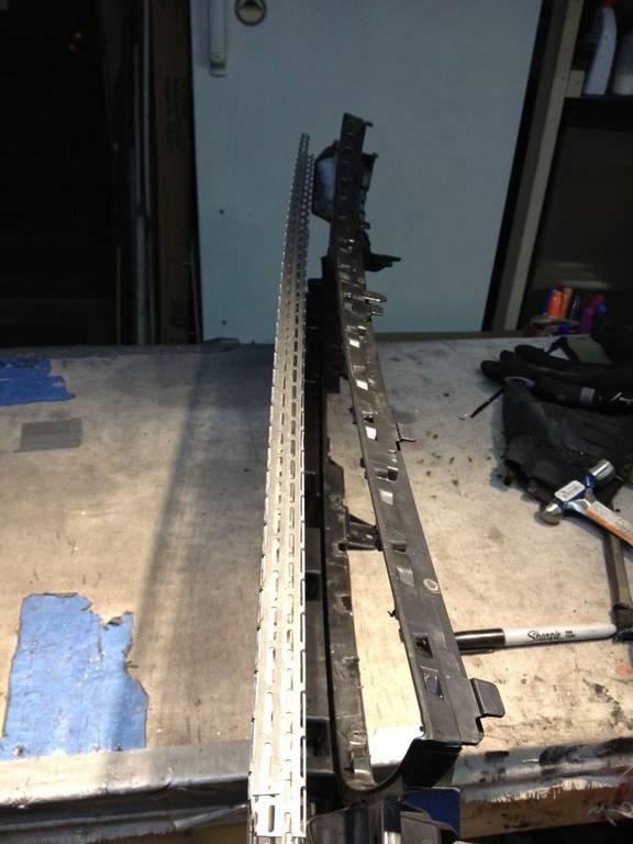

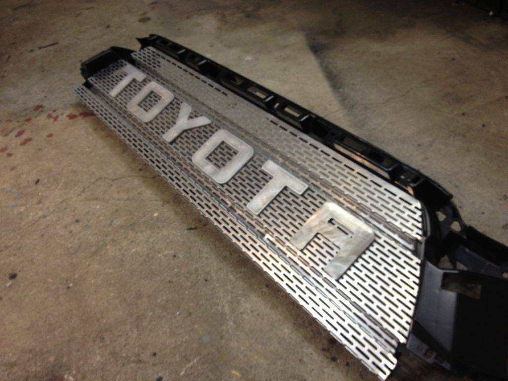

    Time for an update...

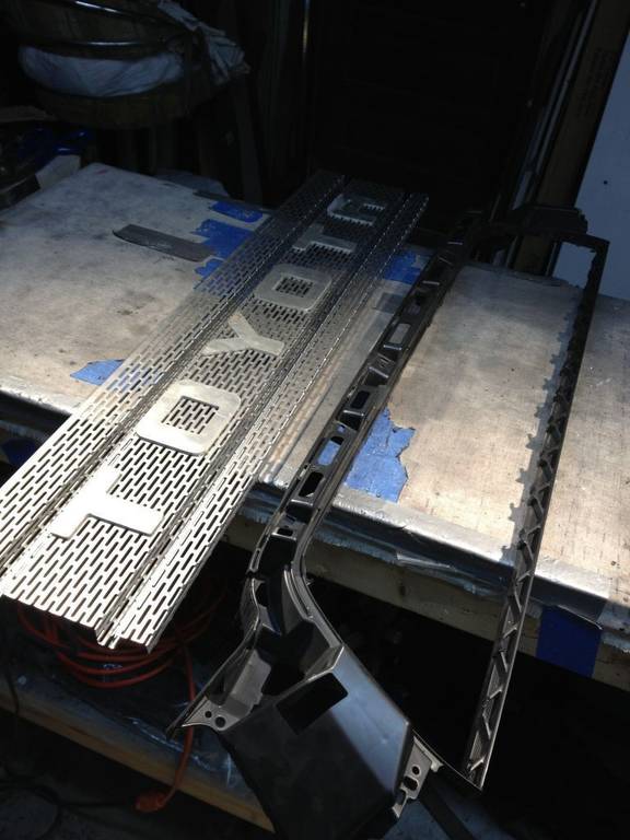

    Here is the prototype mesh... I was finally able to work out the slots for the smaller letters. This was very difficult due to my equipment limitations.:(
    Here is my next obstacle:
    As you can see the bottom of the grill has a very pronounced outward bow. On the Tacoma grills I can simply modify the cut of the surround to accept the flatter mesh but with this I need to make the mesh fit the surround as is or I'm stuck. :(
    I cannot simply bend it this way since the slots make the mesh very rigid.
    Here is what I get when I try to make it conform:
    Tough to see but the back of the slotted section is buckling... :frusty:
    This is going to take a while longer to work out I'm afraid...
    Bear with me. :eek:
