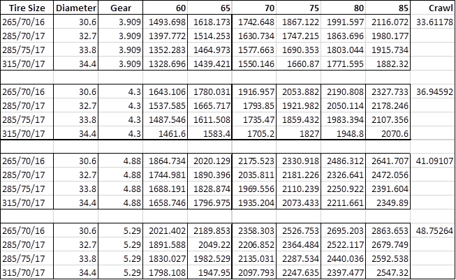

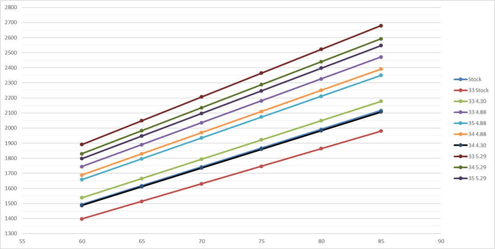

    Check my math but should be good for AT.
    glockman, Muajilong, Tacomod and 5 others like this.

    Auto here, and ideally I think maintaining 2200-2300 RPM seems the sweet spot. I'm tuned, and it does make power at 2200RPM on the hwy.

    Ahhh yes you're correct. I missed the MT in his posts.
    The 5.29 are quite appealing, I just don't want to over gear it.
