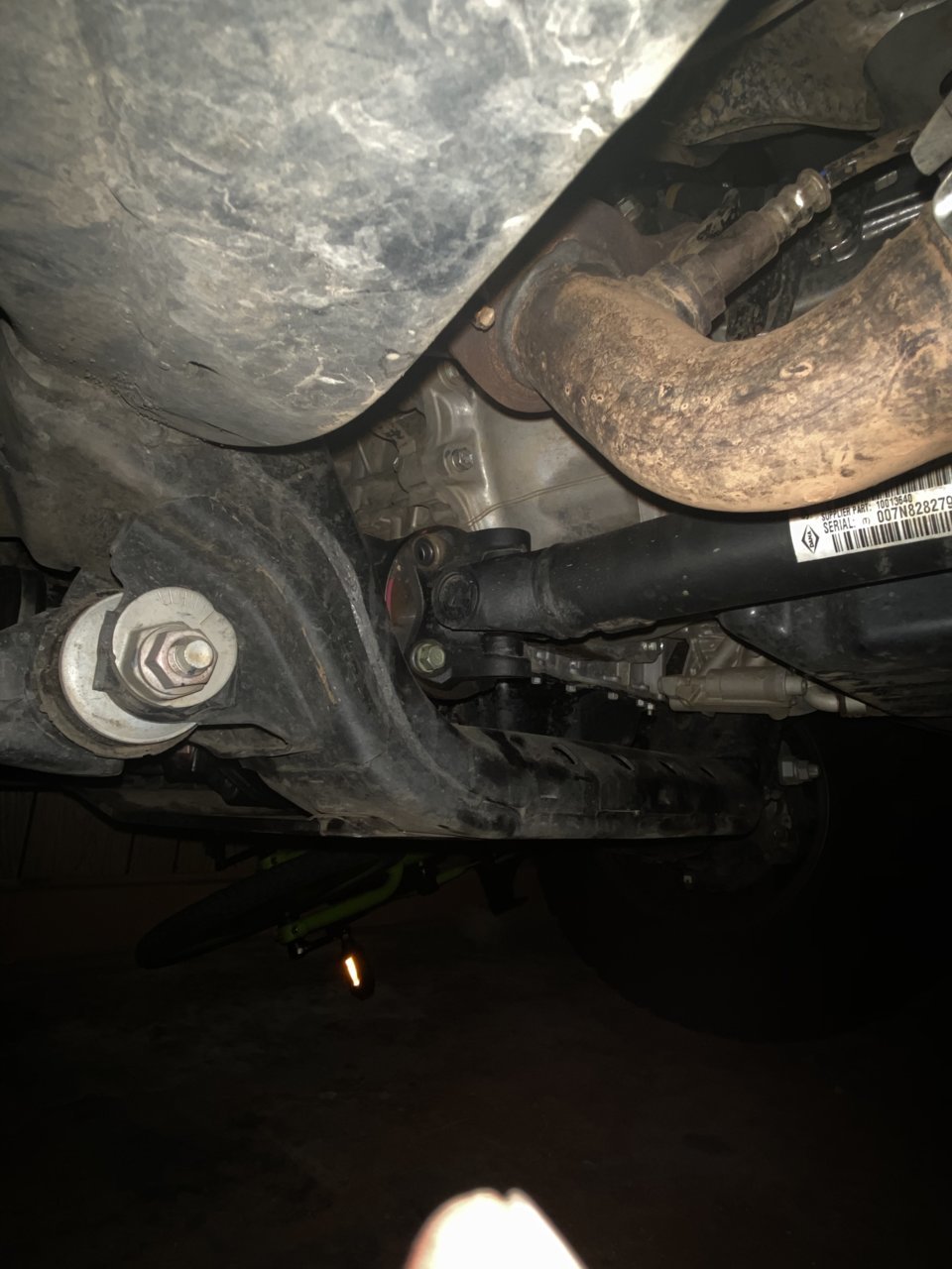

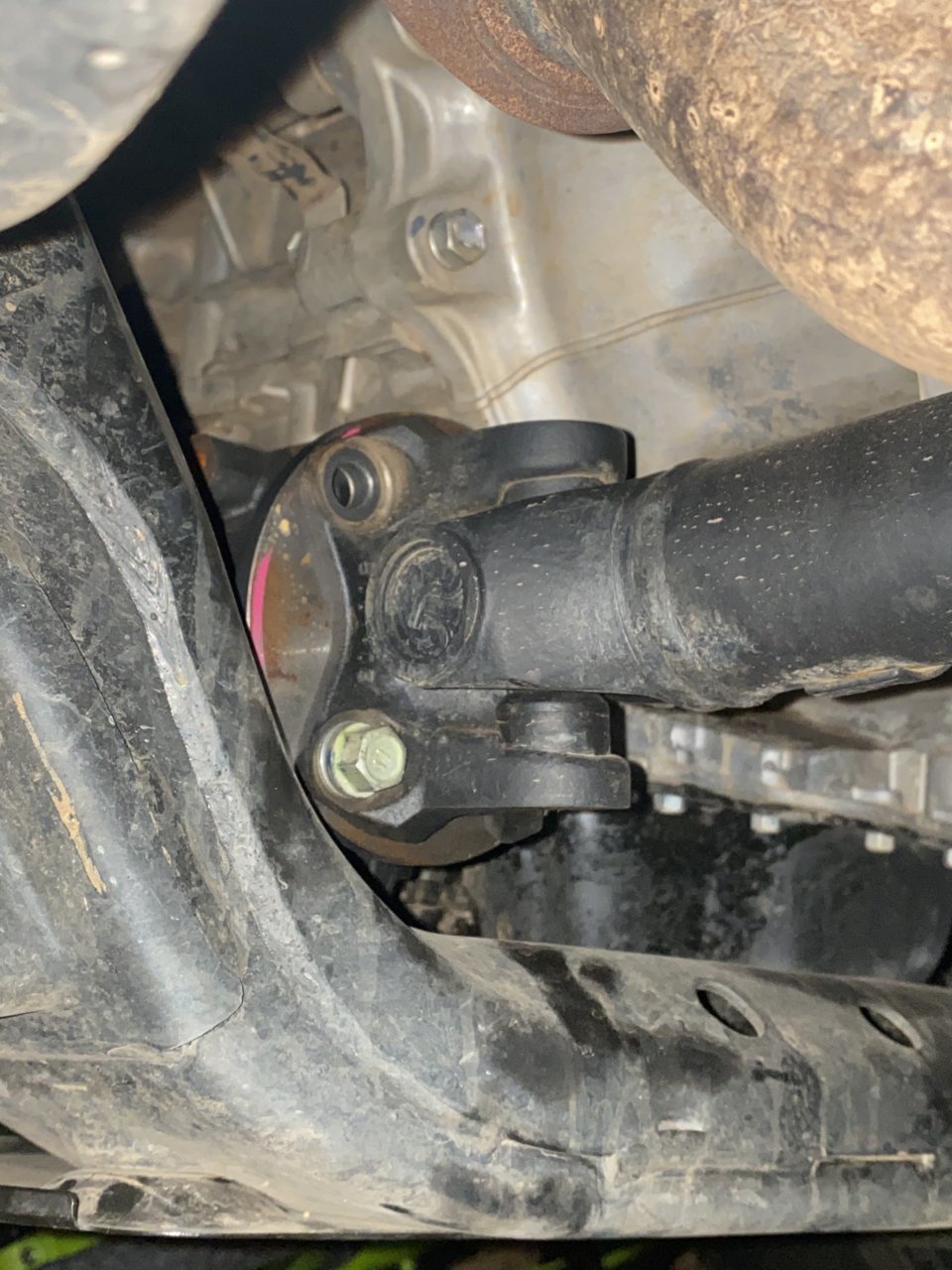

    So the last few days I’ve been feeling some vibrations when I take my foot off the pedal and coast between 40-50. I’ve been considering maybe it was the needle bearing. Well tonight while driving home I’m pretty sure I heard this bolt coming out and falling out. I believe this is the yoke flange? It goes it to the front differential? So the guys who installed my gears likely didn’t torque them down correctly or forgot one... :annoyed: I’m going to make the drive to the deAler and get that bolt. Anyone know the torque spec on it? I’m assuming with 3 other bolts still in there sAfe to drive? U guys think that could’ve been the reason for feeling those vibes?

    Spec is 63ft#'s

    thanks man.

    Also, washer goes on bolt side, not nut side.

    I'd be a leetle cranky and suspicious of the installer. Check other bolts minimum.

    I know I am... going to make sure the rest are torqued down and check all the plugs on the diff
