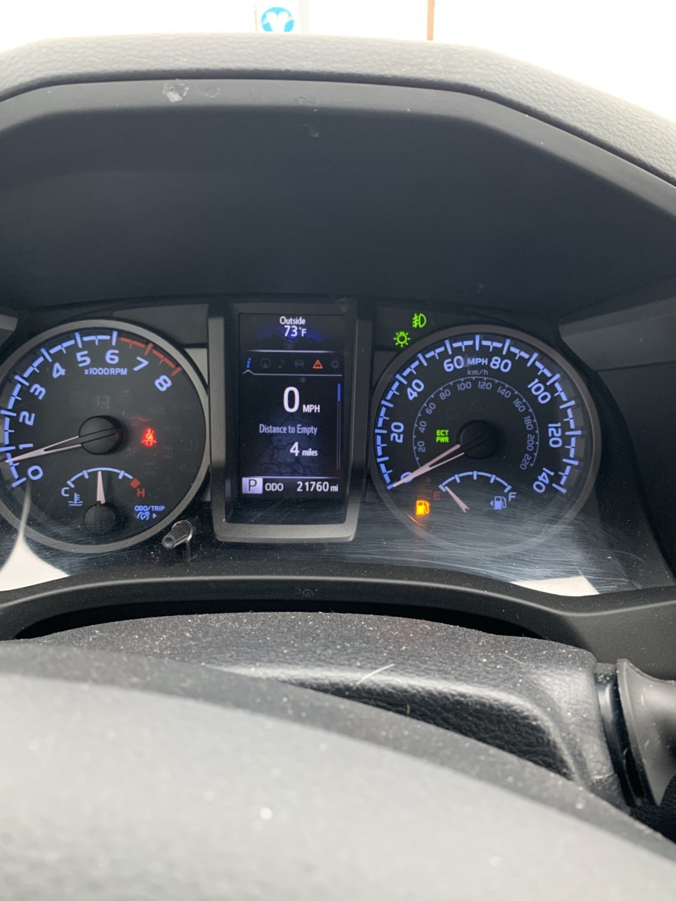

    After the computer said that my range to empty was zero, it went another 50 miles before sputtering

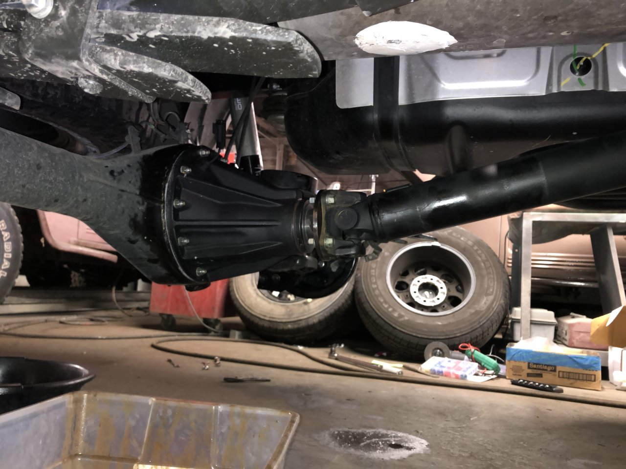

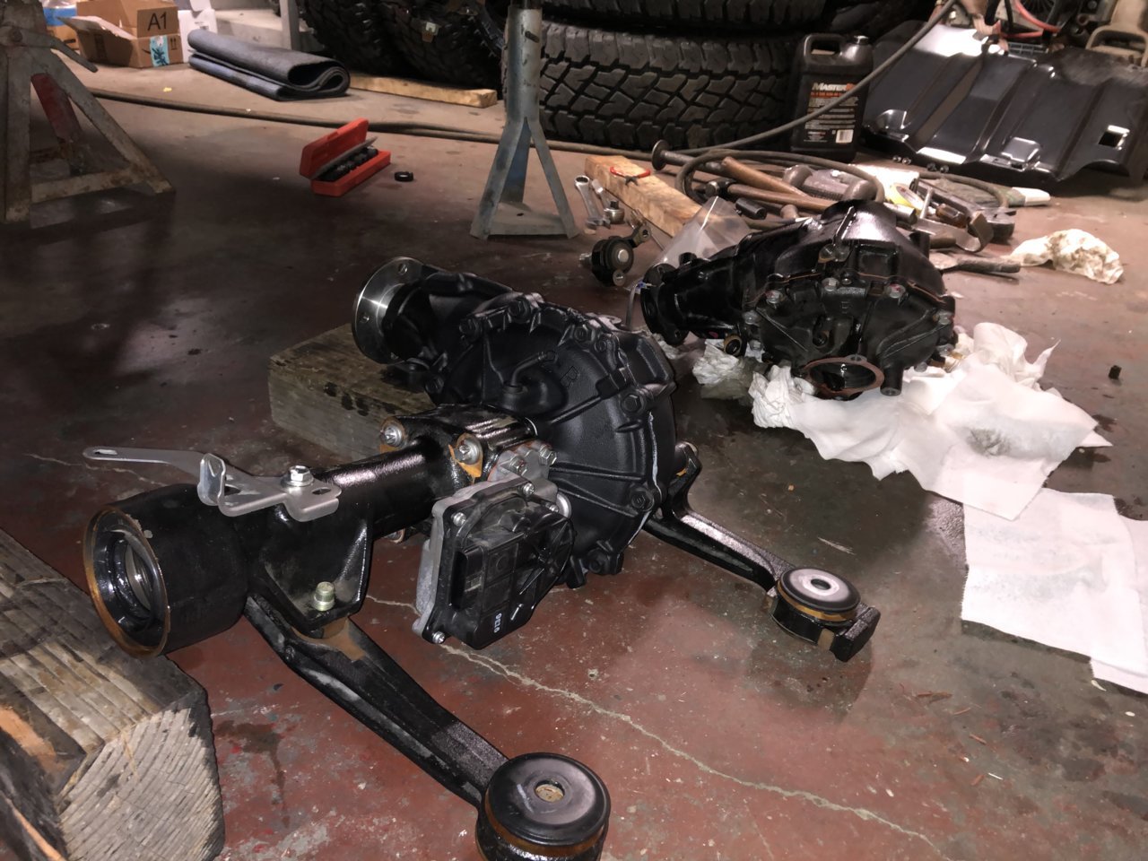

    Got the rear back in, just have to torque the drive shaft and bleed the brakes. Front clam all assembled and ready to go in Tommorrow.
    Should be back on the road feeling the 5.29’s Tommorrow.

    bk3002 - awesome work and photos!!

    Just wanted to let y'all know I average anywhere from 7mph (in the mountains) to 12mph (on a flat surface w/ a tail wind). I definitely wouldn't advise trusting the computers distance to empty....cut it way to close at one point in West Texas. I had less than 1/4 of a gallon left.

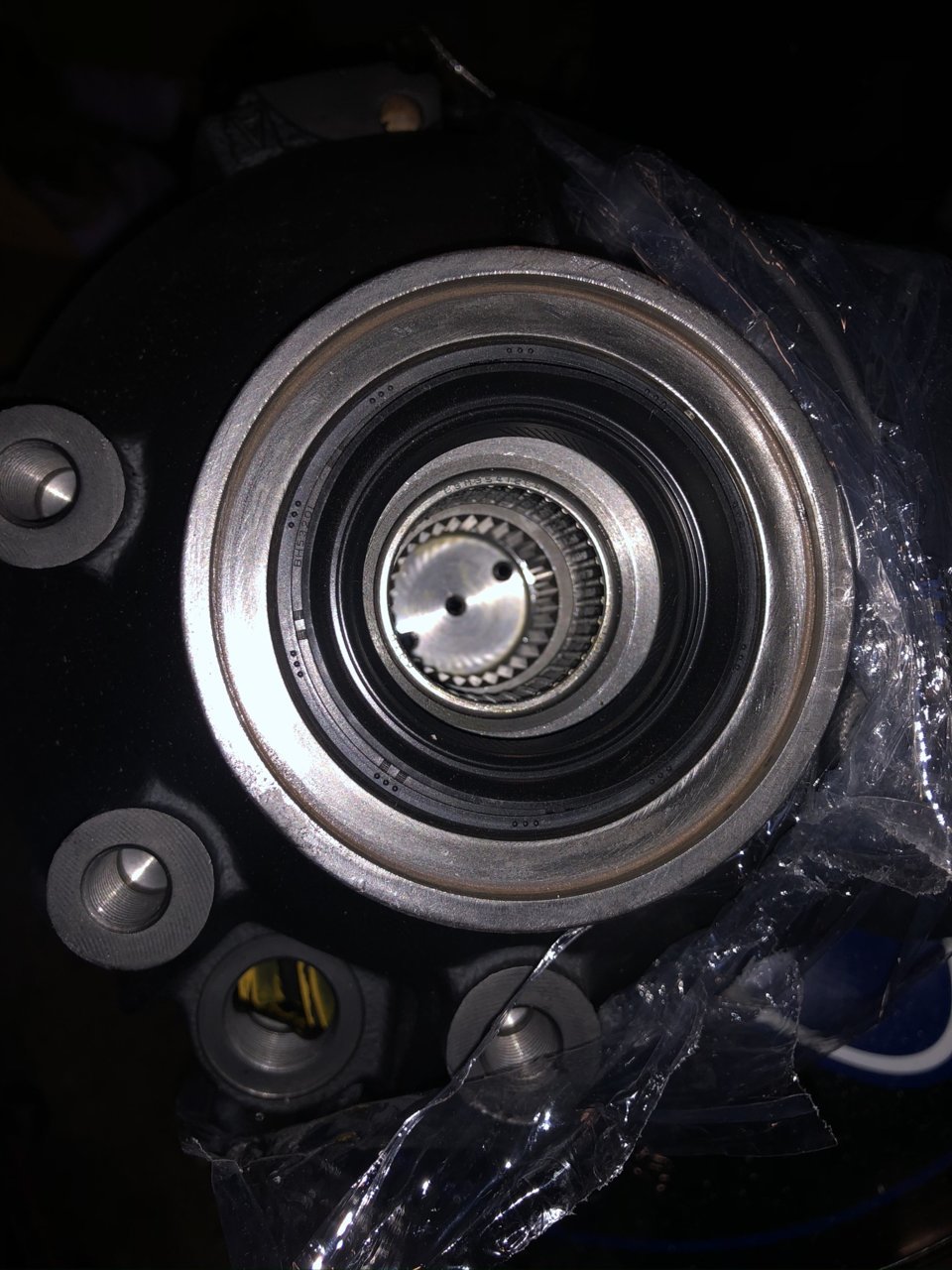

    took it on just a couple drives. Alignment feels good but might have to play with it a tad more. The cv shaft on the drivers side play that I was worried about is gone with the new Harrop. Driving wise around town it was hard to tell a difference. I’m jumping straight from stock to 33’s and 5.29 only drove on the 33’s twice before the regear for maybe 5 miles total.
