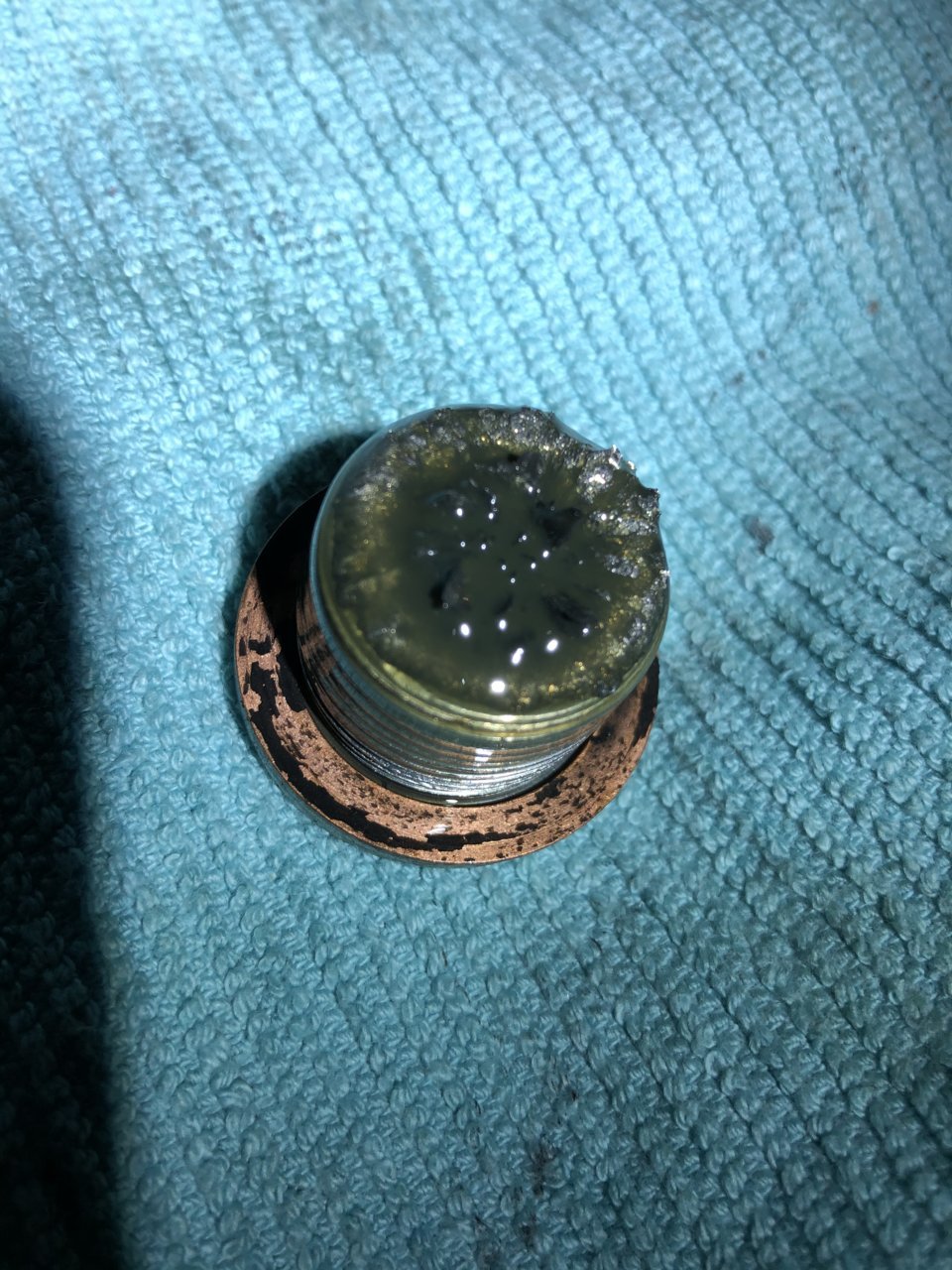

    Drained both diffs last night after hitting the 500 mile mark on both front and rear. No big chunks just tons of shavings which is a good sign. New oil in and will prolly do another flush next oil change just to be safe.
    here’s the front plug with tons of shavings which was the worse of the two. The front holds a lot less oil so the shavings were more concentrated. At first when I saw this plug I thought those were solid chunks of metal but after clearing them just tons and tons of ultra fine shavings.
    what do you guys think? Think this amount of shavings is normal or of any concern?

    I’m no expert but it looks like a small amount of polishing dust. I would say the break in was successful. Everything is mating perfectly and all the burrs etc are polished out.
