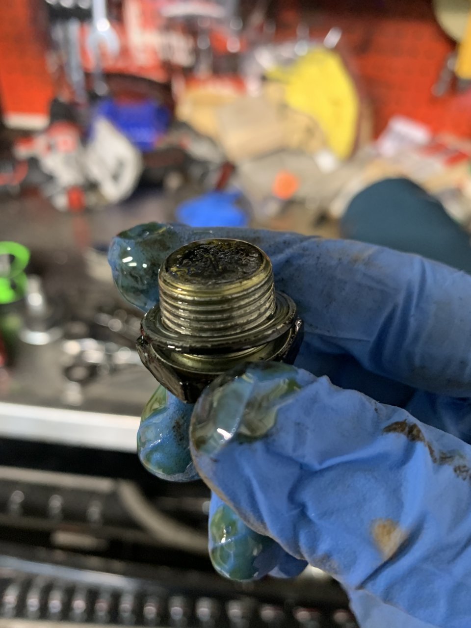

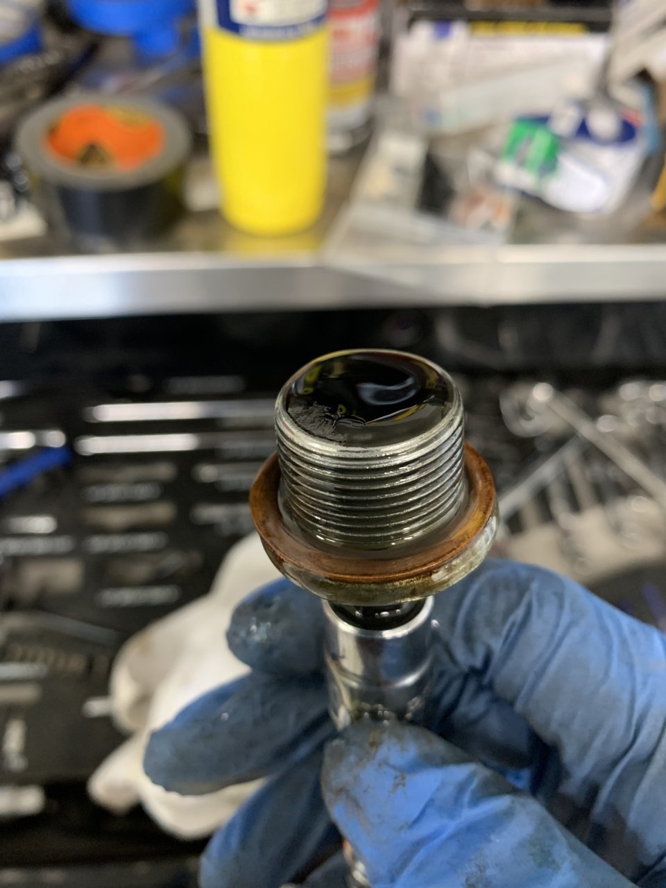

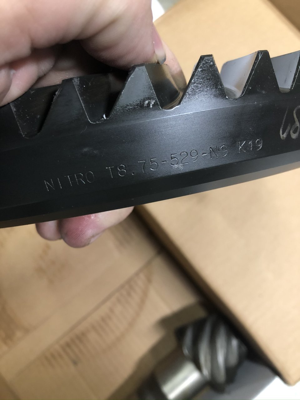

    Yes, that looks right. It's also normal that the front end had less shavings. You shouldn't need to change the diff oil for another 15k miles.

    Mine had a bit less and looked finer. But hard to compare to a photo. Frankly I don't see anything to worry about.

    my front end actually seemed to have a bit more shavings. I double checked the used oil last night to see if I missed anything. It’s black with no metal chunks at all in it.

    When you say “shavings” do you mean curly cues of metal or a fine paste?

    The front actually had more ultra fine metal paste. the rear had more ultra fine shavings. No curly's or anything larger than very fine pieces, but mostly fine paste.

    Mine had very little paste on it. Brian is the best.

    Likewise, mine had almost nothing!

    That's amazing how much less yours has than mine. are you using nitro gears? any rem polishing?

    Mine were REMd which helped. Brian is also a surgeon with gears.

    No rem on mine and nitro yes
