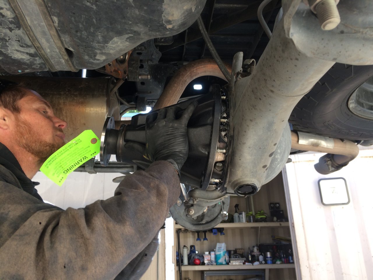

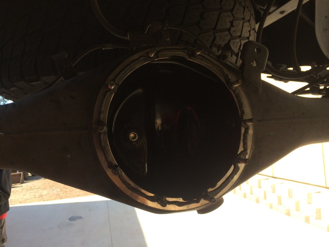

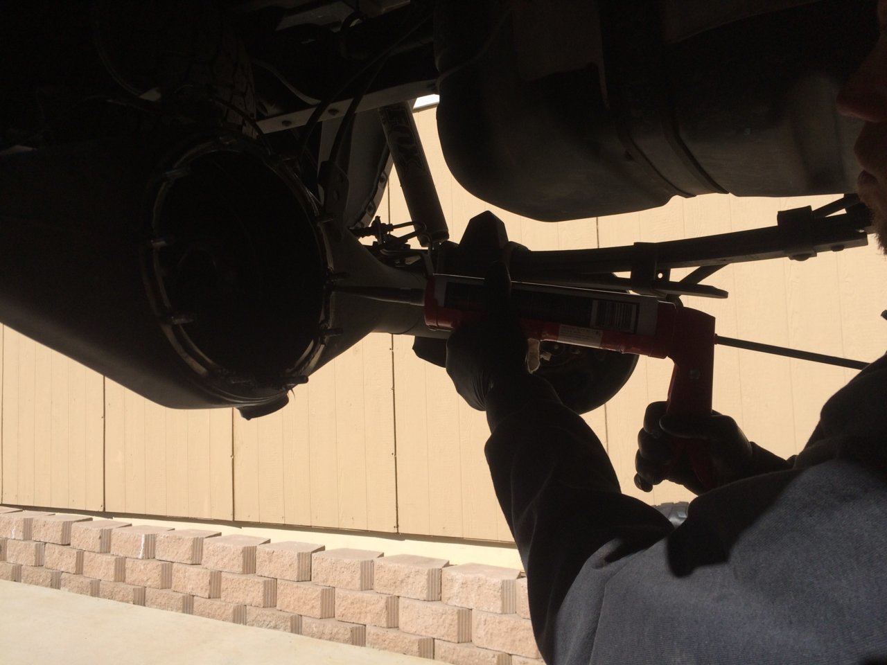

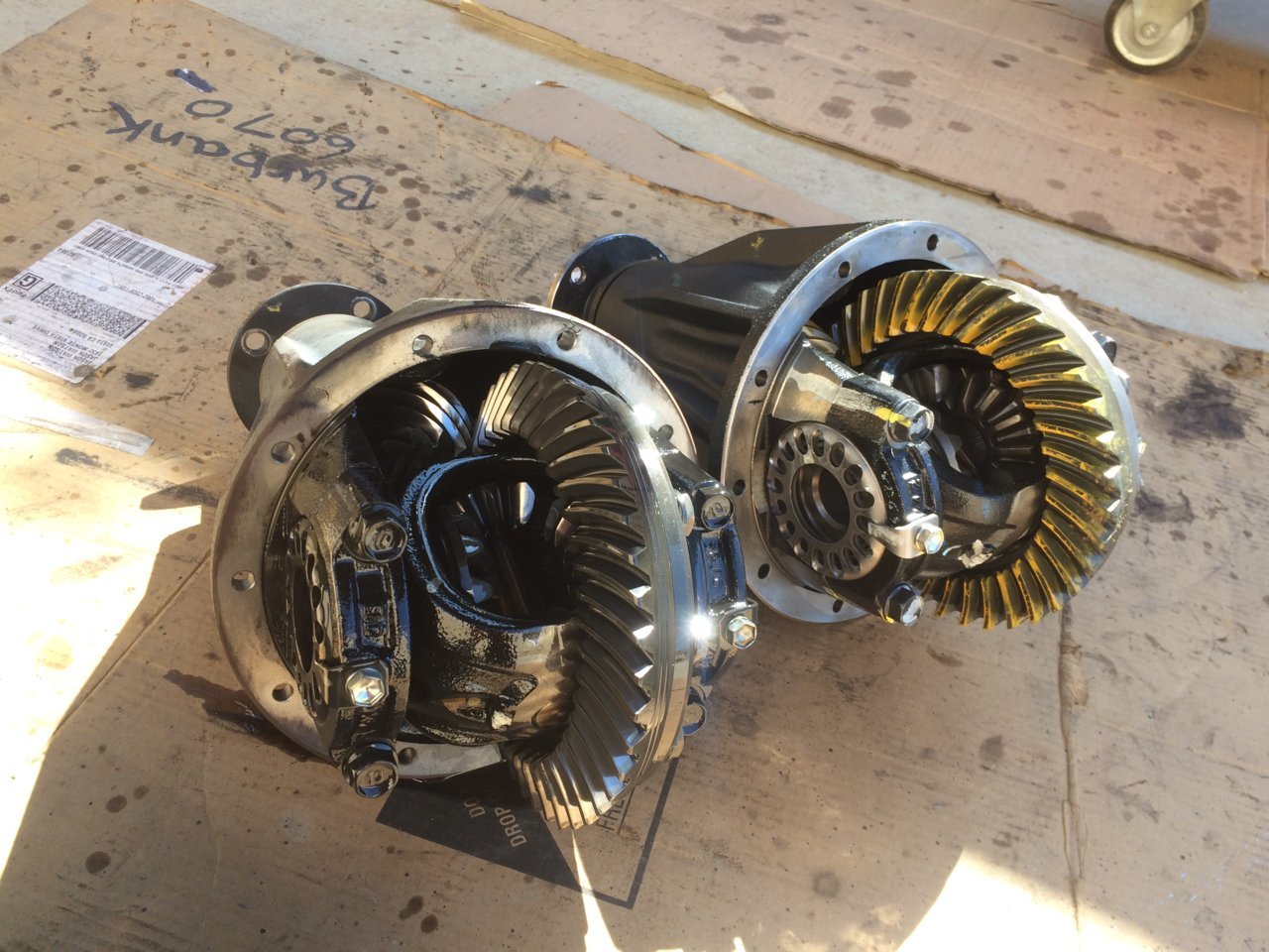

    Put in the new gears today. Thanks to my new friend @Speed Freek . Man, what a good guy he is. Good personality. Ideal citizen and a patriot.
    For folks in So Cal, I'd only recommend him for his mad skills. I drove nearly an hour to go see him, totally worth it.
    See full thread of the 5.29 gear change with a lot more pictures here.
    Also many thanks to everybody here who helped me along with making this mod happen. I would not have done it without your help, love and support, and answering my dumb questions :anonymous:.
    See the difference between the stock gears vs new Nitro 5.29s. Fully assembled core. With solid spacer. No locker. Open differential.
    Sealed it up nice and neat
