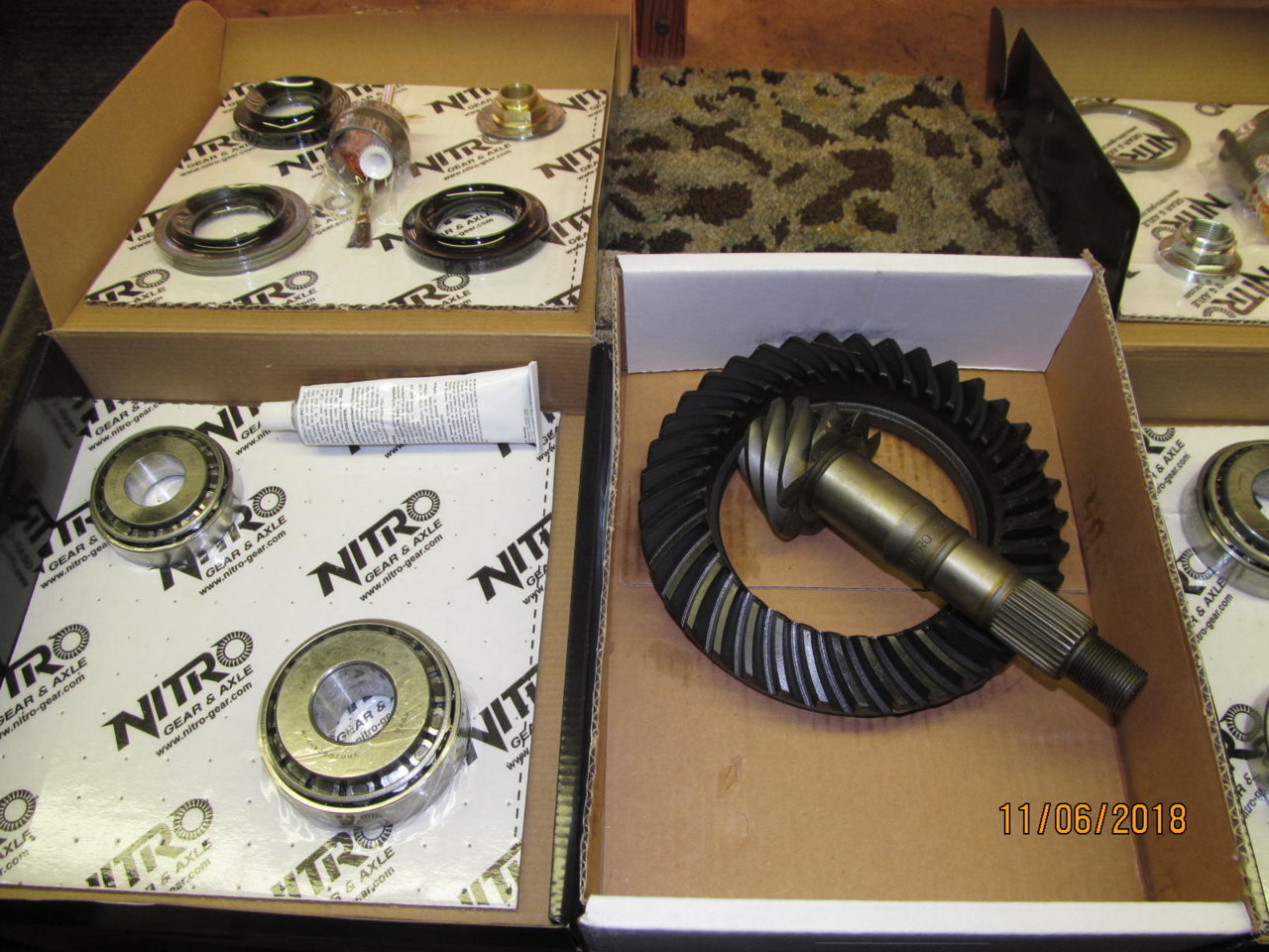

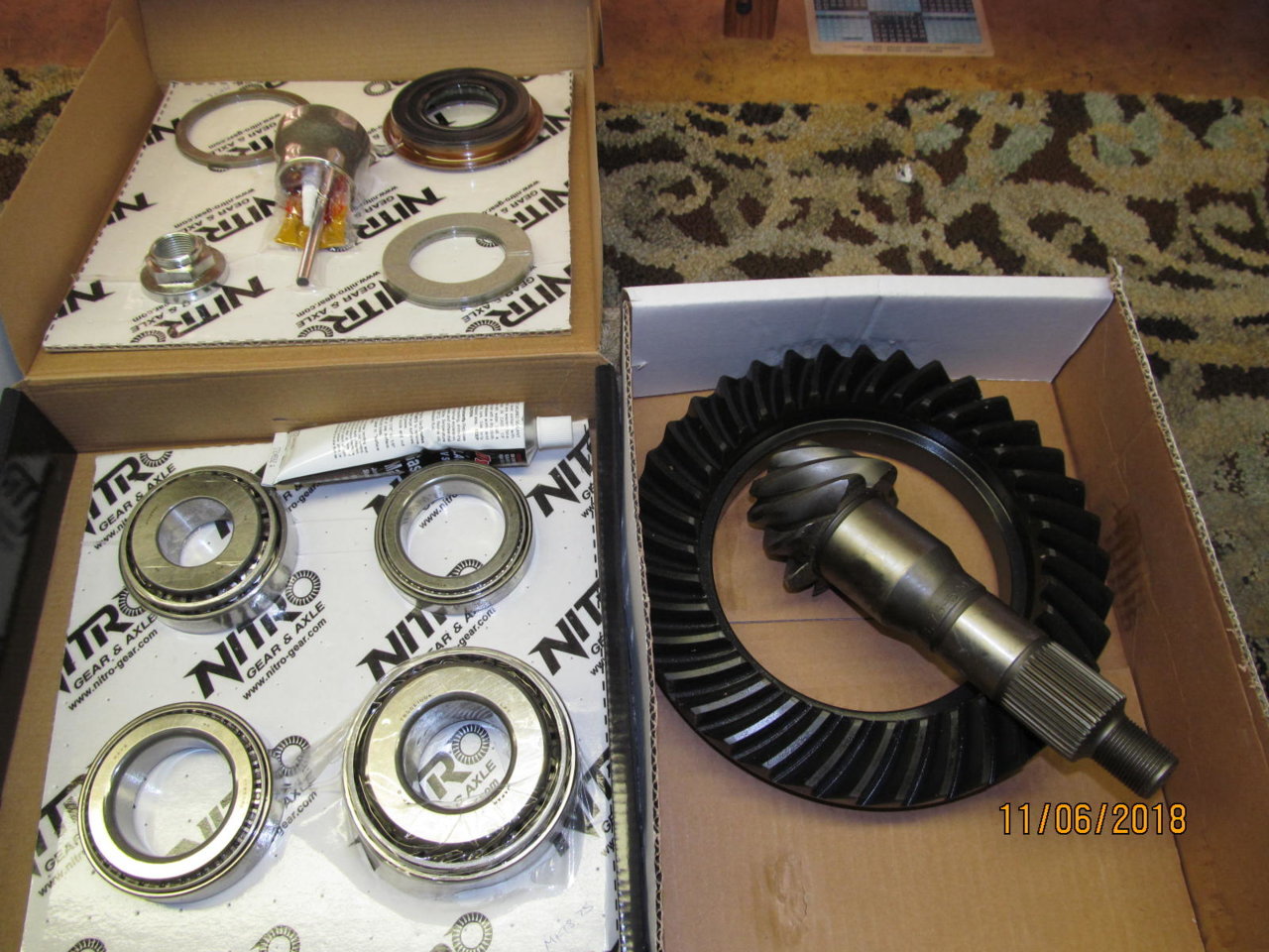

    Look what just came for Vitalzone and his 2016 Taco :thumbsup:
    From Justdifferentials.com .....3rd Gen Taco 529 gear package....2 ring/pinions and 2 master kits.
    Reverse cut 529's for the front 8" clam....Yep, JT's sent me notice that the carrier bearings are being delayed a little.
    Rear 8.75" ring/pinion.....look at the stoutness of that pinion. :muscleflexing:

    Pardon my ignorance on the clamshell. Is the output of the font pinion centered so that simply using a reverse cut gear allows for high pinion? Second question, what is the real benefit of high pinion if the front drive shaft is likely hiding behind skid plates anyway?
