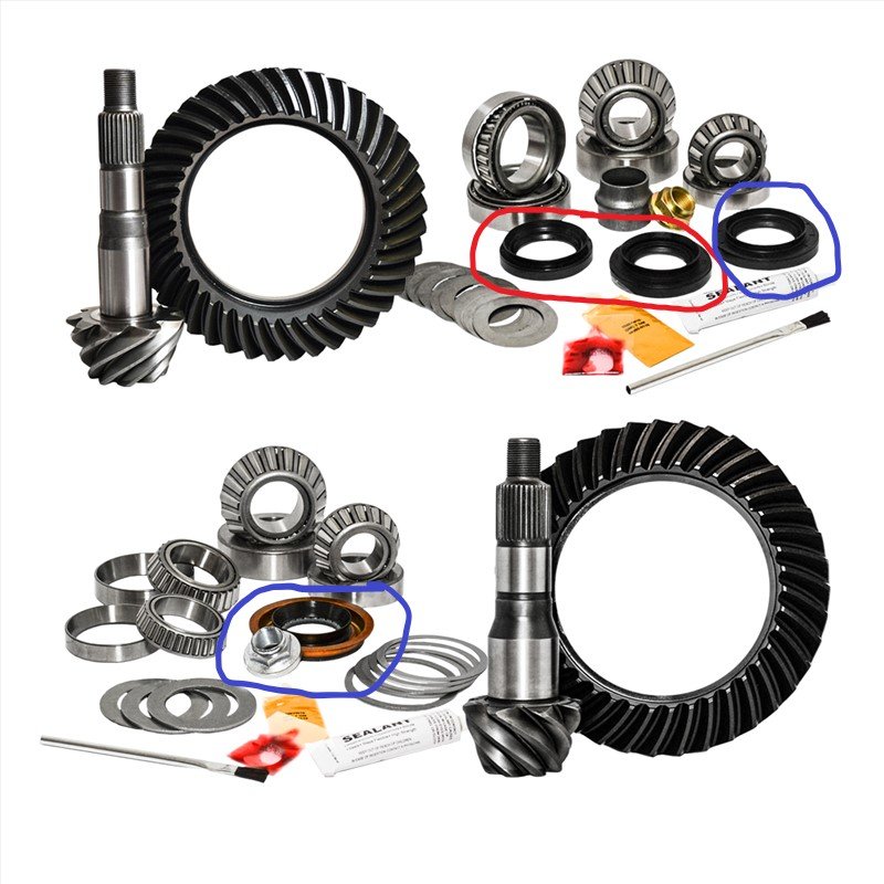

    In my Nitro Master Install Kits, there are more than two gasket seals. Looking at this thread, it looks like it was recommended to replace these with factory OEM seals since they were much better. So I purchased the front and rear pinion seals to replace the Nitro supplied ones (circled in this image in BLUE). However, it looks like there are two others? I'm guessing these are axles seals? (circled in RED).
    Are people also purchasing the OEM ones to replace these as well? If so, does anyone have the OEM part numbers?
