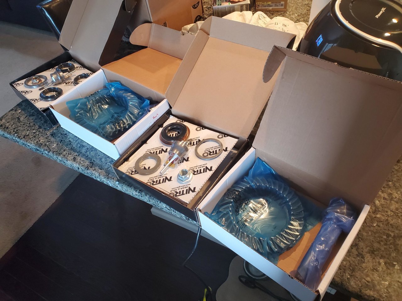

  13. Feb 27, 2020 at 4:34 PM
    #2233
    MrWednesday
    MrWednesday Well-Known Member
    Jun 17, 2018
    #256711
    233
    Colorado
    2018 DCSB TRD OR MGM
