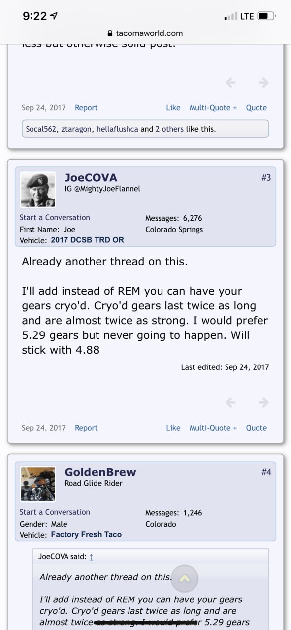

    This 5.29 thread vs the 4.88 thread is so mind numbing it’s unreal! The more I read the more I can’t make up my mind which route to go. Through a ton of reading though I did find a post by joecova that said he’d never have 5.29 then see he started the 5.29 thread :)
    Anyway back to reading need to decide by tomorrow when I place my order through ecgs. Debate is I’ll never go larger than 285/75 so thinking 4.88 paired with the OVTune I already have will be plenty sufficient for my truck as it will never be super heavy other than adding sliders along with the slimline hybrid and high clearance wings with smittybuilt x20 winch I already have. Honestly the only reason I’m still considering 5.29 is because of towing as 4.88 seem plenty sufficient for my daily needs and weekend playing with truck.
    JoeCOVA[OP] and 05prerun82 like this.

    There was a time when 5:29's were not available :notsure: Maybe @JoeCOVA was making reference "never gonna happen" to that? But, now they are available... :thumbsup:

    Ya that was back in 2017 when Nitro said they would never make 5.29 and that it would be too low. At that time I resigned to the fact that we were stuck with 4.88s. My patience paid off and we have 5.29s. Jumped on them as soon as I could when they released.
