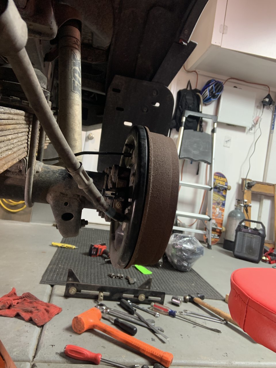

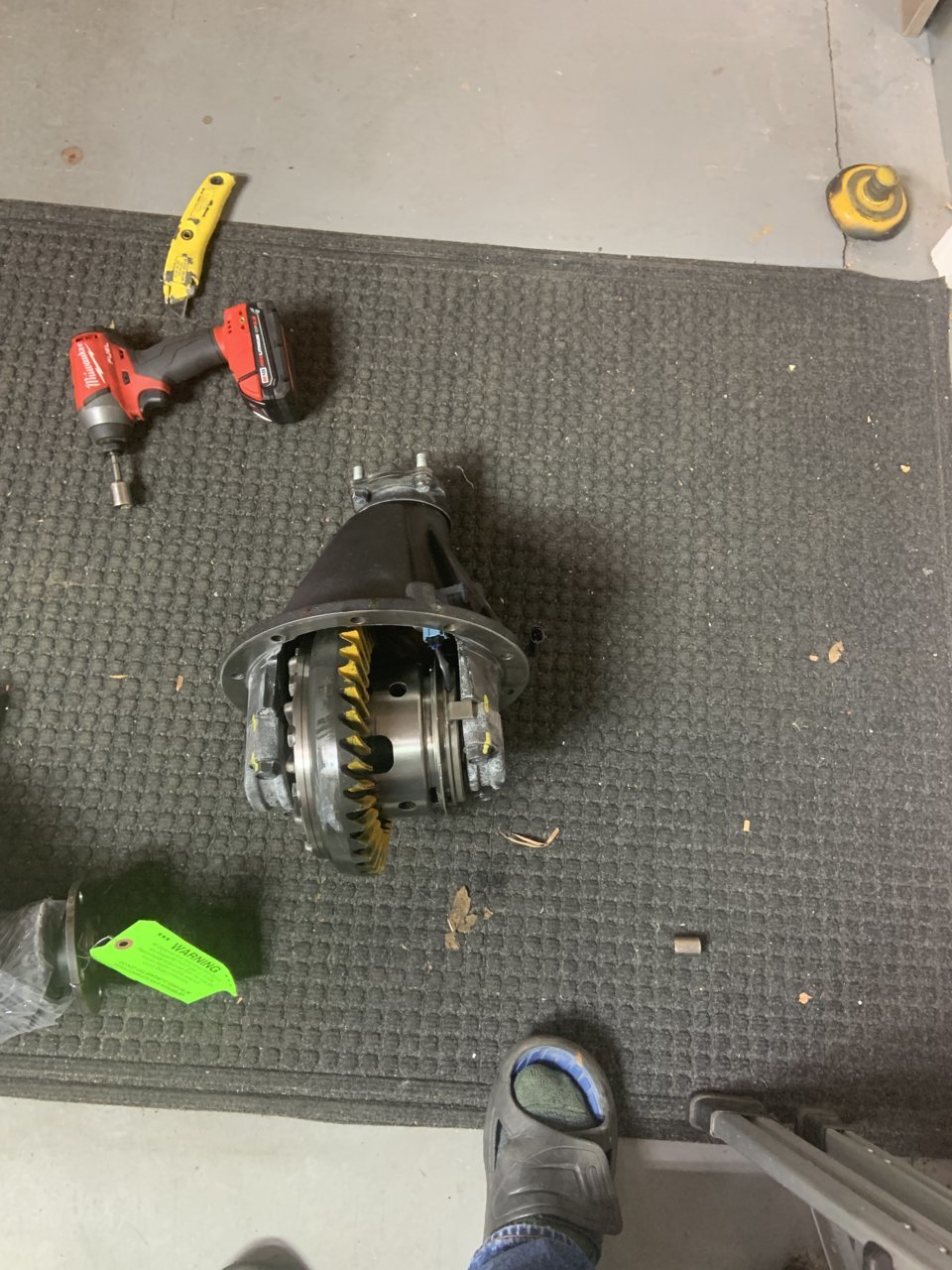

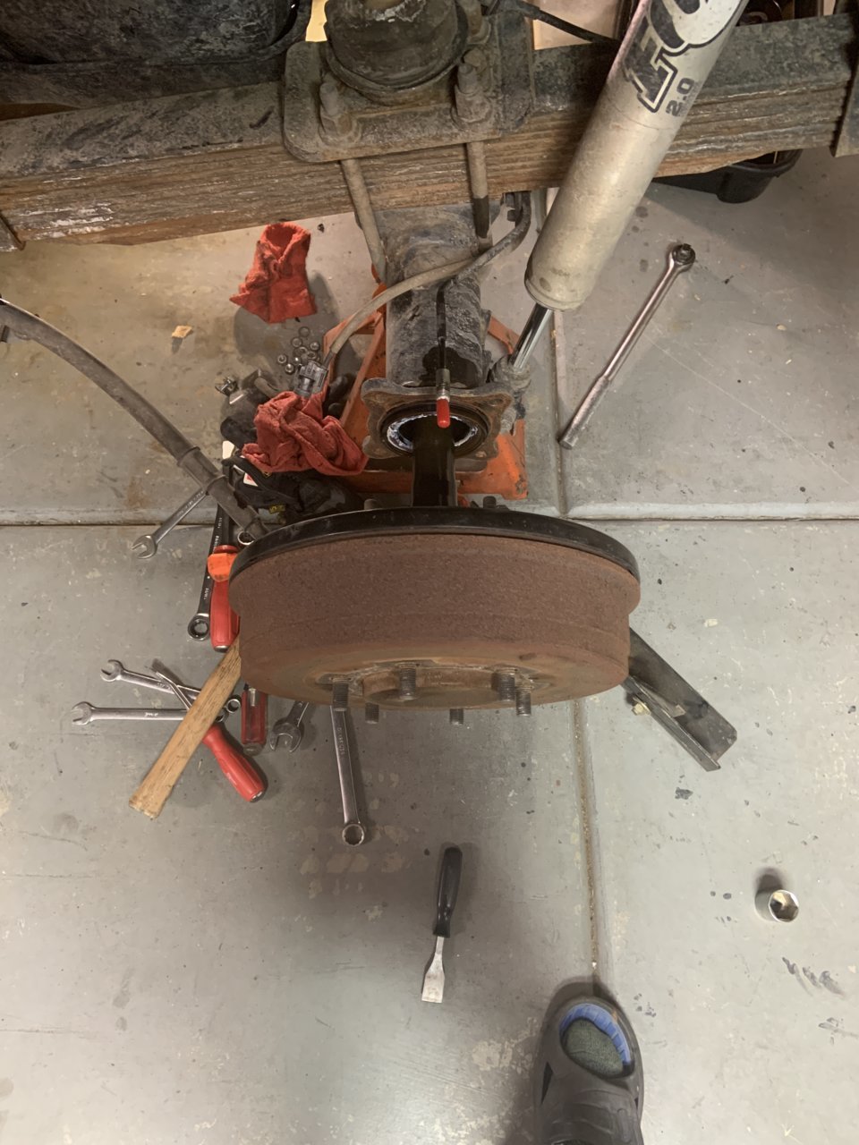

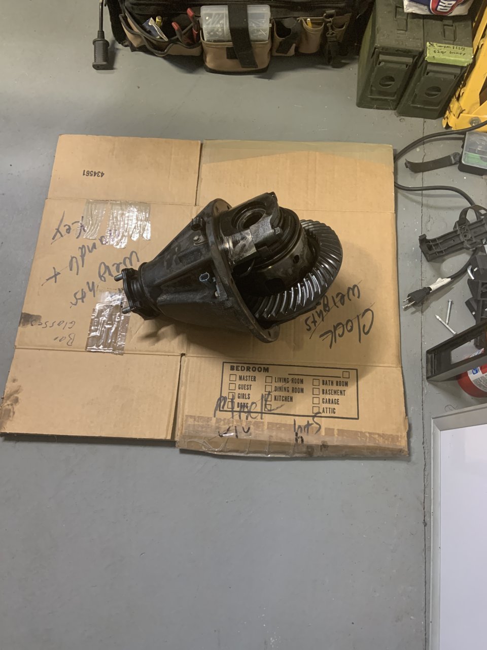

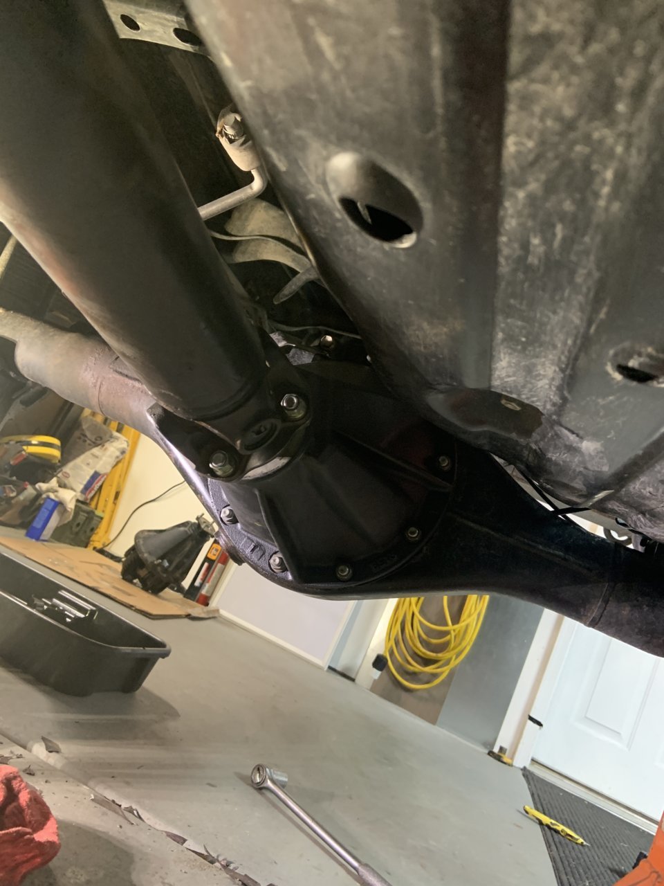

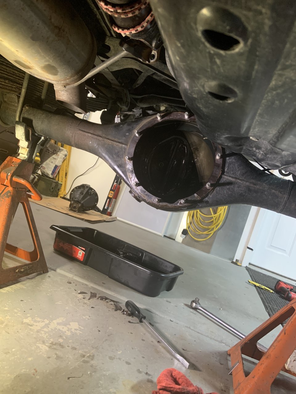

    Got the ECG rear dif installed, way easy. Best upgrade hands down. 5.29s make a huge drivability improvement. I think I would go with them with stock tires on the AT.

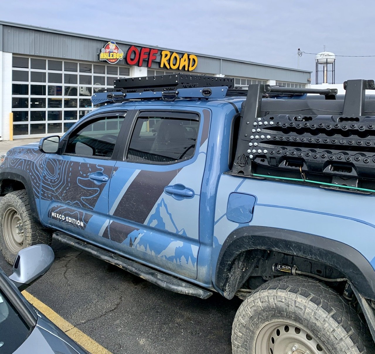

    Dropped my girl off this afternoon for install

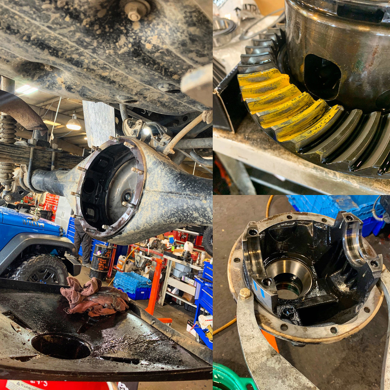

    As far as anyone following along with my diff locker indicator issue. They are pulling open the diff again this week to quadruple check everything. Nitro thinks the bearings need to be seated better but the shop says they have had the diff out several times and everything is installed perfectly (and I believe them).
    If everything is installed correctly they are going to machine enough off the position sensor to put the clearance back to where it was with the stock gears.
