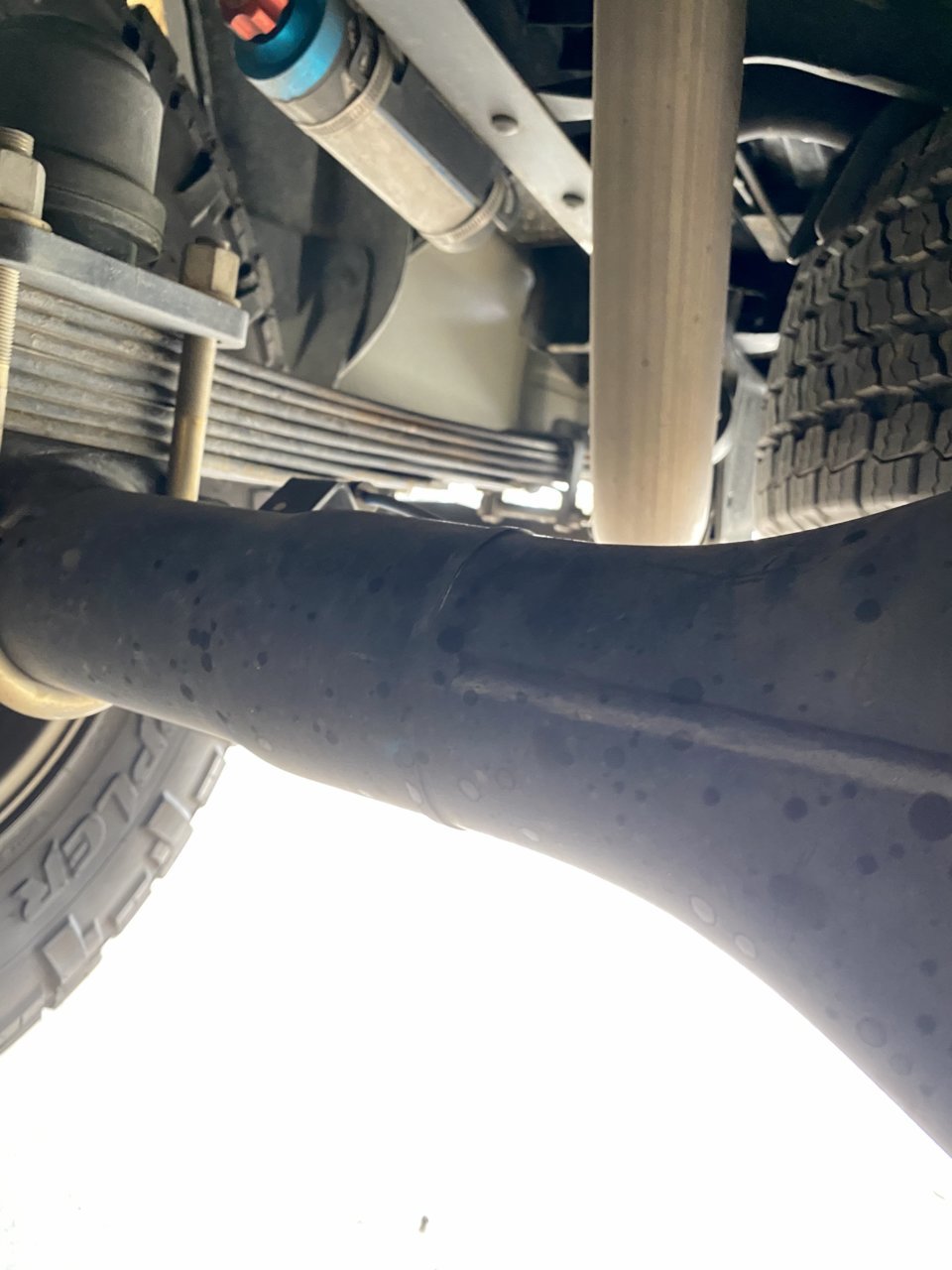

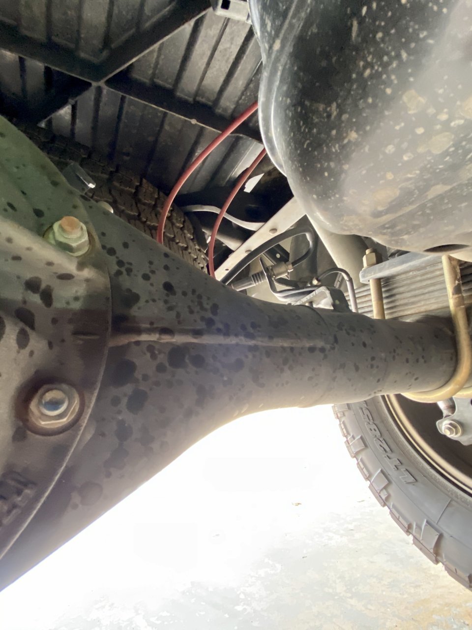

    Gents, had my gears since about december, and was recently under the truck and noticed some possible leaks from the rear diff, and random spray on the diff case. Just looking for thoughts and if i should be concerned at all.. my installer wanted to keep the OEM seal since the truck did not have a lot of miles on it.

    The seal should have been replaced imho. I always replace seals, never reuse them.

    I know I questioned it and should have pushed harder because I brought a new oem seal with me. Pretty obvious it’s leaking right?

    Ya looks like the classic weeping diff.

    Where are the spots of oil coming from. Is the pinion seal leaking too?

    that’s the rear diff so not coming from the engine or tranny.. it the splatter is running down each axle from the diff and on the bottom and top of the diff case. I don’t see it anywhere else though.
