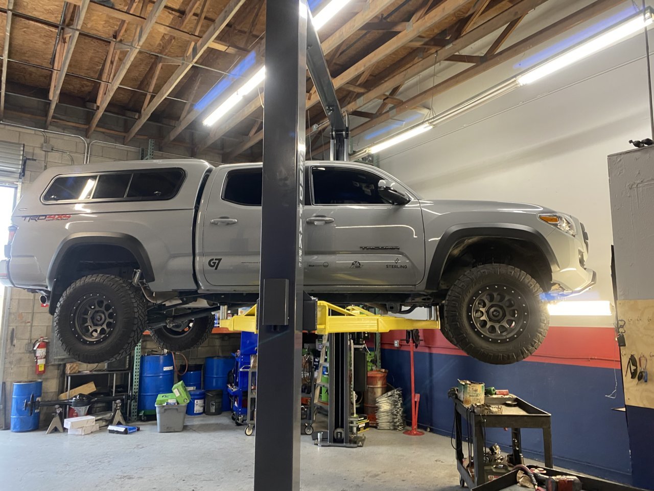

    Got them installed today and the drive home other than the cool downs was so much better than stock! 78734536-5A0A-41F0-BADE-3D4721C956E1.jpg
