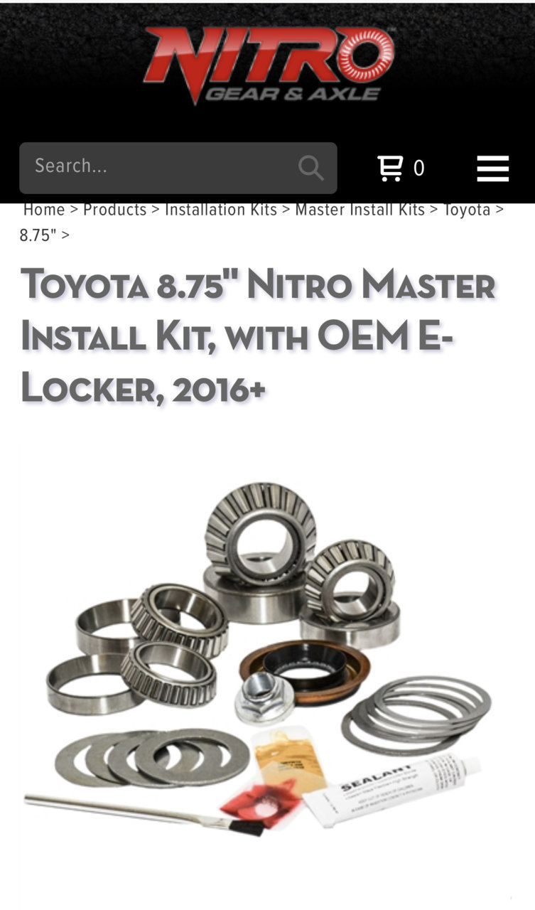

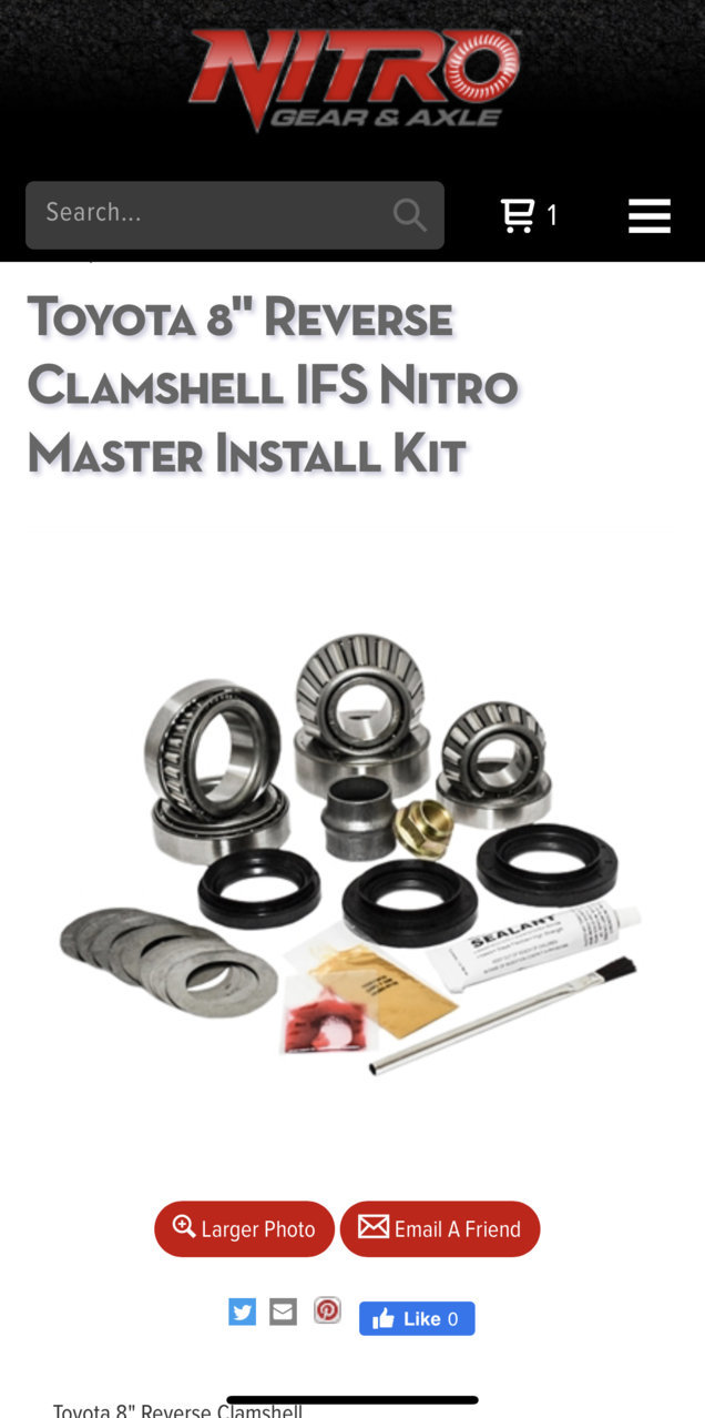

    So I have the ring and pinion 5.29 from Nitro gears (front and back) I still need to purchase the master install kit from Nitro.
    Are these the ones I need for the front and rear?
    FYI.. I own a 17 with factory e-locker.
    the 8” clamshell says is only for 2005-2010 Tacoma though. I can’t find the master install kit for the front for 2016 and up Tacoma’s.

    At quick glance that looks correct, the 2016+ Tacomas utilize an 8" reverse clamshell for IFS but I'm not why it says 05-10, could always call them tomorrow. There website only shows 3 front applications 7.5", 8" and 9" and we dont run the 7.5" and 9." Maybe their website is just poorly updated, idk

    IFS stand for...independent front suspension?
    yeah it’s driving me crazy. But on their full package list it shows this
