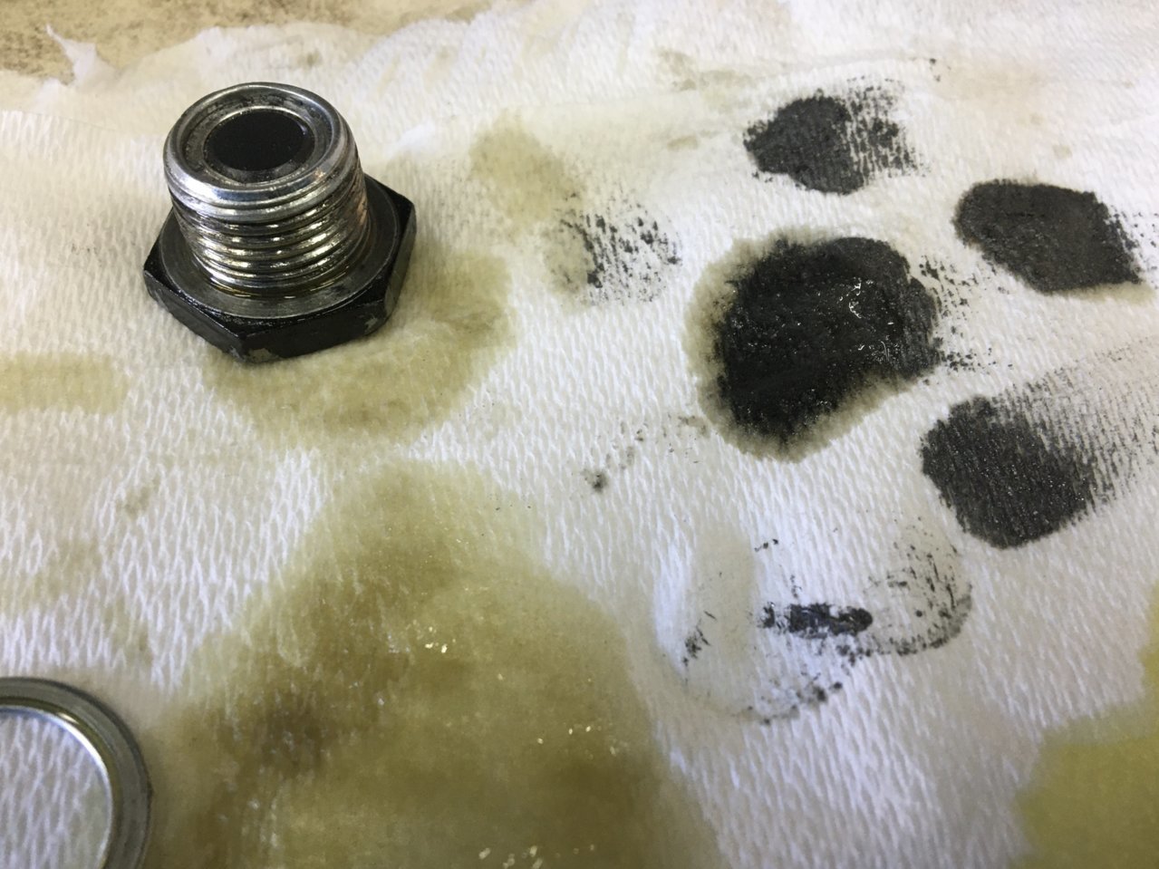

    Ive broken in probably 10 sets of gears and none ever looked like that. That oil could have be reused it was so clean haha.

    You'd have to have a driveshaft out of balance for that to happen.
