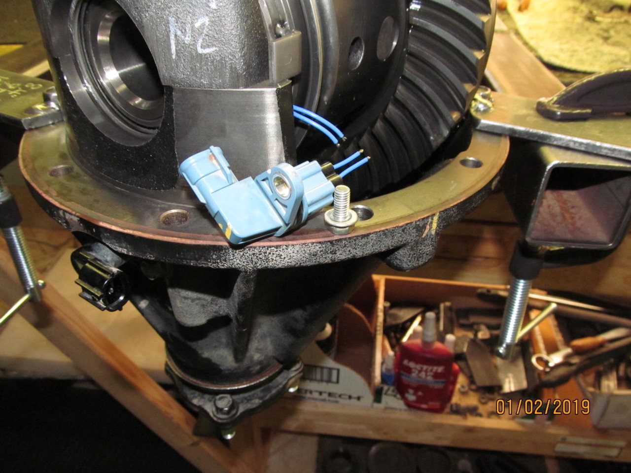

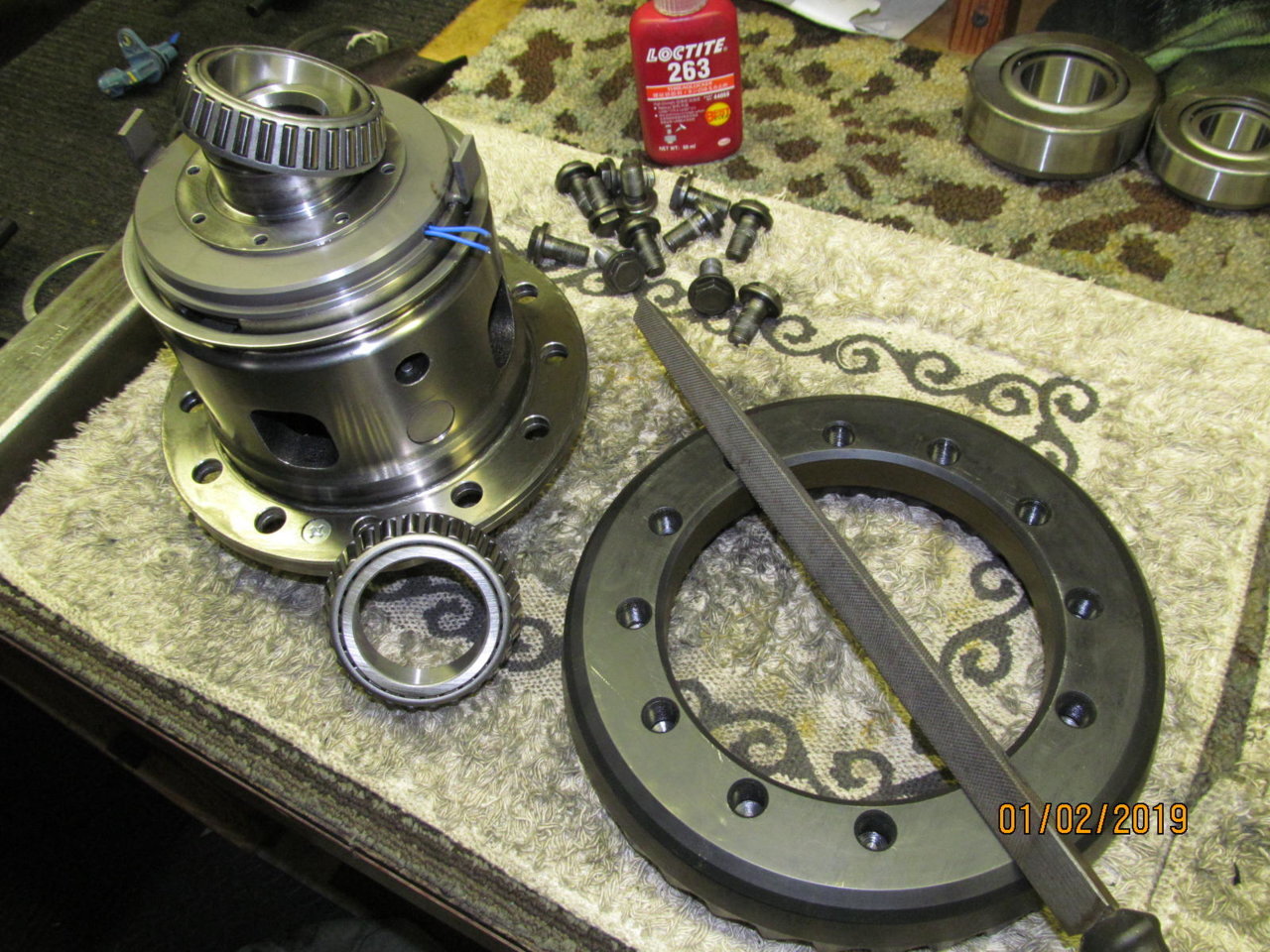

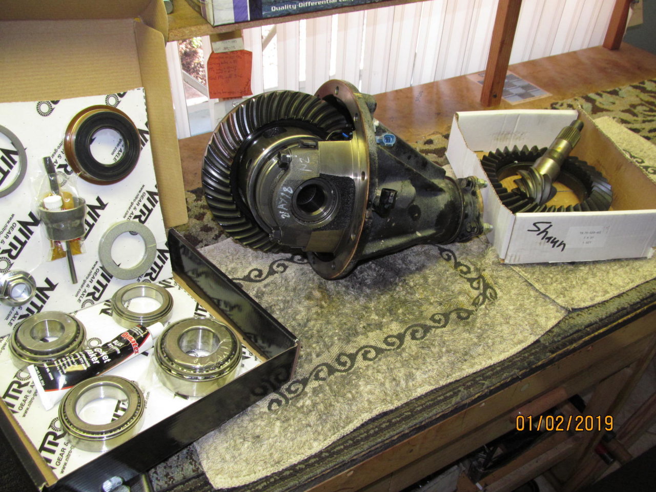

    Shawn is local to me and brought his 2016 Taco rear 8.75" elocker 3rd over to me for new bearings and 529 Nitro Gears.
    There is a blue and a black plastic connector on the 3rd. The blue is the 12 volt activation wire and the black is the sensor wire.
    These parts came from http://justdifferentials.com

    Life would be simpler if the dang connector would come apart like it is supposed to.....this is the 2nd 8.75" elocker that has been stubborn so it was a simple matter of cutting the wires
    and solder them later on. I am fortunate that Hughes Aircraft allowed me to get 2 solder certificates during my 9.9 year stay there......you would not believe some of
    the unique things I did to some of the test missiles....the "bodywork" .......and the soldering also.

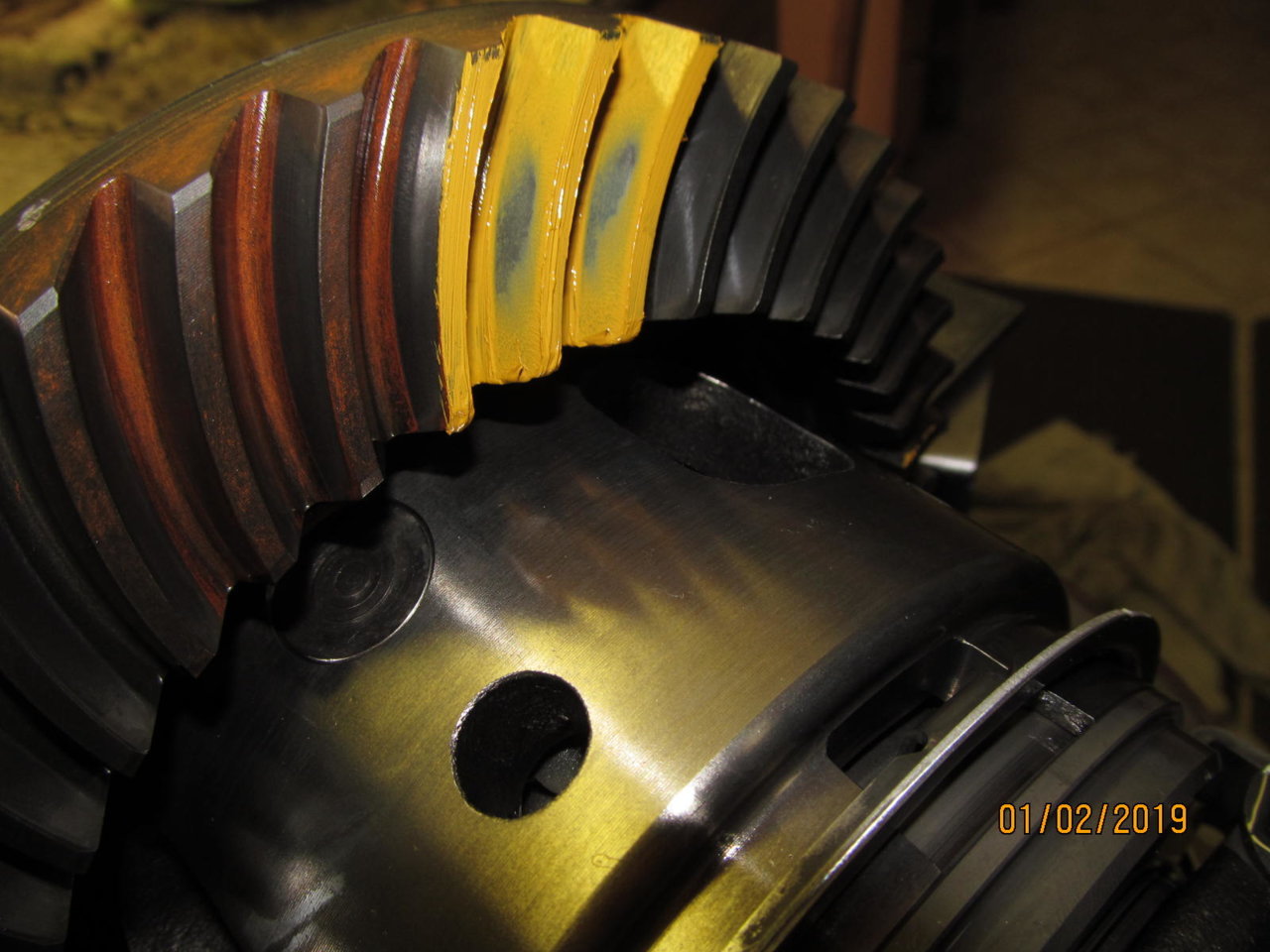

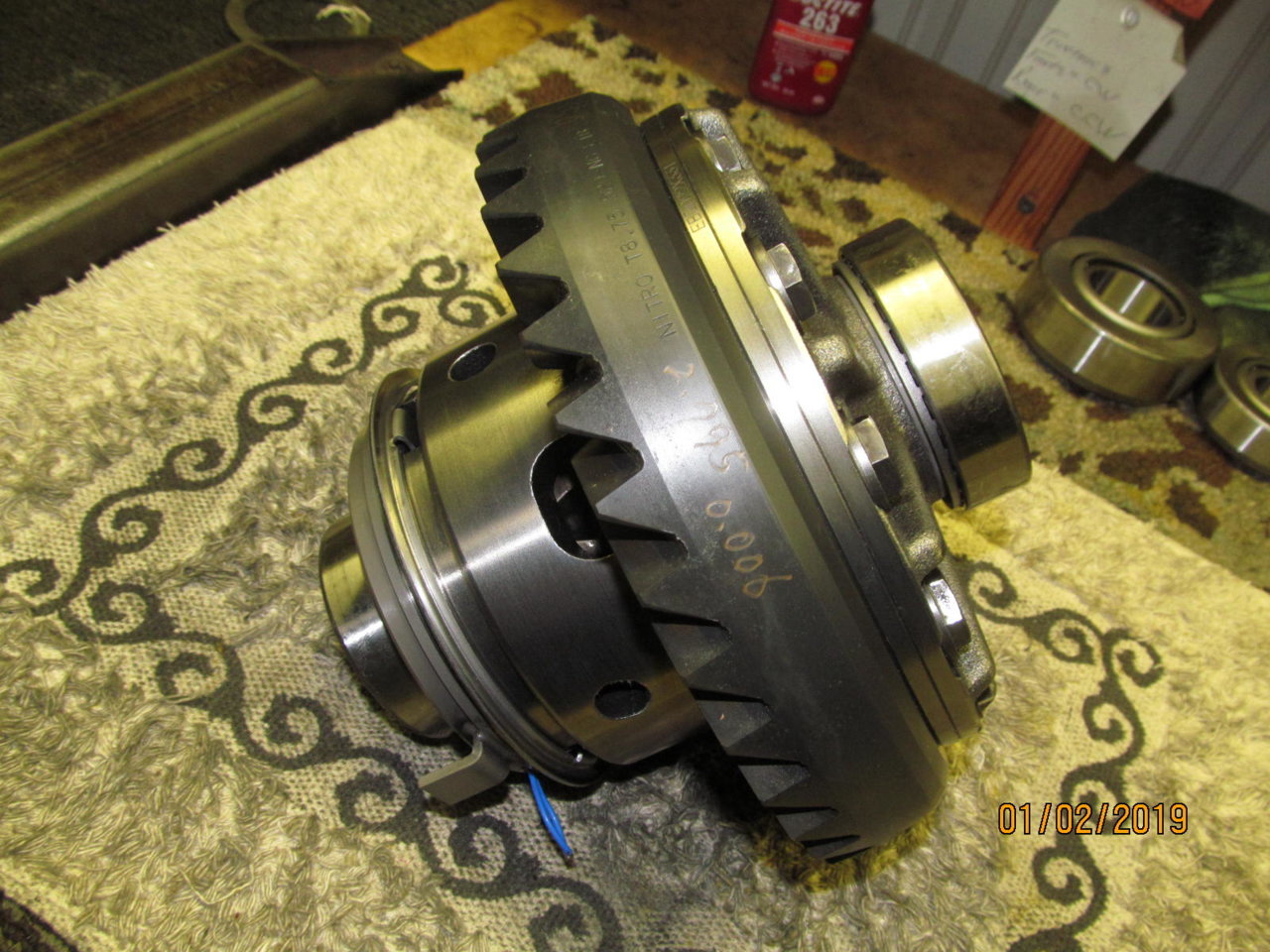

    But first let's take some paint tests on the original 430 factory gears and see how well they set them up.
    This is the drive side...it is nicely centered and has the proper depth look to it. Nice job Toyota.
  12. Jan 2, 2019 at 6:42 PM
    #272
    ZUK
    ZUK Gearinstalls.com
    Oct 12, 2014
    #140154
    174
    Ken
    Chandler AZ
    2001 white Taco TRD 3.4L auto (SAS FJ60 flip) 35" KO2 5" AllPro leafpacks front and rear,
    SAS,1985 FJ60 flipped axle, 35" KO2,5" AllPro leafpacks front and rear,

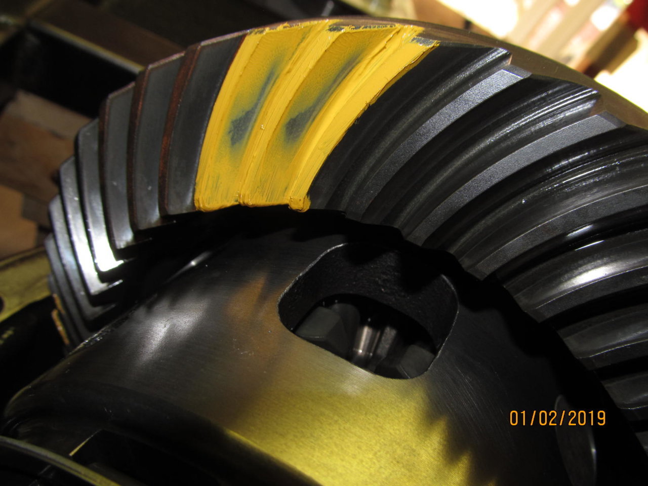

    Here is the coast......favoring the outside heel just a little but it looks like the right depth so good job there too Toyota.
    I could not apply as much pressure as I would have like to (because of the dang square flange)
    so it could have "looked better" with more pressure on the paint.
    The pinion bearing preload was about 5 inch/pounds and the carrier bearing preload was about 5 inch/pounds....the backlash was right at .007" when I spot checked about 8 teeth...... so this diff was actually set pretty good from the factory:thumbsup:

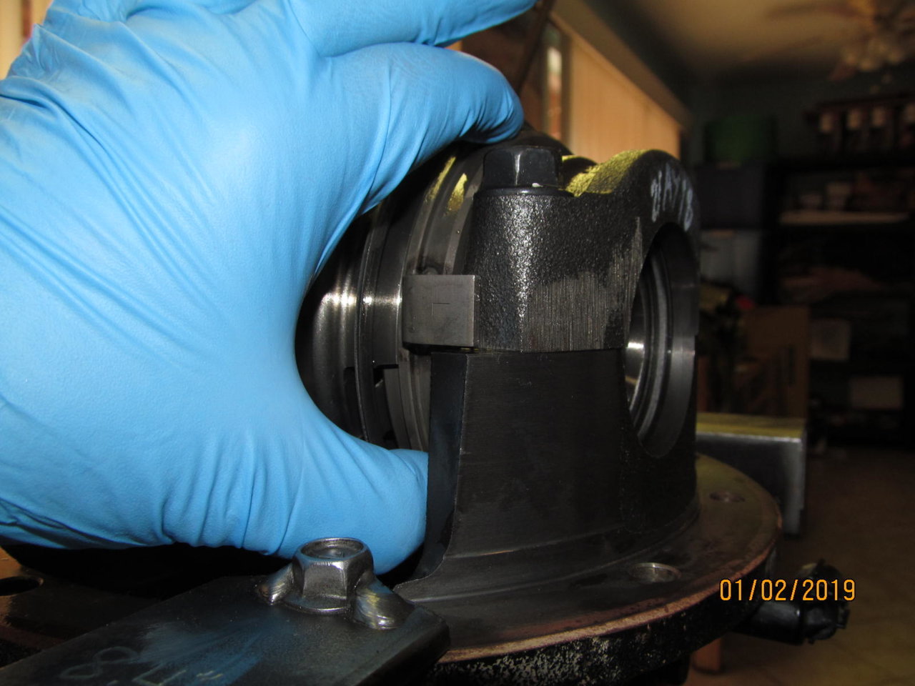

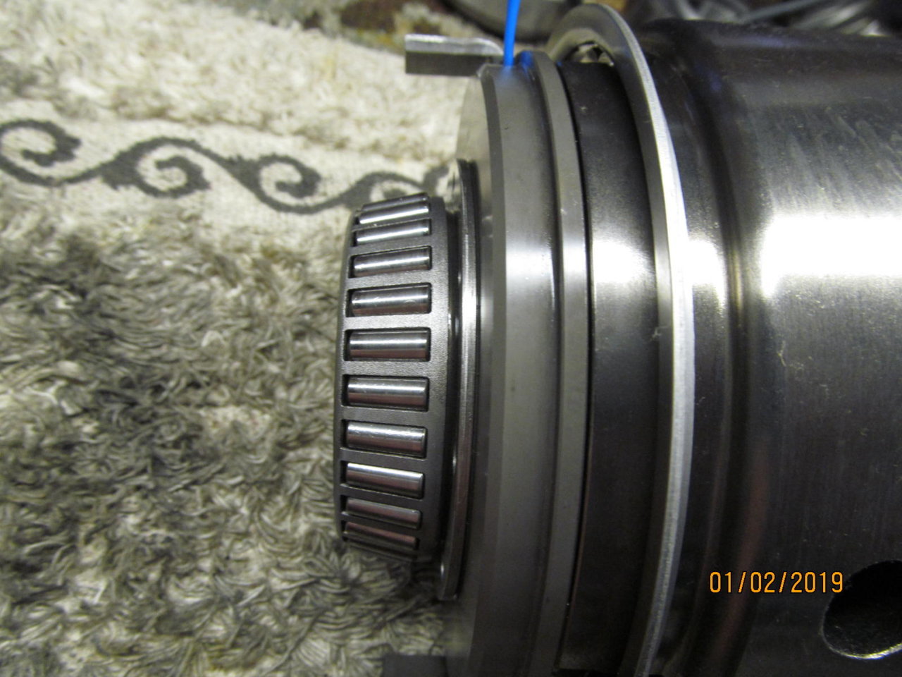

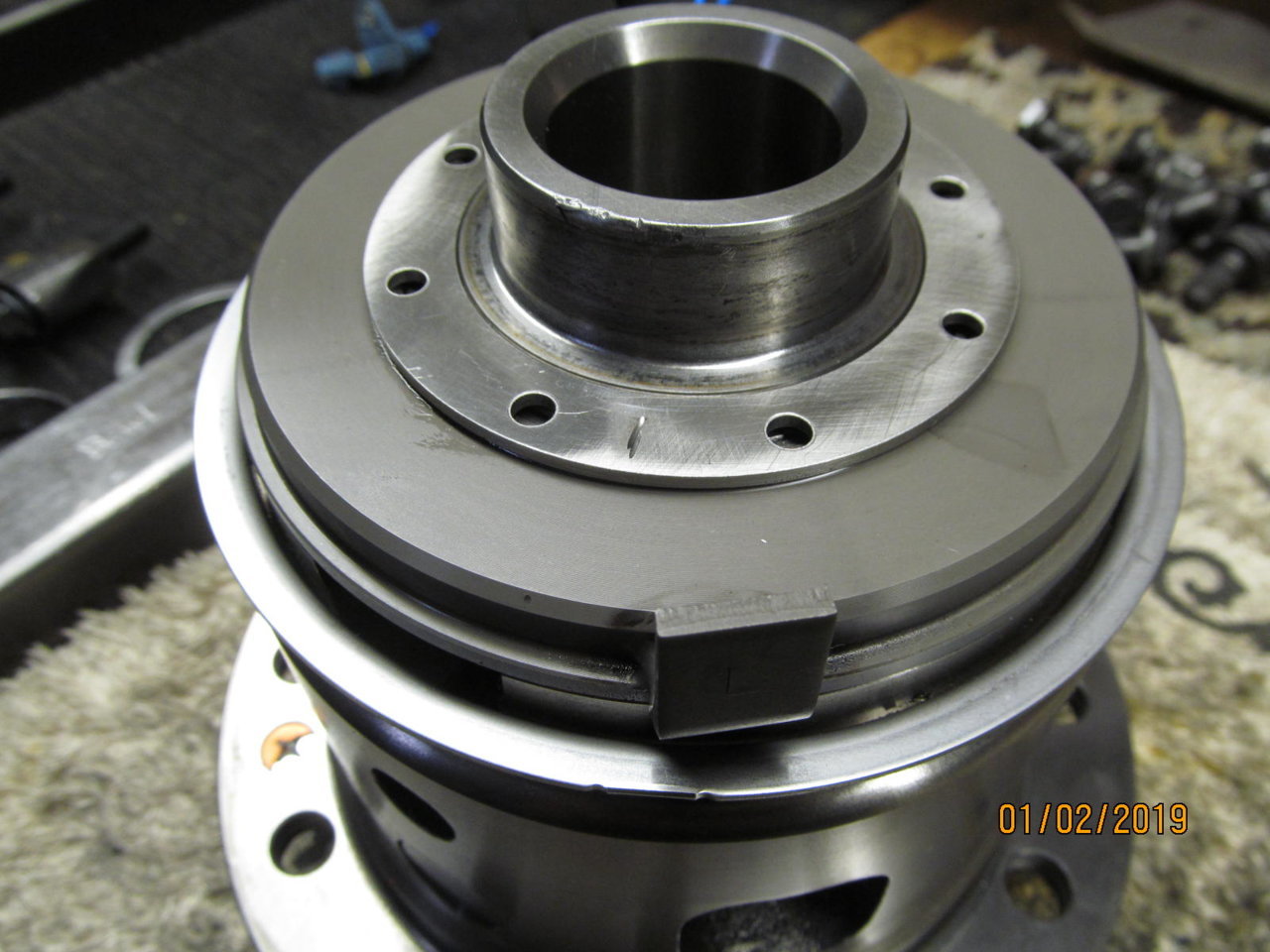

    This is very similar to the Australian Harrop elockers. Same stop tab design and same electromagnet coil engagement mechanism. It's an Eaton elocker ;)
    There's between 1 and 2mm of play on the tabs which is normal.

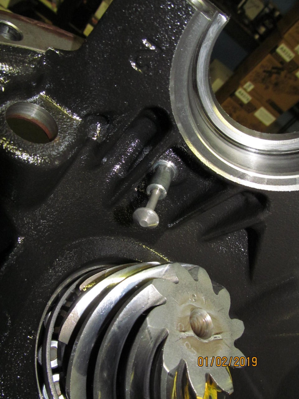

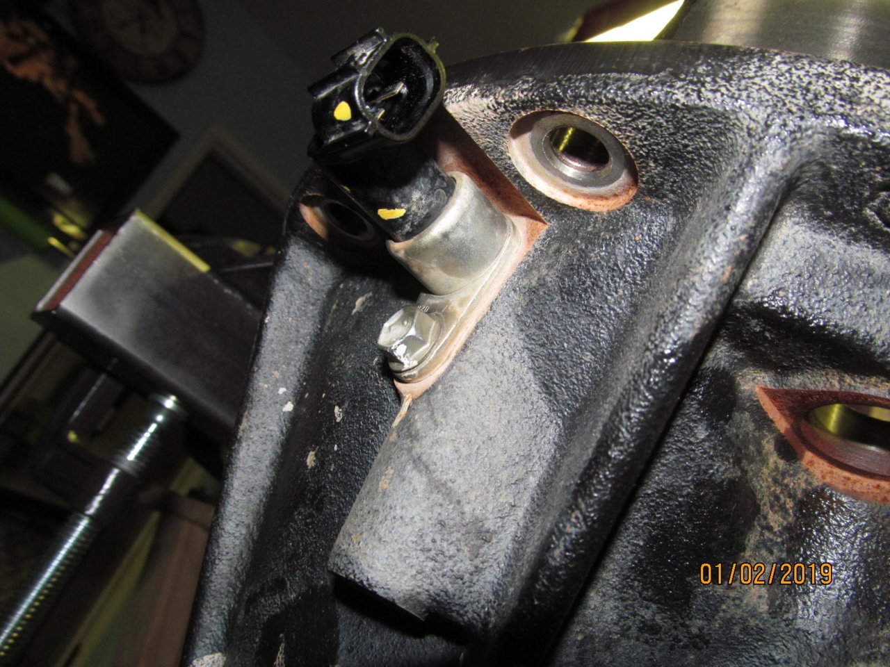

    This is the black connector that senses when the locker is fully engaged. There is no reason to remove this one for this install.
    There is an o-ring behind it so, Shawn, you did not mess up a thing when you twisted it a little while you tested the fitting for removal.;)
    Additional note- This connector cannot be removed anyways....at least until the elocker center carrier is lifted out of the way(interference issues otherwise)
    An interesting mechanical method of sensing the lock ring movement.

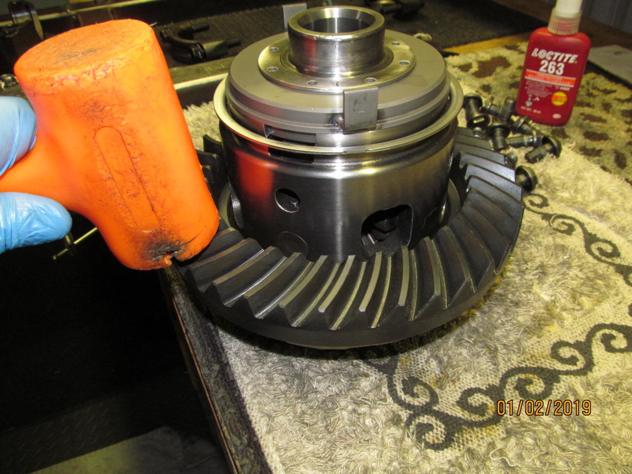

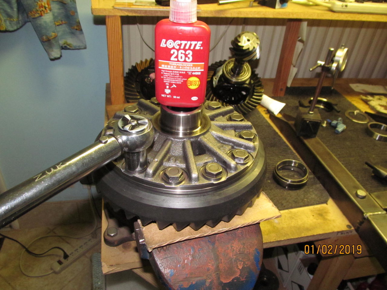

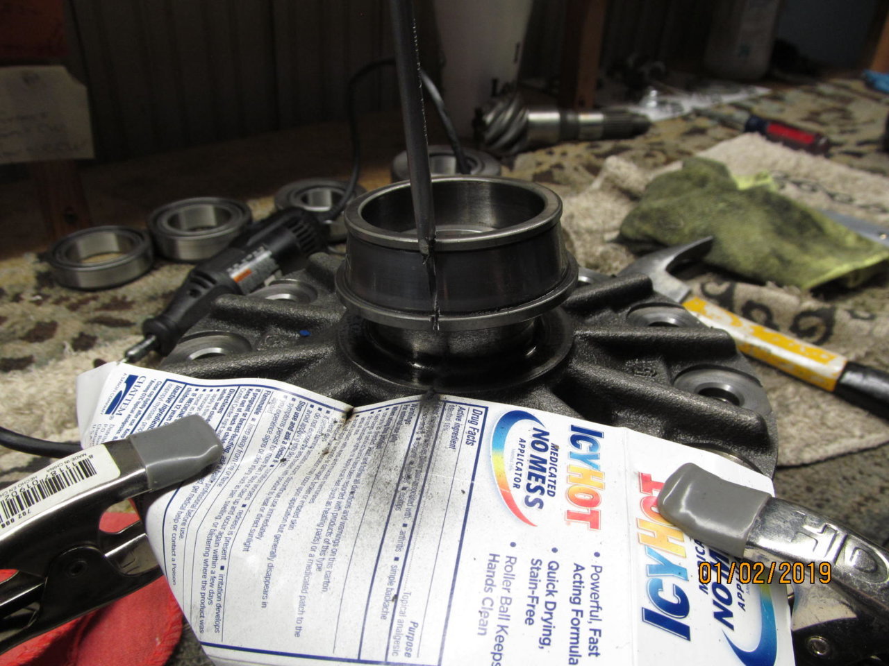

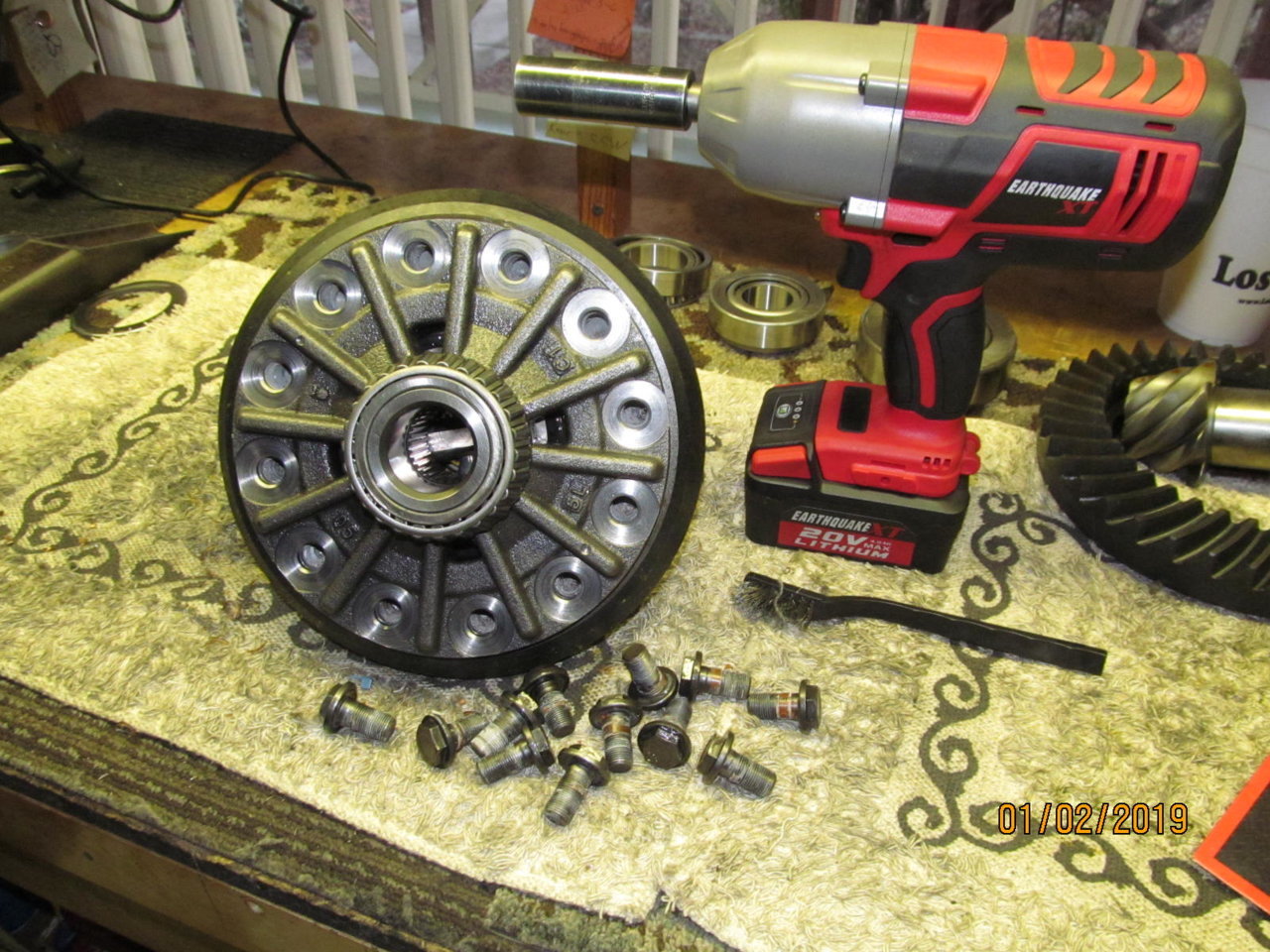

    Those 12 flange style bolts were on TIGHT with Toyota loctite. The Earthquake made easy work of it though.

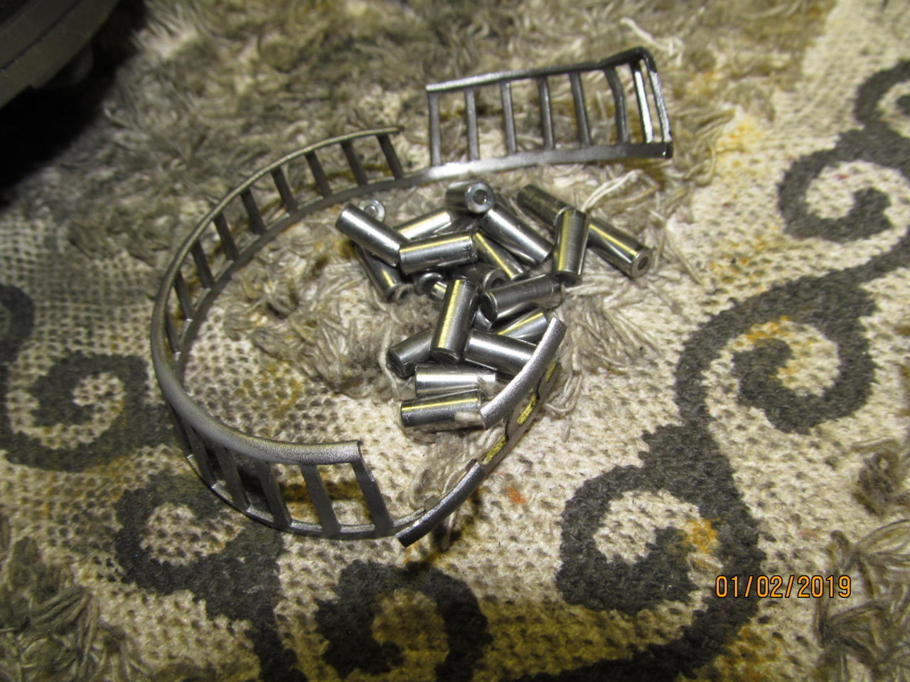

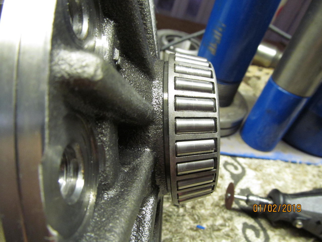

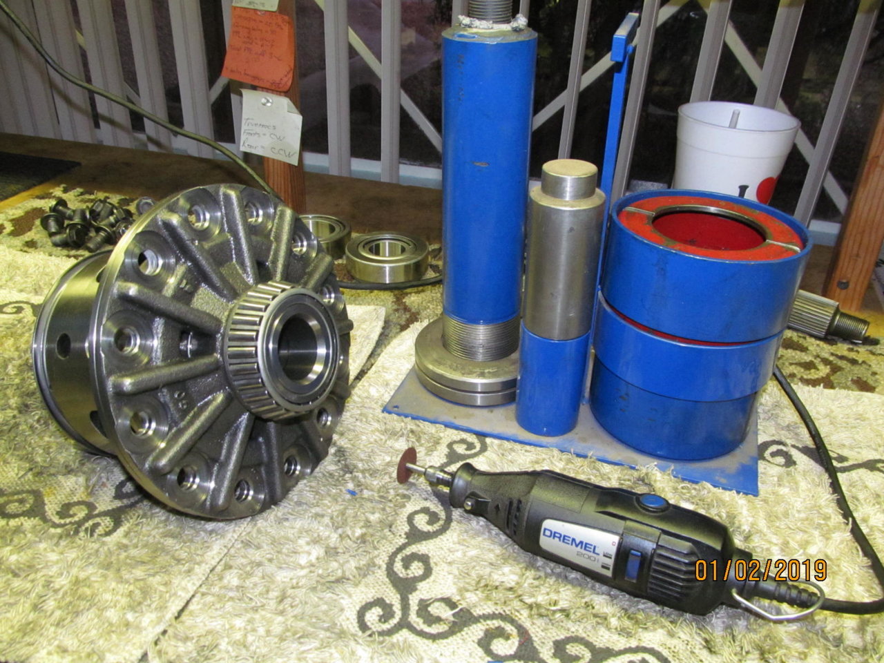

    hmmmmmm.....no way to get a puller behind this carrier bearing.....
    And this side is almost as tight but I might have good luck with the blue cup style.....
    Well, Itried the 4 possible sizes I have here and no go....not a proper fit to power off this bearing
    so had to resort to a dremel and a tiny cutting wheel.
    mcharfauros and mauidogg like this.
  17. Jan 2, 2019 at 7:01 PM
    #277
    ZUK
    Oct 12, 2014
    #140154
    174
    Ken
    Chandler AZ

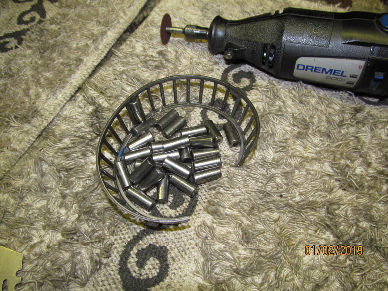

    cut the 1st cage off......
    and take the inner bearing off on this side.
    This side done.
    Cut the cage off on the other side.
    and take the inner bearing off also. Done.

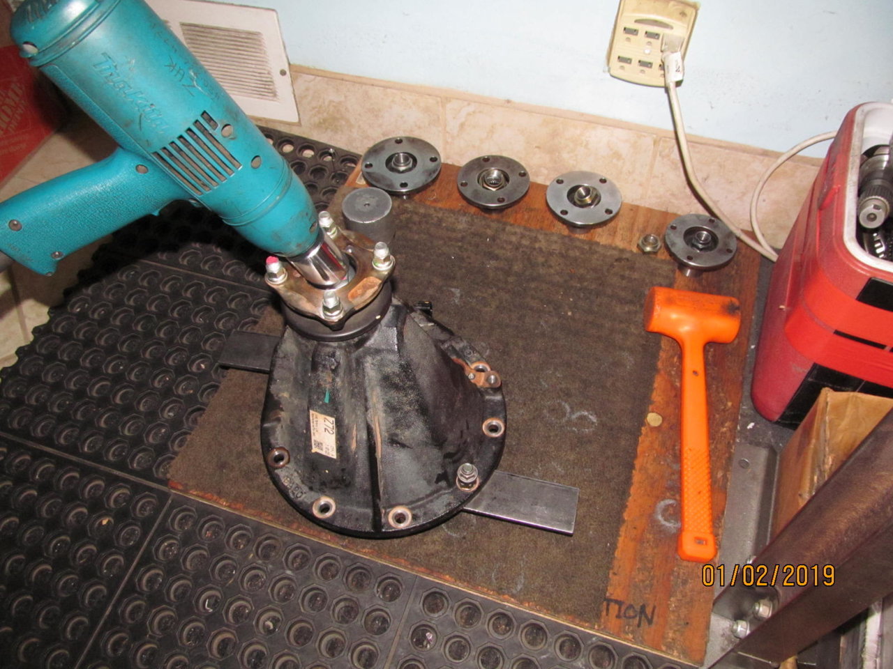

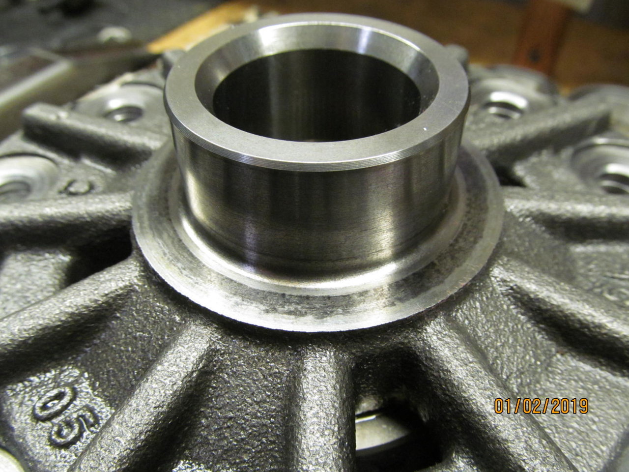

    Surfaces checked with a file. All is good.
    The new Nitro 529 went on with only some light taps. No boiling water needed :)
    92 ft/lb and red loctite on all 12.
    Press the new Koyo bearings on and this end is done.
    I'll work on this end in the morning.
