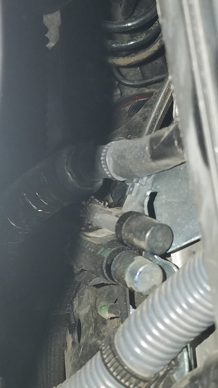

    If the diff was even slightly over filled, gear oil will travel up the breather. Once it comes back down the breather, some will want to escape between the hose and hard pipe. Even just a tint bit of oil will make it look like a huge mess. I suggest that you do 2 things.
    1. Make sure that the breather connection on top the diff is in good shape(still connected)
    2. Open the fill plug when the diff is cool and drain any excess fluid out.
    Once this is done, thoroughly clean the diff and it should not leak again after this. If it does, there may be an issue that you will have to find where the leak is coming from.

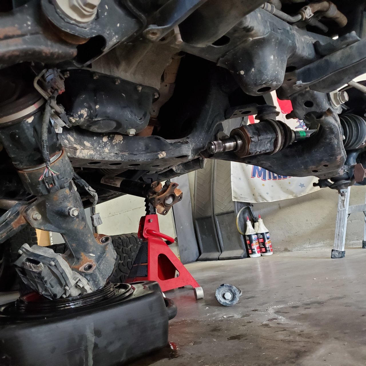

    This is what it should look like with the diff out. Notice only the driver side CV is out. ADD tube disconnected, and harness disconnected from add actuator.

    Fuckin eh. That picture's worth a thousand words. Thanks

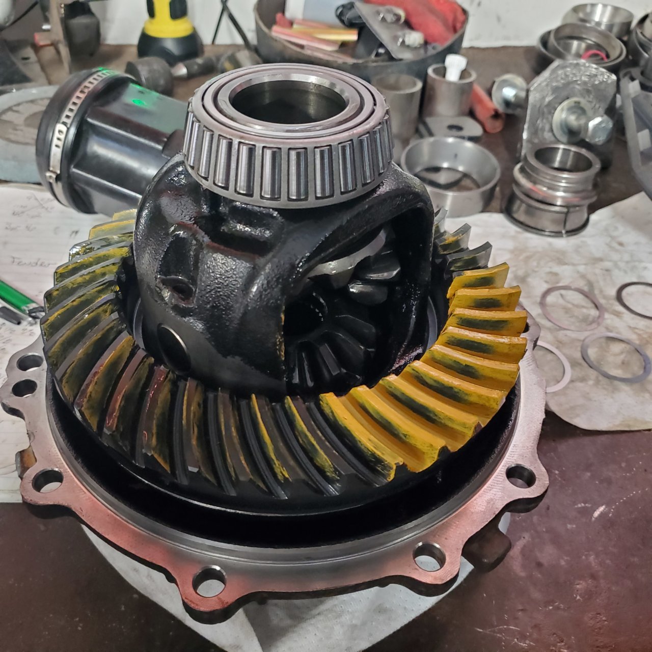

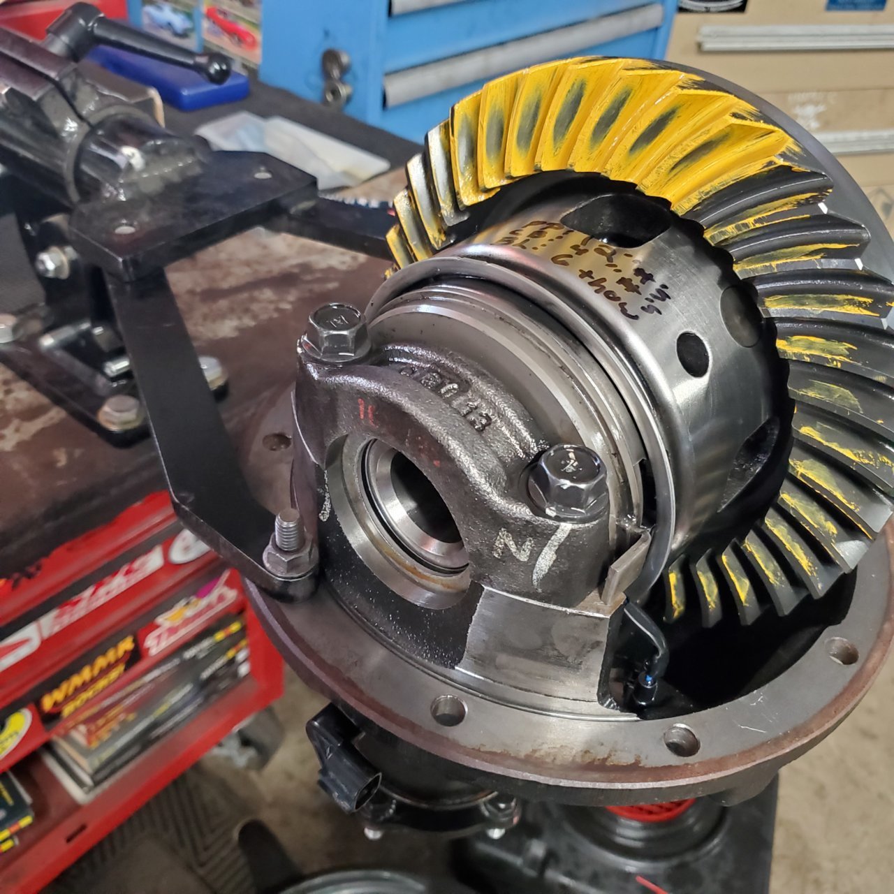

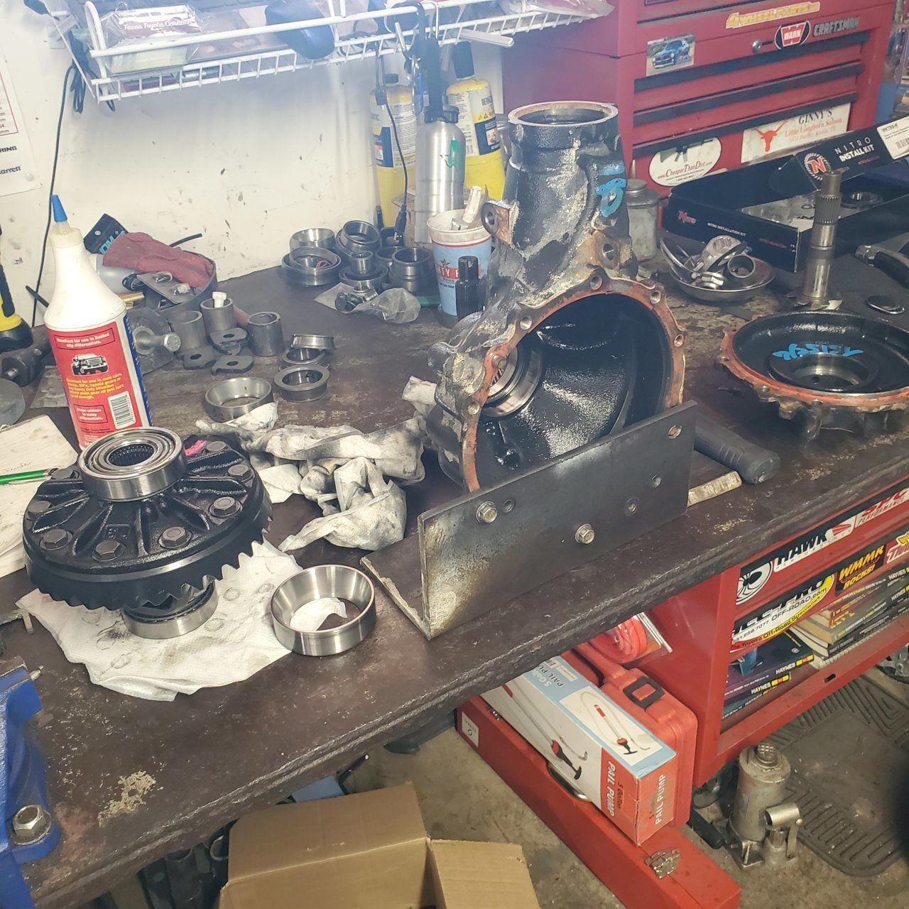

    I'm your guy for Cen Tex installs. Check out Triple C Chop Shop on FB and IG for the work I've done. Here's this past weekends Tacoma 8.75" elocker and 8" clam regear to 5.29.
