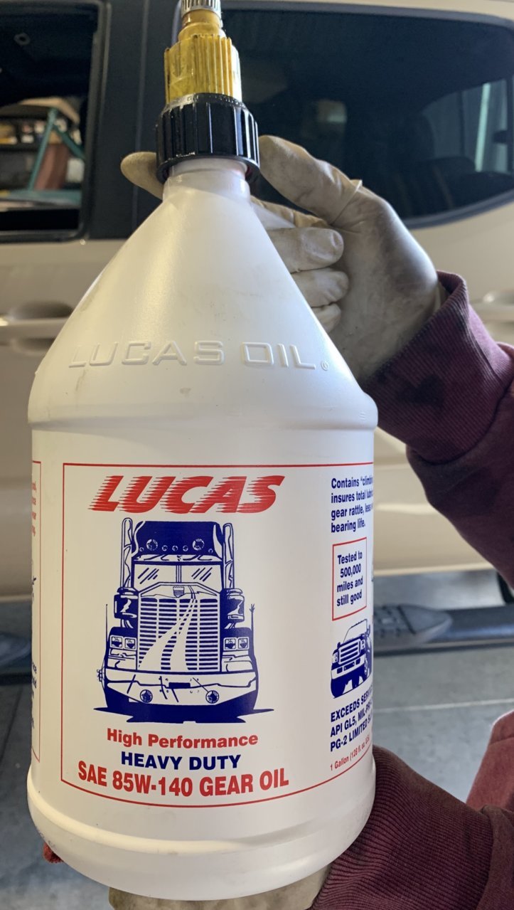

    It’s been about 10 months and I’m looking into getting front/rear 5.29 diff oil changed. This will be 2nd. Got the initial 500m oil changed back in Oct 2019. Should i stick with the same: Lucas 85w-140?
    and how many 1-Gallon do i need?

    Yes, stick with it, and you'll need 2 of those.

    Not finding 1-gallon on ecgs so Amazon it is but which seller to trust? Where did you guys buy it from? And when at what miles did you change your 2nd change?
