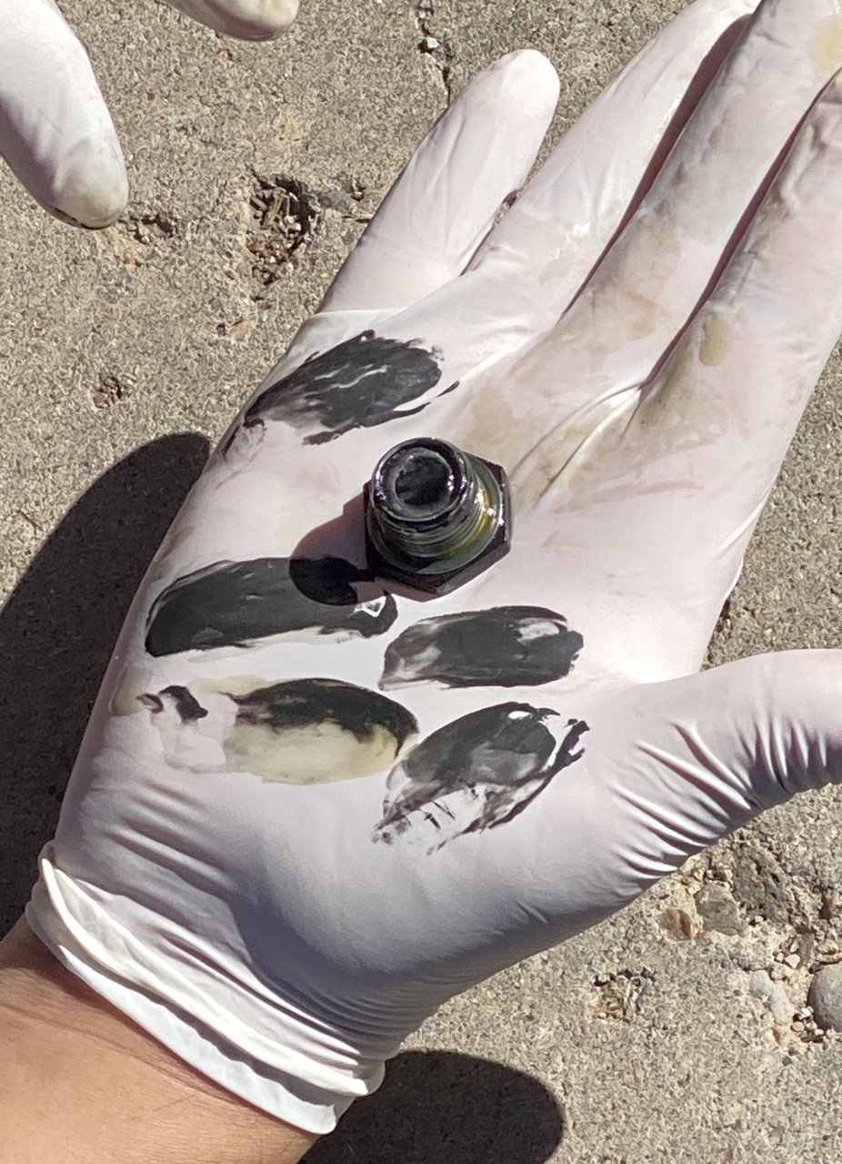

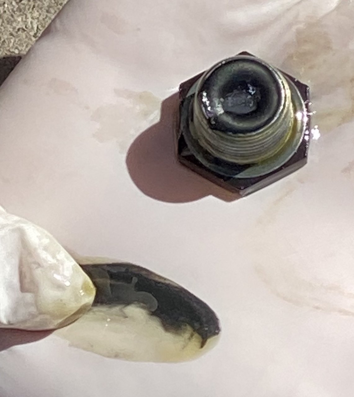

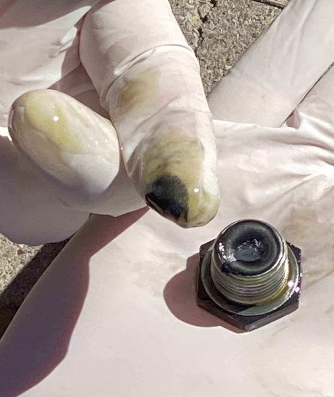

    *3 Pics below from the rear diff. Front diff and Transfer case oil was not bad at all compared to rear diff.
    1st gear oil change was done after only about 250 miles (Free at the shop) (around 36,719 miles on the truck 10/28/20).
    2nd gear oil change done after around 4896 miles since the 1st oil change. (Around 41615 miles on the truck currently 9/27/20)

    Rear diff turns 100% of the time while driving, front diff turn 0% of the time while driving unless 4wd is engaged. That is your difference.
