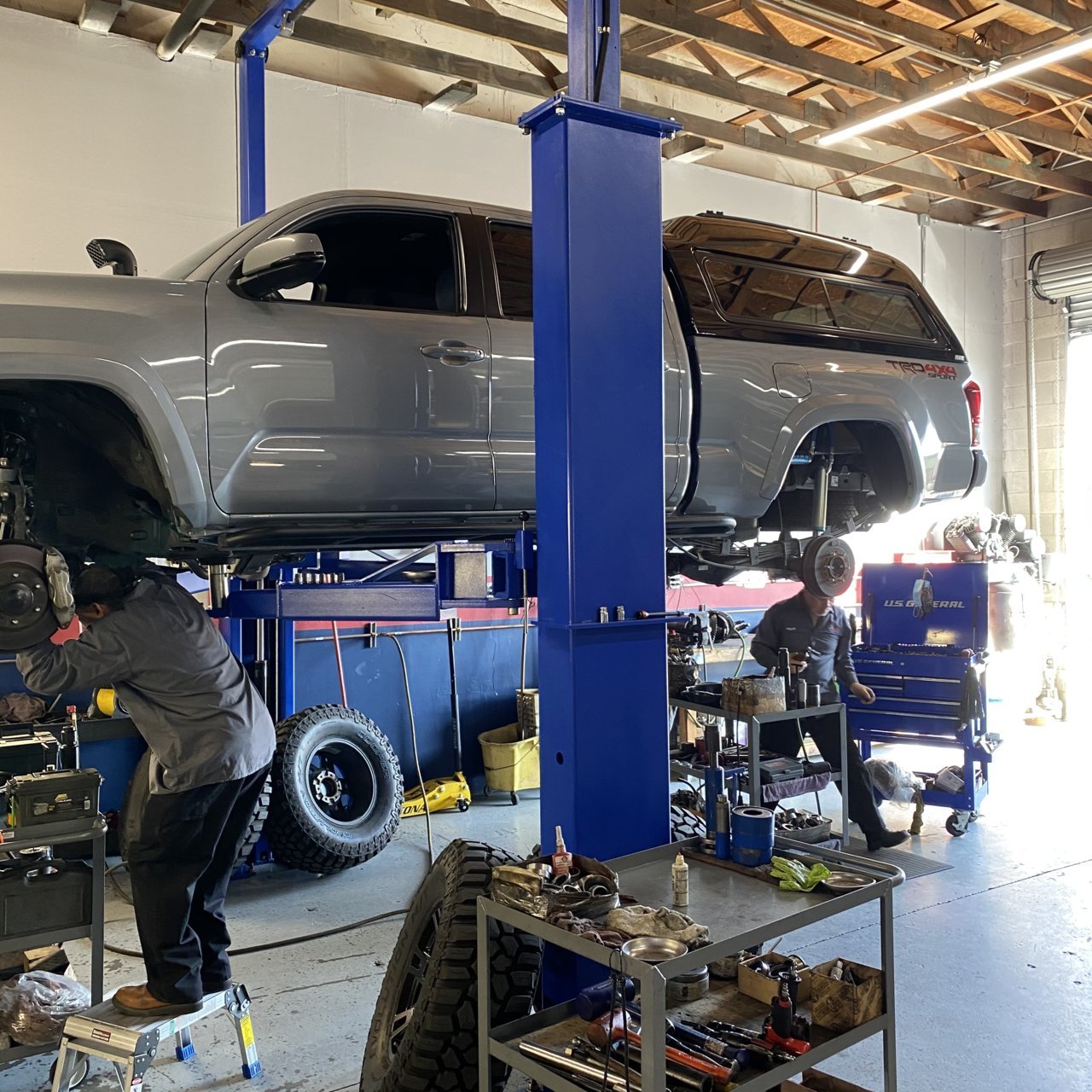

    Getting my re-gear done as we speak. B8A60601-687D-40A9-AB05-74D58EA8E8F7.jpg

    Nice! Who did them and how did they turn out? What size tires are you running?

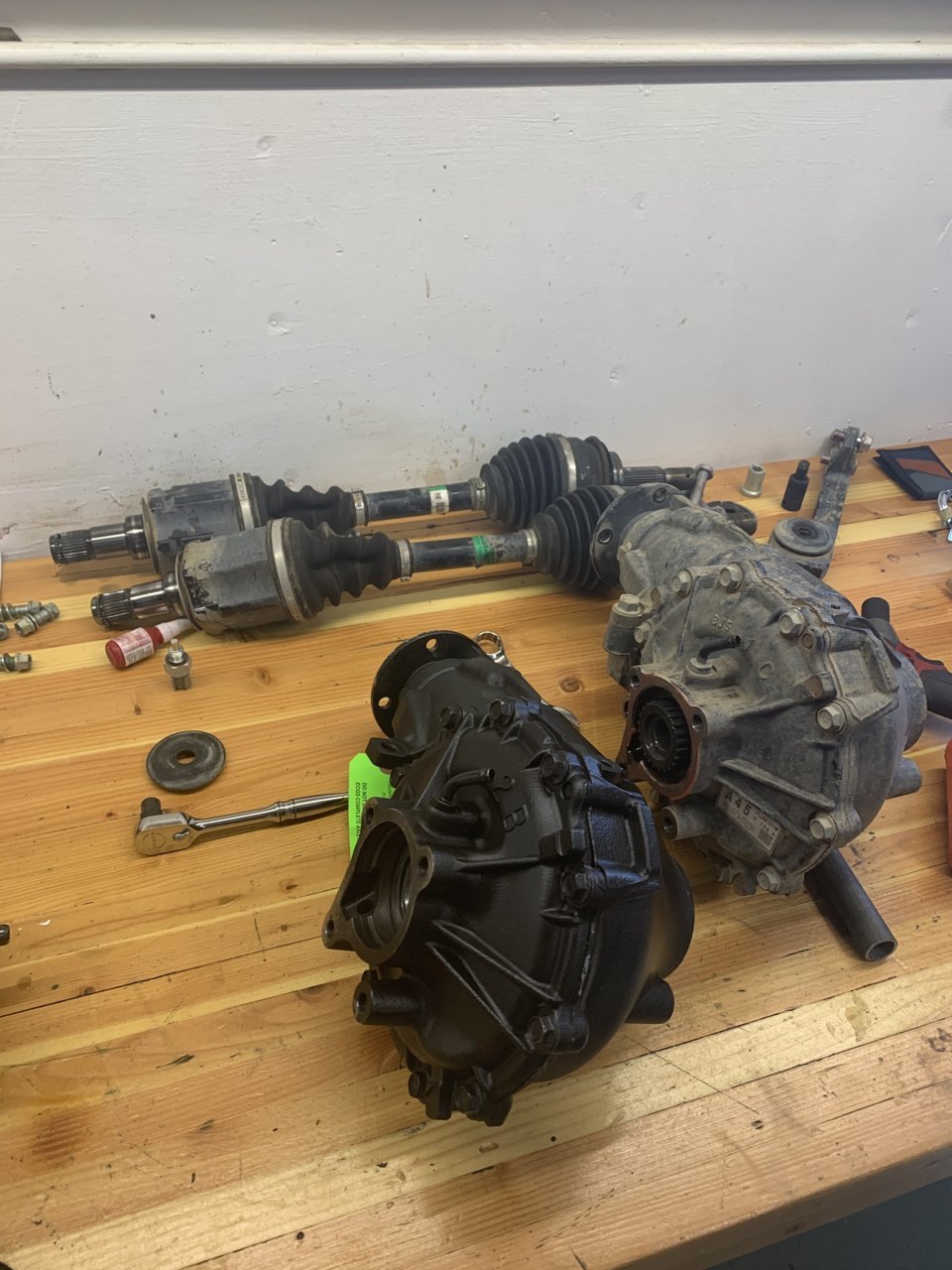

    Welp, gears are in! Took us about 6-7 hours to swap the pre-assembled third/clamshell from ECGS. Installation was relatively smooth with only one brain fart that cost us about an hour to resolve. The rear is so easy it's pretty much cheating. The front is easy too, it just takes quite a bit longer while to get everything out of the way so you can pull the diff. We even finished in time to drop the cores off at UPS and go camp for the night.
    I'm about 300 miles into the break in and also just flashed OVTune 2.0 with the 5.29_33_THX_Premium tune. I'll be honest, the result of all of this is not super exciting. The truck just finally drives well. It hasn't magically turned into a race car, it just has an appropriate amount of low RPM torque and overall drives better than ever. Definitely worth the effort though and I can't wait to get this thing off road!
    Also - can anyone explain why ECGS doesn't pre-install the intermediate shaft on the ADD side of the front differential? We ended up having to crack open the clamshell to pop that out from the inside. Not a big deal, I just didn't understand why they don't include it. Maybe it changes depending on the year/model?

    They don't include it because you are expected to re use yours. I take a long skinny flat head screw driver and hammer to punch it out from the other side.

    Right but why? They include everything else. Seems like they just want to make sure you're paying attention :D

    Same reason they don't include the entire ADD tube, extra shipping weight and another piece that can possibly get damaged.

    Got them on there group buy thread installed at Premier Gears in Riverside. Super happy so far, still breaking them in so I haven’t put my foot into it yet. Running 35’s and glad I went with the 5:29’s.
