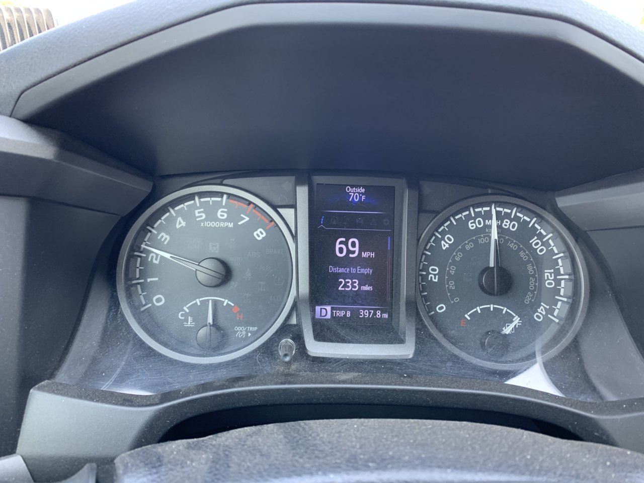

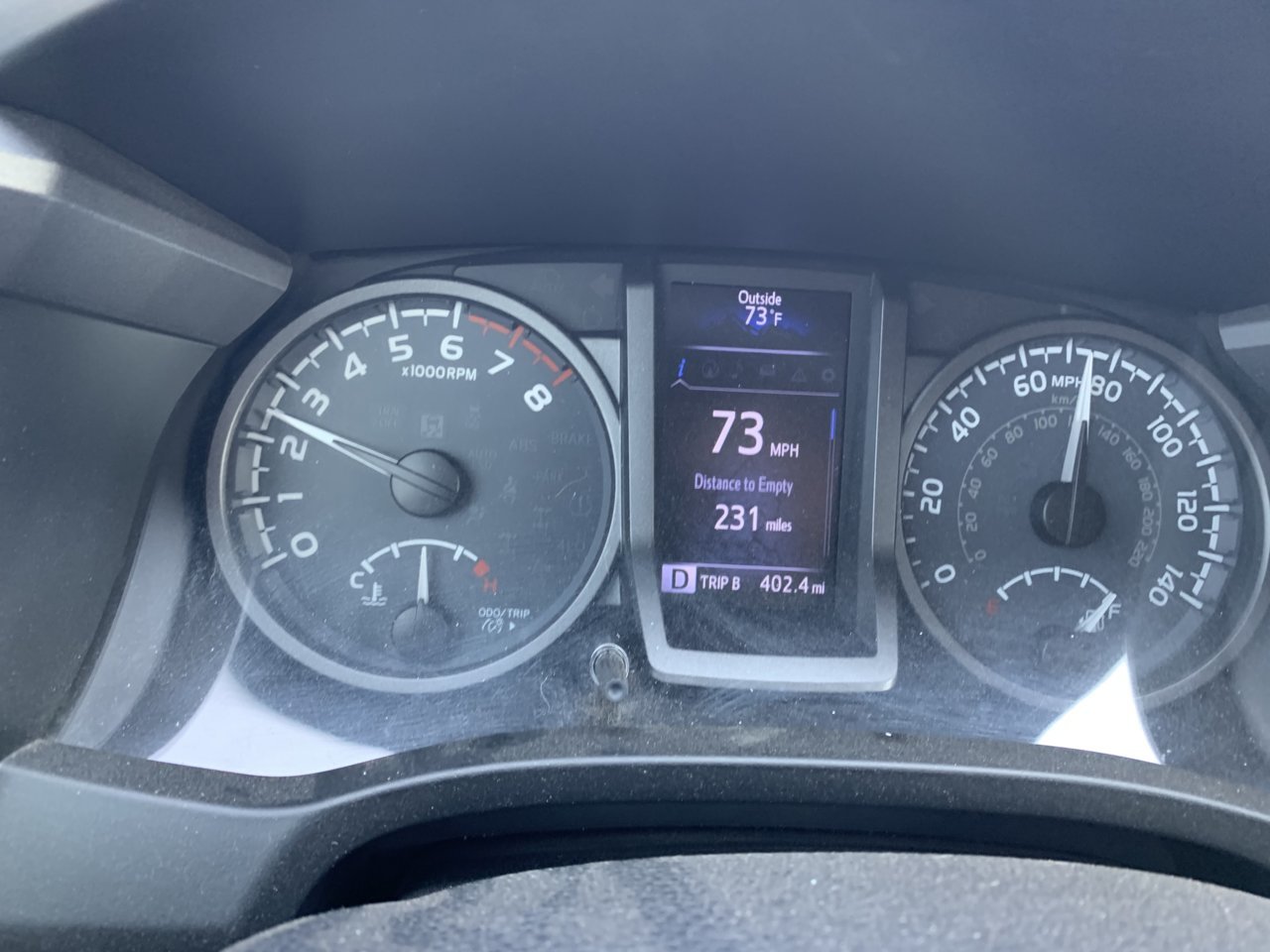

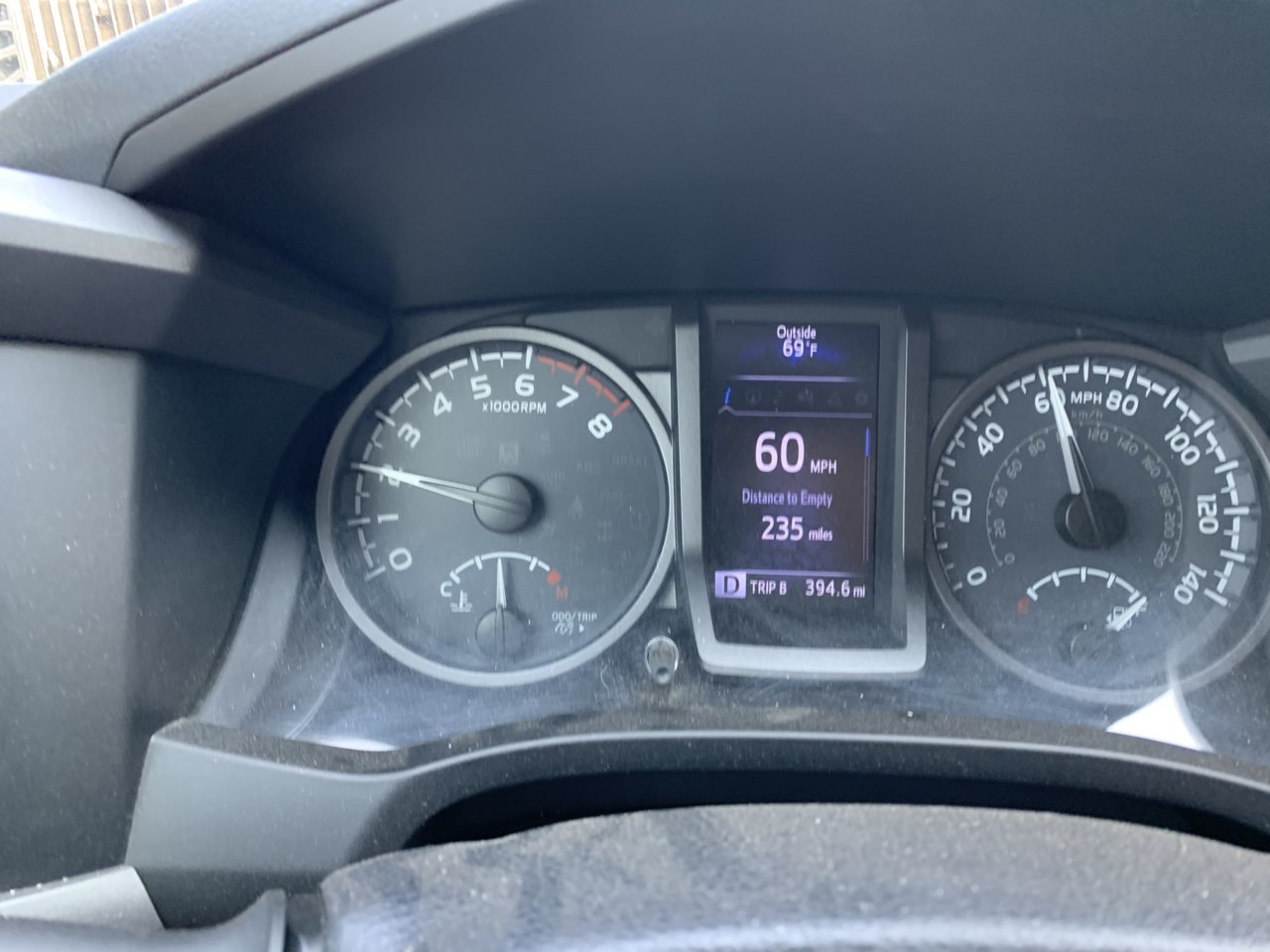

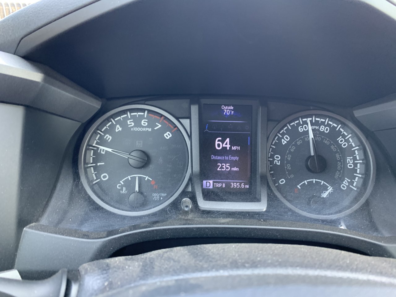

    I've got the same tires and took a bunch of pictures of my gauge cluster on my commute yesterday. Take my RPM readings with a grain of salt because it's pretty hard to discern actual RPMs based off the gauge. I've attached images of the key speeds though.
    I don't usually commute in my truck but I have twice this week for gear break-in miles. I'm averaging over 17 mpg on this tank, which is about 2 mpg better than I was getting before doing the gears. Granted, I'm driving like a granny, but staying out of 3rd gear on the hills seems to be helping a ton too. This truck really likes to cruise in the 60-64 mph indicated range which is fine for where I live.
