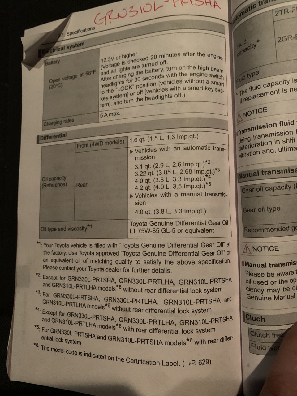

    Have my 2019 trd sport 4x4 automatic...no locker...doing my rear diff flush now & its fills with 3 qts...is this normal?! Everything I’ve read it says 4 qts

    Some relevant info in this thread...esp first post (see photo)
    https://www.tacomaworld.com/threads/rear-differential-fluid-level-how-much.544343/
    From a quick search and read I believe your diff is a 3 quart fill...but "thread wisdom" also seems safe in assuming "fill it til' it drips" as a safe protocol.

    I’m a dumbass...I misread the manual. It’s confusing at first but my simple mind figured it out eventually haha! 3.22 qt is what mine requires. Thank you for the response!

    Just like what was shared earlier, the white sticker on the driver door shows your model. Mine is GRN310L-PRTSHA.
