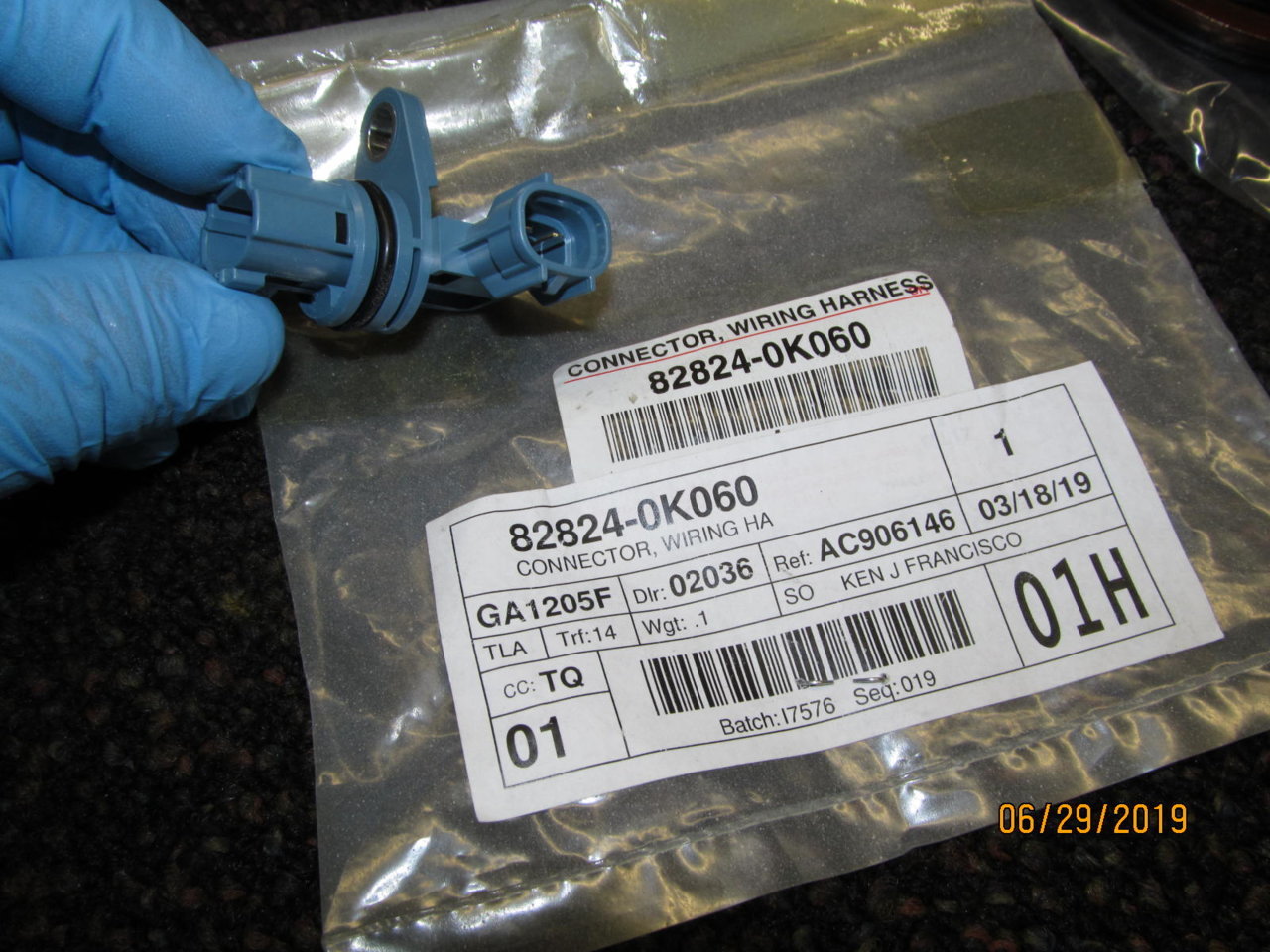

    Ordered my Nitro 5.29's a couple days ago. Thinking about doing the change myself, as I have done Toyota solid axle diffs before (old Yota's 80's-90's). New on this thread so any tips for me? I have all the tools needed to properly set them up. Thanks for the help!
  5. Nov 11, 2020 at 8:35 AM
    #2965
    Texoma
    Texoma IG: Triple C Chop Shop
    Feb 1, 2011
    #50374
    18,966
    Chris(Topher)
    Lago Vista, TX
    10 Taco 4x4
    A bunch a cool stickers, a bada ass MetalMiller Tx Longhorns grill emblem painted Hemi Orange, JBA long tube headers with o2 sims, Diff breather mod, Red LED interior lights, Fancy head unit that plays ipod n movies, Also DIY install factory stuff like, factory cruise control, factory intermittent wipers, OME nitro struts with 886x springs and toy tec top plate, JBA high caster UCA's for better alignmnet and dey beefier too, Old Man Emu Dakar leaf springs in da rear with the gear, U bolt flipper, Ivan Stewart TRD rims with 33" K Bro 2's, some bad ass weather tech floor liners so I don't muck up my interior, an ATO shackle flipper for mo travel in da rear wit the gear, also super shiny Fox 2.0 shocks back there too, all sorts of steal armor for bouncing off of the rocks like demello sliders, AP front skid, trans skid, n transfer skid, demello gas tank skid, and a tough as nails ARB bumper with warn 8k winch, I'm sure there's more
    The blue elocker connector has to be destroyed in order to remove it, get yourself another, theyre only about $20.
    A good start on the 8.75 pinion depth shim is 0.082, from there it should be just splitting hairs.
    If you're using a solid pinion spacer, you'll have to put the pinion shim under the race, but if you use a crush sleeve, its better under the bearing.
    For the front 8" clam, a good start for pinion depth is 0.073, usually the factory shim is 0.0745 and is just a bit too deep.
    The factory carrier shims aren't enough to get good pre load and backlash for a paint check and result in being way too loose. I like to add about 0.004 to both sides to start.
    Feel free to PM me and we can exchange contact info if you get stuck anywhere.

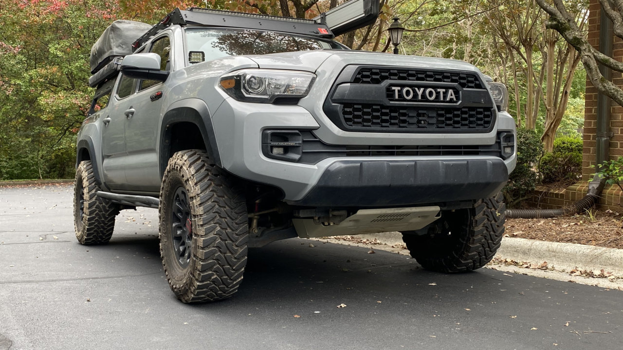

    Anyone else here could back me up that going to 5.29's would limit your top speed? @Hooligans perhaps be interested to know.
    I know various factors could affect top speed such as temperature, fuel type, mods, airbox, air to fuel ratio, wheel size, tire size, truck make and model, lift if any, armor or gross weight, aerodynamics, etc.
    All I know for certain is that for my mostly stock truck with 5.29 gears from ECGS, and 33s on 17" wheels, I cannot go faster than 79mph. I am mechanically limited by the gears in my diff. I could cruise at 78mph at 2900 rpms on 6th/auto.
    Some people here say they could go 90 (unbelievable), and some say 75 to 80. Regardless of what the real figure is, re-gearing will never give you stock speed. I clearly remember taking my truck to 120mph on stock once on my trip to Mammoth with friends and gear in the bed.
  15. Nov 12, 2020 at 9:00 PM

    My truck topped out at a recent trip around 92 mph (5.29s and 35s). This is the same speed my truck governed out on stock tires.

    So what could be wrong with mine then? How could there be a delta of +12mph or more. My truck is exactly the same as it was in this picture today. If anything, i only reduced weight, no armor, no stock bed cover, no ground effects. Only weight on truck is unsprung weight from 285s, wheels. 5.29s from ECGs.
