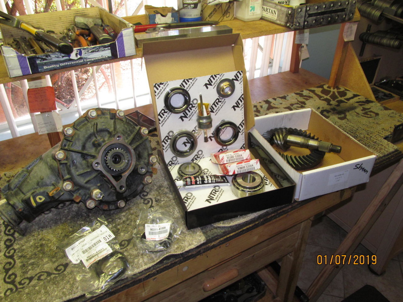

    Regarding the other comment about anybody that has ever gone from 488 to 529.....me me me. I did that on my 01 Taco with auto and 35" tires. Put the 488s in and it was nice to get back my acceleration and stuff. Was ok on the highway. But quickly realized that I should have gone full bore and did 529.....so I did. Love the 529's with my .71 OD.

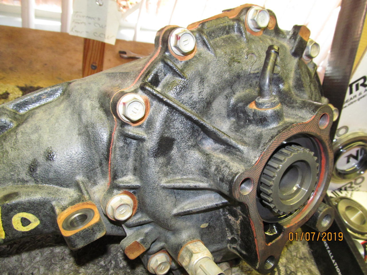

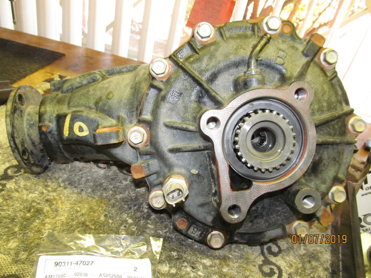

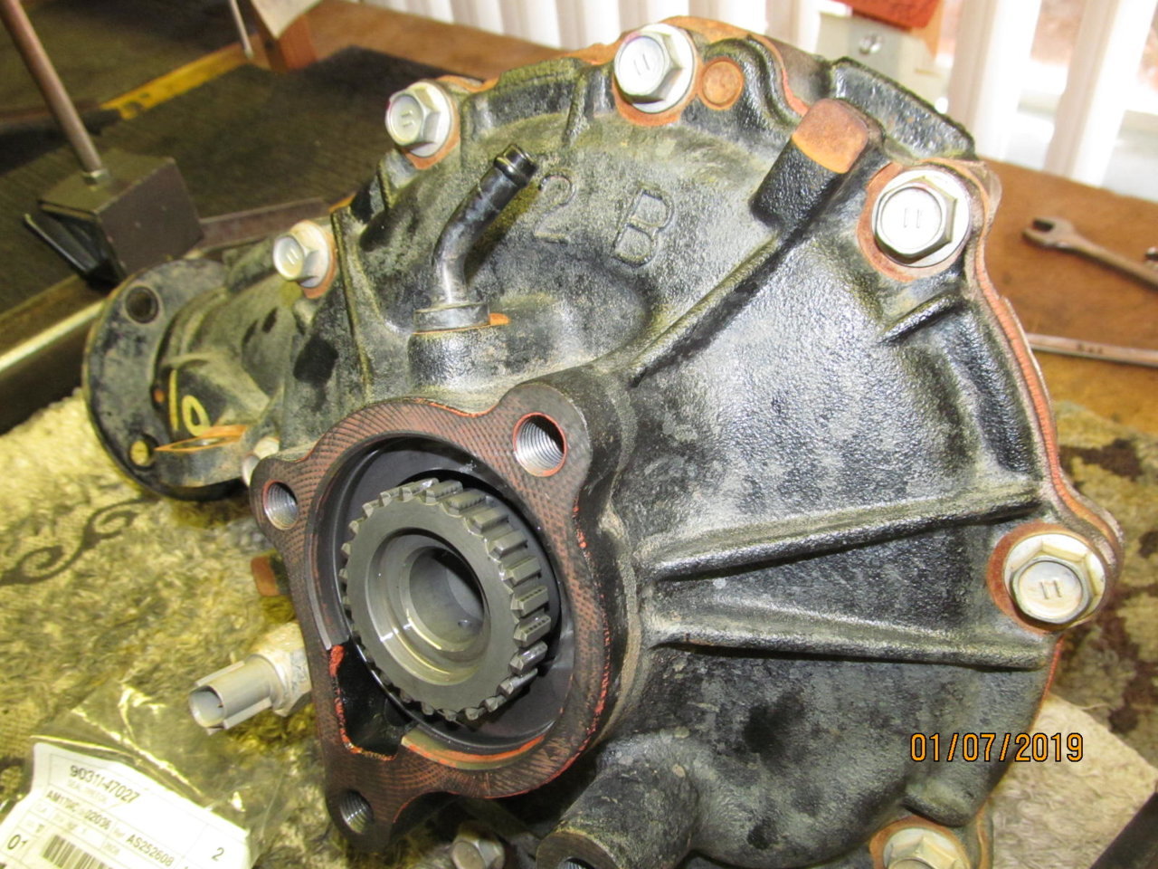

    So Shawn reinstalled the 8.75" rear 3rd and likes it alot. Remember...he had factory 430 gears and upped it to 5.29....that's a 23% improvement. ;)

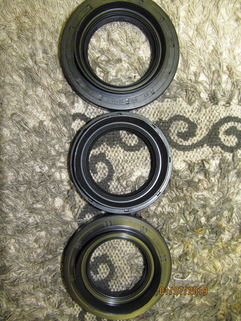

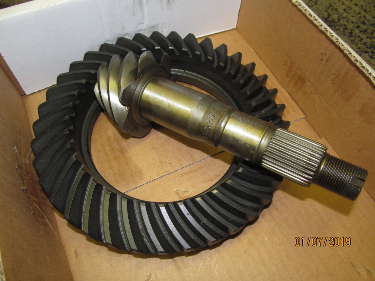

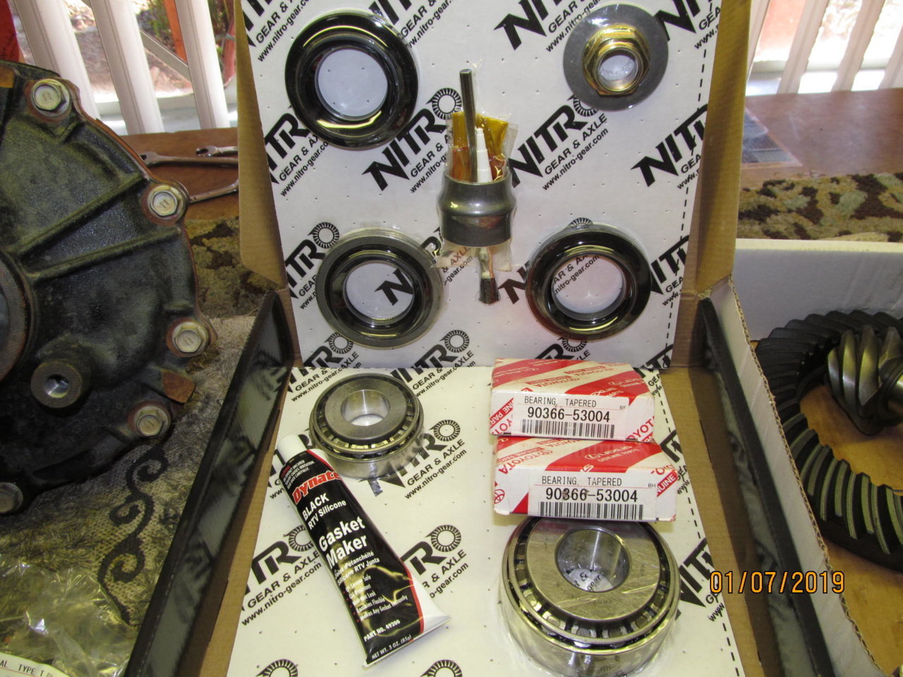

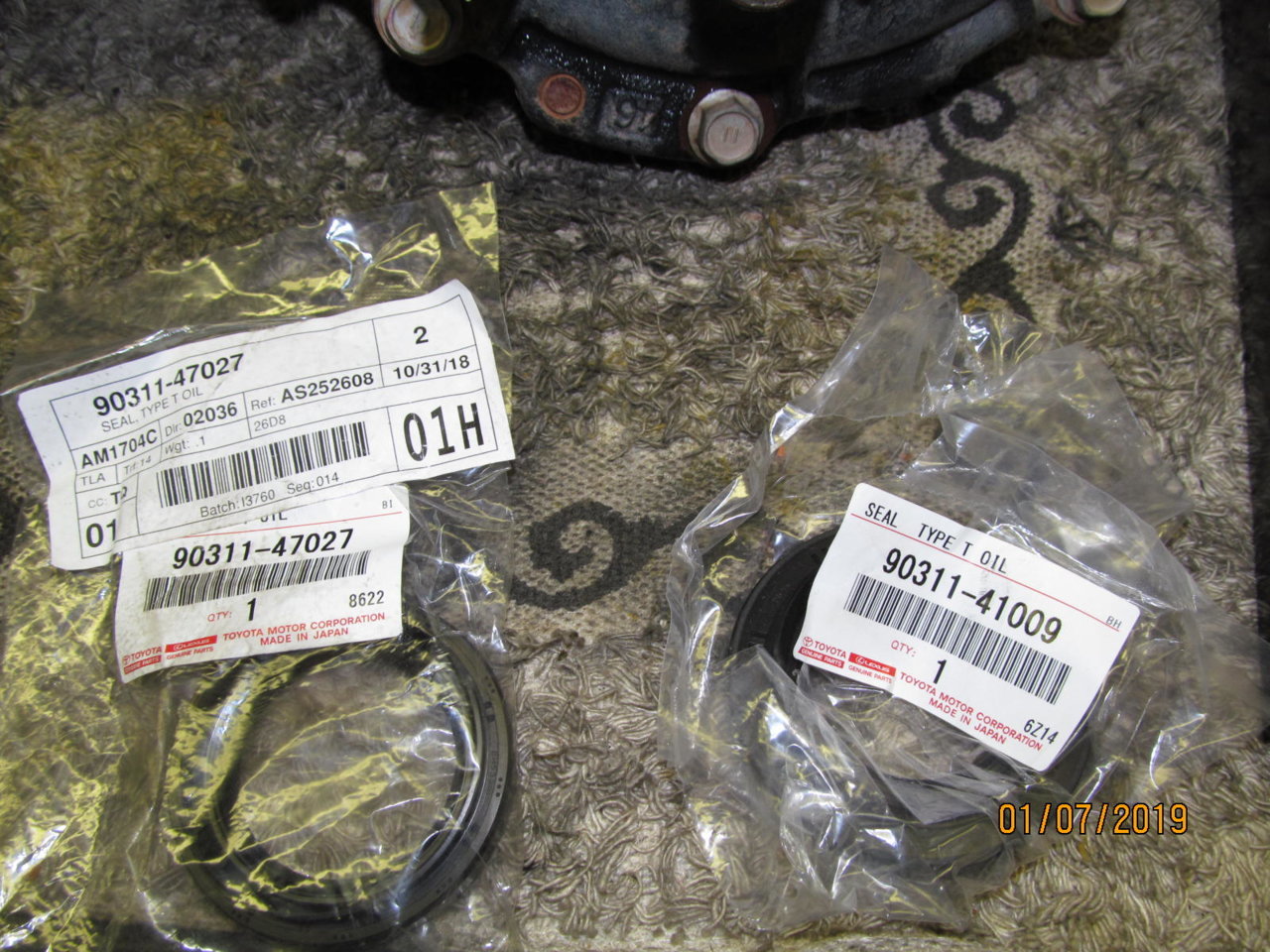

    So Shawn just dropped off the front 8" clam to me. 529 Nitro gears and a Nitro master kit. He likes oem seals and so do I so the generic ones get cast aside and oem NOK seals to replace them.
    Hard to beat NOK oem seals for this application...the left one is for the cv stub. The right is the pinion seal.
    Nitro 529....cryo treated also at http://cryogenicsinternational.com even the cosmoline is cryo treated.

    The top is a generic from the kit....fits the end of the passenger side tube. OEM will be used instead.
    The middle one is generic. It's the CV stub axle seal. OEM will be used instead.

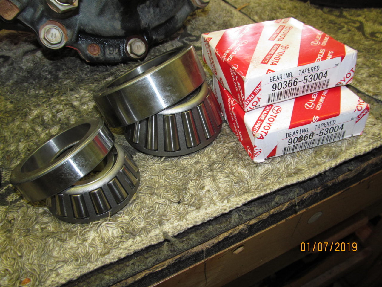

    The bottom one is a NAK pinion seal. Appears to be of equal quality with OEM....but OEM will be used instead.
    KOYO bearings rule.
