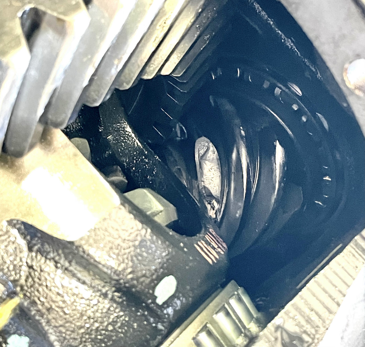

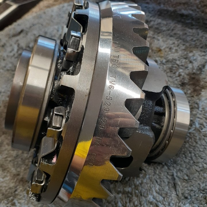

    What's the name of the shop? I had a customer that came from Hawaii with about the same issue. When I go to open his diffs up, the pinion crush sleeve, wasn't crushed.

    What fluid where you using?
    I have my doubts about the order of things. My guess is the bearing shit the bed first then the gears "blew out".
    Freak incident? That is exactly what a warranty is for. They are full of pus. Stand up to them. And contact Nitro.

    Texoma
    Texoma IG: Triple C Chop Shop
    Feb 1, 2011
    #50374
    18,959
    Chris(Topher)
    Lago Vista, TX
    10 Taco 4x4
    A bunch a cool stickers, a bada ass MetalMiller Tx Longhorns grill emblem painted Hemi Orange, JBA long tube headers with o2 sims, Diff breather mod, Red LED interior lights, Fancy head unit that plays ipod n movies, Also DIY install factory stuff like, factory cruise control, factory intermittent wipers, OME nitro struts with 886x springs and toy tec top plate, JBA high caster UCA's for better alignmnet and dey beefier too, Old Man Emu Dakar leaf springs in da rear with the gear, U bolt flipper, Ivan Stewart TRD rims with 33" K Bro 2's, some bad ass weather tech floor liners so I don't muck up my interior, an ATO shackle flipper for mo travel in da rear wit the gear, also super shiny Fox 2.0 shocks back there too, all sorts of steal armor for bouncing off of the rocks like demello sliders, AP front skid, trans skid, n transfer skid, demello gas tank skid, and a tough as nails ARB bumper with warn 8k winch, I'm sure there's more
    Here's what I encountered from the Hawaii guy.
    https://www.instagram.com/p/B3N1Ji7gHNj/?igshid=1lrxt74aauhc9

    They didn't crush the pinion sleeve, which left the pinion loose
