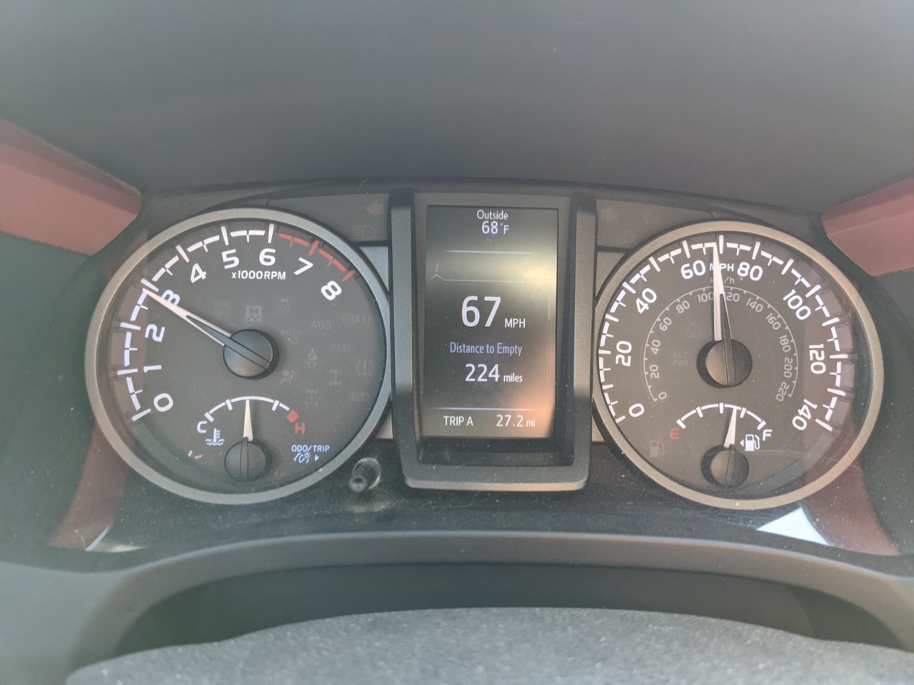

    Got my truck back from the shop. 5.29s in my 2016 mt. With 285/75/16s, my speedo is almost bang on.
    Interstate driving should be interesting lol. But it drives great! No howl.
    Went with revolution gears
    pic from 6th gear
    Edit : the smarter people here corrected me and my speedo did not change when I regeared

    That's 6th gear?
    I have 4.88's I'd be doing over 80 at those RPMs.

    Yessir. That's in 6th. I'll do another run today to double check.
    The gears are a little shorter than I had hoped. But, I weighed in at about 6300lbs loaded, so I needed the torque
    Going 80 isn't a priority when I'm this heavy

    The gears have no effect on the speedo because the speed is measured at the wheel speed sensors. So you speedo will be the exact same off as it was before the gears

    100% true. The speed is calculated at the ABS sensors. Tire size is the only thing that will make you speedo off.

    His tire size is taller

    True that but he said his tire size and gears had no difference. Anyway his speedo is off slightly
