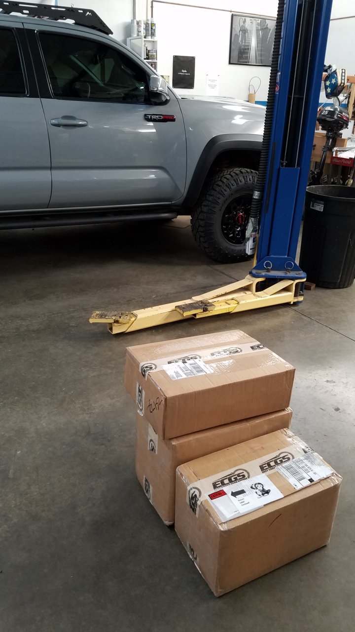

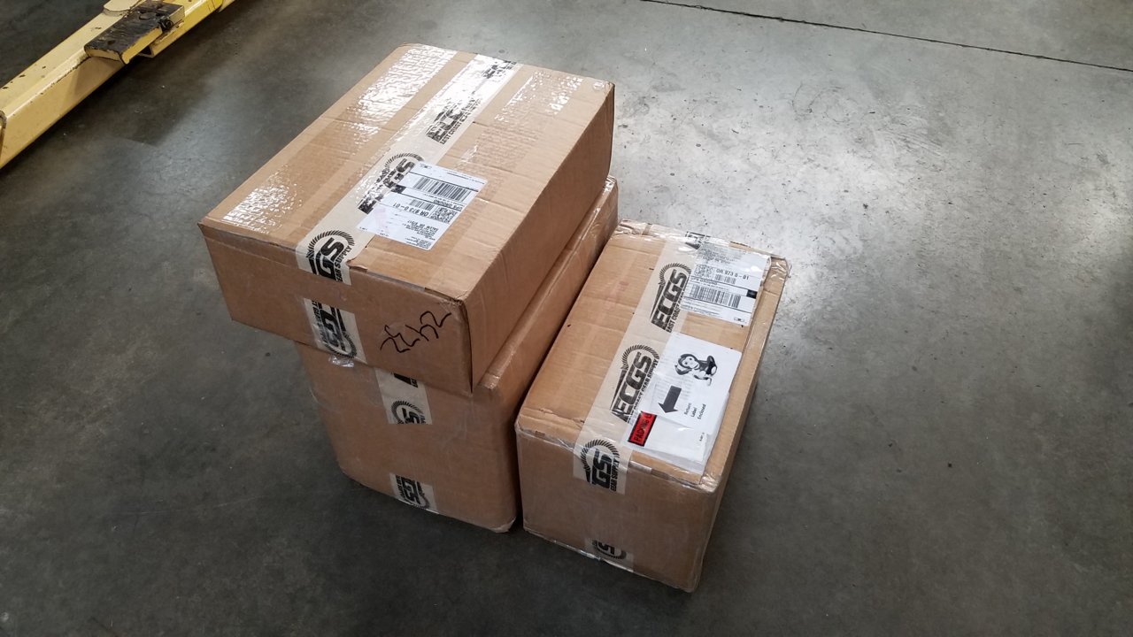

    Burmapeak
    Burmapeak Well-Known Member
    Dec 31, 2017
    #239912
    704
    Oregon
    2017 Tacoma TRD PRO Cement
    Well looky here! Now I don't know if I want to tackle one end Friday night and the other Saturday morning or do both on Saturday. So far been very pleased with the communication and service from ECGS. Hopefully the whole install, return, and core refund will go smooth.ecgs2.jpg ECGS1.jpg
