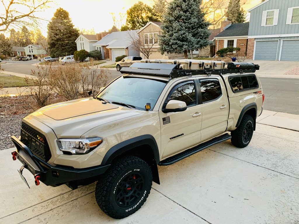

    265/70/17 is one size larger than stock tires size. Not a lot, 1” greater in diameter, still we thrive on details on this forum.

    An man who is not threatened by the big tire crowd deserves a little respect here. Kudos.

    Those are things of beauty :cool:

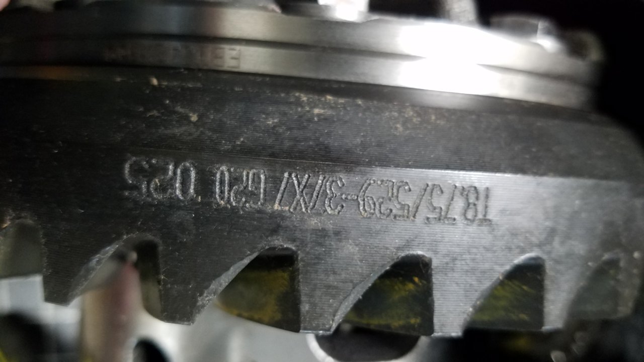

    I placed my order with ECGS 4/14/21 my salesman said they are having a hard time getting Yukons in stock. He said 2-3 weeks maybe. They arrived yesterday 5/13/21. Here is a picture of the number on the gear. Not sure if that helps. Sorry its upside down. Note:mine is a Trd Pro but Paul at ECGS said it's the same as OffRoad.20210513_160028.jpg
